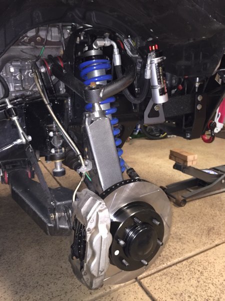

    Dude. Who assembled all of that together?! That looks like a transformer that was assembled incorrectly! :eek:

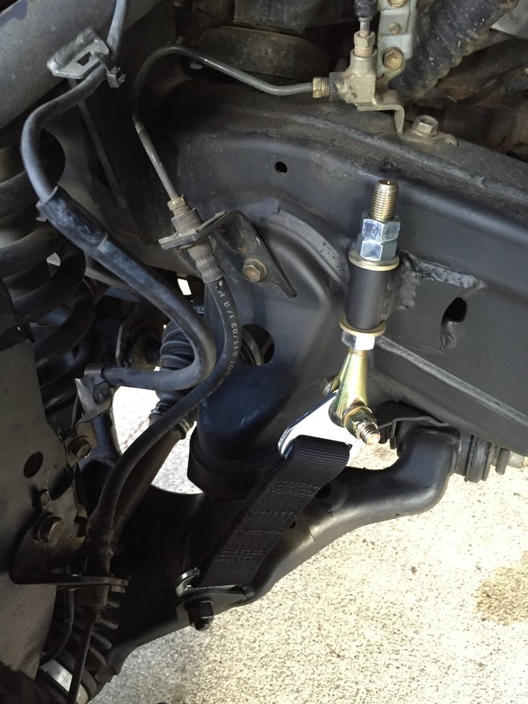

    In all seriousness they are an absolute neccessity now on my +2 kit, the cv's completely lock up a couple inches before the kit is fully drooped out. I could destroy a cv if I mall'd too hard without them.

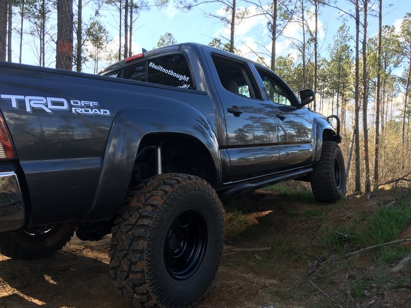

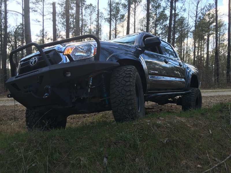

    Mid travel?
