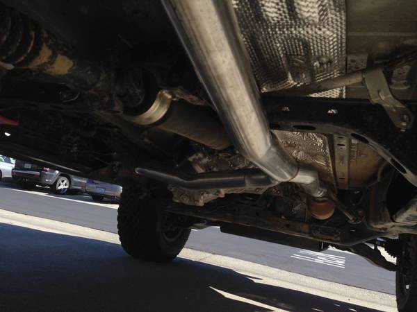

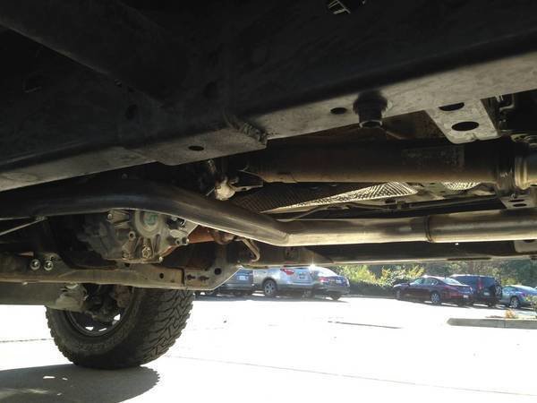

    I'm installing a Pelfrey T-case skid with exhaust re-route. Anyone have experience with their re-route skid? Just looking for general info and feedback is all. Thanks!

    What kind of info are you looking for? Lots of people have it, including myself.

    Does yours bang the skid at all? That seems like the easiest/cheapest reroute option.

    No, but I do have to make sure to clean it out from time to time (which I assume is normal for everyone with that skid). After 4 days in Baja I started to get a little rattle only in reverse. Come to find out I had filled that skid with sand and rocks. Cleaned it out and rattle was gone. I didn't have to take the skid off to clean it, I just assumed the rattle was going to be harder to find. luckily, it wasn't! :thumbsup:

    Wow, nice sandbox!
