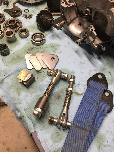

    Picked up some Clevises,mounts,straps and some tabs. So where is everybody mounting there straps? I see some people are mounting in the front of the arm and some in the rear. What's better ? image.jpg

    Utah
    The Plague....
    6 inch Douche Bag lift...what else do I need?
    I don't think it matters as long as they don't interfere or rub on things at ride height (or compressed).

    VolcomTacoma
    VolcomTacoma Well-Known Member
    May 25, 2011
    #57205
    20,617
    Jeff
    NorCal
    2015 TRD Sport 4x4 6 Speed Supercharged
    Front- Camburg 4x4 Long Travel 2.5" King Coilovers 2.5" King Triple Bypasses Wheelers Superbumps Rear- DMZ SUA 16" 3.0 King Triple Bypasses 3" 2.0 Fox bumps Wheels and Tires- 295/75/16 Toyo ATII XTREME SCS SR8 Dark Matte Bronze 16" Lighting- (2) 30" Combo light bars (4) Iggycorp diffused pods Tepui Ayer TRD Supercharger URD Mark III 3" Exhaust URD 4x4 Y Pipe URD CAI URD 2.85 Stealth Pulley Hurst Core Shifter with Hurst T URD Stage 3 clutch URD Lightweight flywheel URD Throw out bearing upgrade AEM Wideband AFR Gauge Speedhut Boost Gauge Craven Speed Flex Pod mount Weathertech Floor Liners BAMF Sliders Ultragauge sPod SE ARB CKMTA12 Hella Supertone horns Relentless Tailgate Reinforcement
    I think it really just depends on your setup. if you've got bypasses and bypass mounts some people mount there. Really just depends where the most room is so the strap can move freely
    Edit- @Glueman beat me to it :D
    LTDSC, Glueman and Forcedtravel like this.

    Right on I was thinking about welding the tabs straight to the bump pad on the lower arms just don't know if that will be strong enough. I was going to double shear them as well

    Supermoto
    Supermoto Well-Known Member
    Feb 7, 2012
    #72373
    2,589
    Landon
    Fallbrook
    All that matters is that they clear and stop the arm where you want it to. So mount it where ever it fits. There is not really a wrong way unless it gets caught up in the shock or arm.

    LTDSC
    LTDSC 32oz of fun
    Apr 7, 2013
    #101544
    13,385
    Sam
    NorCal
    Tapatalk isnt letting me post anything but i tried posting my photo of my LCA and strap mount exactly where you talk about it. Just make sure its in far enough to clear the caliper and brake lines at full lock during travel.
