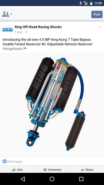

    6 inch Douche Bag lift...what else do I need?

    April fools?

    Could be? It does seem excessive but it is King

    I feel like they'd make that custom for someone but not announce it as a product
