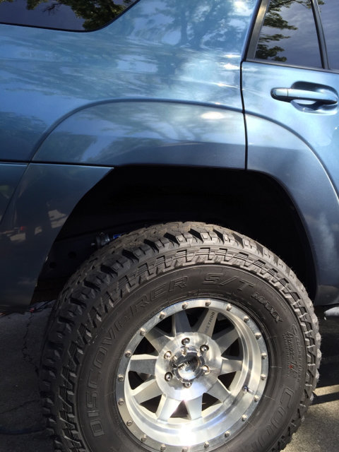

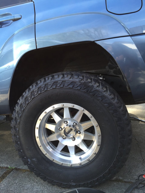

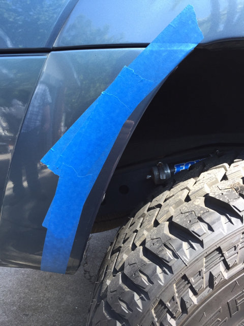

    With the links and lift it pushes the wheel back into the wheel well like the Tacoma. So you really only need to trim the rear bumper part of the flare. Here's what I did.
    I taped it off, used the dremel with the cutting disk then cleaned up the edges with a knife. From there I used some 120grit sandpaper on a small sanding block to smooth any waves out from cutting.

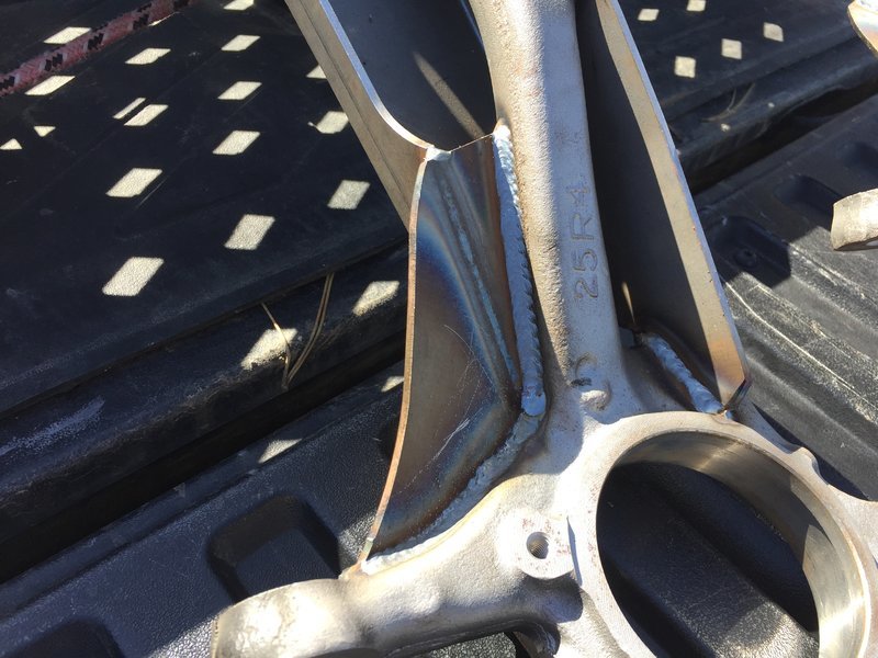

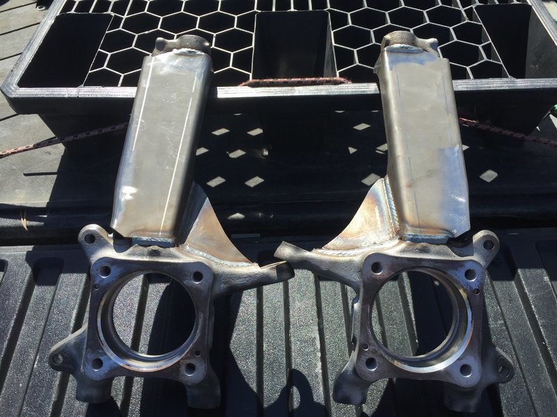

    These are the TC W/swaybar option
    I don't run a swaybar, but with this kit you get an extra gusset and they are a bit beefierimage.jpgimage.jpg

    Those are the same ones I run. They seem a little better than the gen 1 gussets because of that additional brackng they add. Plus, they are solid instead of dimpled and all weird looking like Gen 1 does. :thumbsup:
