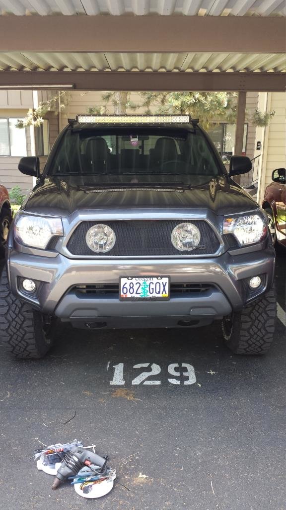

    Curious, why did you switch to the Hella's versus the light bar?
    Are the Hella's brighter with the HID's? These are actually the same options I'm between for my front end lighting.

    The bar I had was to small, in both light output and size. I didn't like the look and my headlights were drowning out the bar.
    I like the look now much better and with the hid retrofit I think they are much brighter

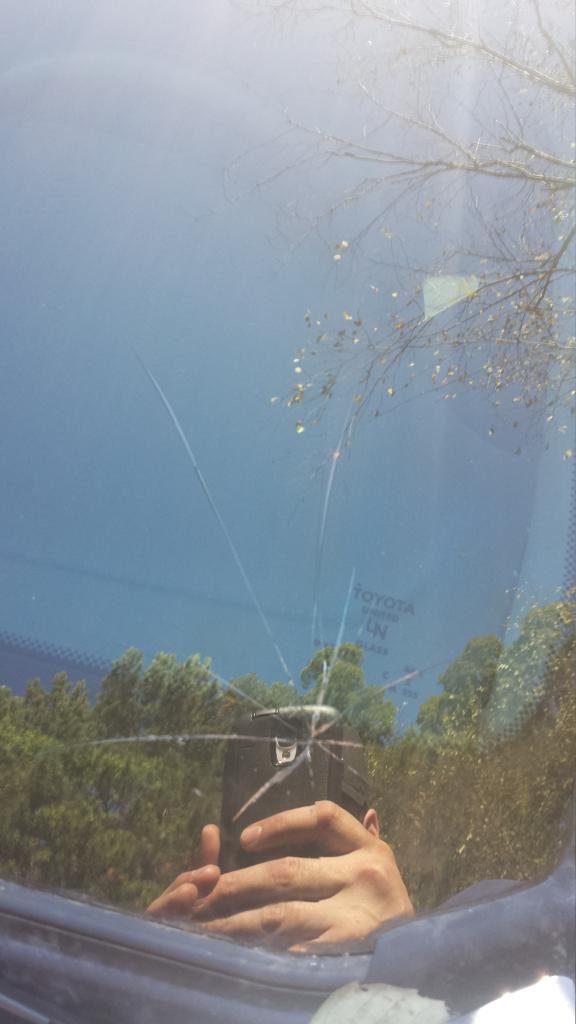

    The got slammed by a giant ass rock mod

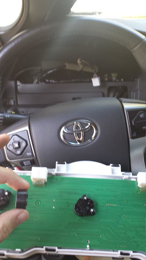

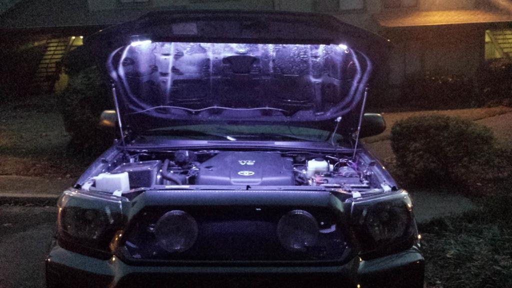

    Hood light kit I made
    Removed seatbelt/door chime buzzer

    Do you have a step by step on how you did it on the buzzer?

    Travis gotta show me how you did that light set up under the hood. I need to do that

    Josh, next meet up I will walk you through.very easy!

    To remove seatbelt chime speaker:
    Remove quarter panel by drivers left foot.
    Remove lower dash bolt
    Pull out "change dish" by driver right knee
    Pull back cover hiding bolt
    Remove bolt
    Pull the lower dash out a bit
    Pop the two push button plastic pieces above the gauge cluster and remove
    Pull out cluster cover
    Remove, three I think, bolts holding cluster in
    Pull cluster out some and disconnect the two wire connections
    Remove gauge cluster
    Flip cluster over and remove three screws adding the outside holding the back on
    Separate the cluster
    Use pliers to remove circle speaker down in my post above
    Reassemble
    Enjoy the silence!
    Pm me with questions
