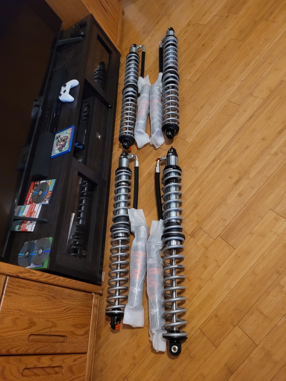

    Removed some stuff, added some stuff.
    You mean the average joe doesn’t buy two sets so they can send one out for rebuild and slap the others on to keep going?! Buy twice, cry continuously because race truck.

    Unless your daily is also your race truck.
    In all seriousness, I’ve been going back and forth for a while and I know what I want, I’ve done the research and got answers to questions from those with experience in both and that’s honestly what you need to do. It’s more about what you want and if you’re okay with the negatives of that option. Each option has its negatives and positives, you have to decide what you are comfortable with. Start with mid travel, try it out and if you feel you need more, check out dirtkings LT kit, it’s designed to work with both LT COs and stock replacements. So those $2,500 fox with dcgs you purchased for the mid travel will still work and you don’t have to drop another $2k on new shocks until you’re ready. And if LT is for you, do the frame shit first. Double shear, strength plates, box the rear end, spindle gussets…then go to the LT spec COs. That’s my plan anyway.
