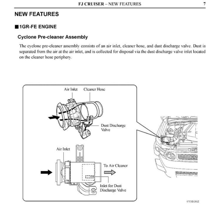

    @Acerwin, @ChandlerDOOM
    I had forgotten about this little part until someone sent me a PM asking about it.
    I bought a Land Cruiser / FJ Cruiser pre cleaner to mount in between the snorkel and the factory intake on my old 4Runner.
    Notice the small round bulb on the bottom right of the pre cleaner. That is the sediment/dust discharge valve. The area below it would always be a bit dirty so I knew it was working to some degree by self discharging. It was very easy to retrofit into the 4Runner and I don't see reason why it would be difficult for the Tacoma either. If you are genuinely concerned with dust and water ingress it might be worth consideration.
    I'll be ordering another one for my truck now that I'm changing the fenders around for the added security.

    That's awesome! I may do the same
