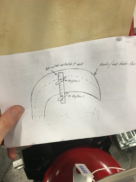

    One or two things modded... Check out the build thread
    Short answer, no.
    Long answer, put the ruler next to your "35's" and then next to 34s so you can realize how much you have to mutilate your truck for an extra 1/4" of clearance.

    Toyota Tundra
    Fuck. What in the hell is the ruler method?

    Reread my post. :p

    Exactly but it doesn't have to be a ruler, but simply a measurement between the 2 holes. I used a painters stick since I had a bunch of them, drilled two holes 2" apart

    That's exactly what I did.
