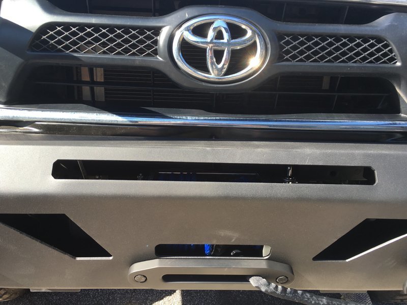

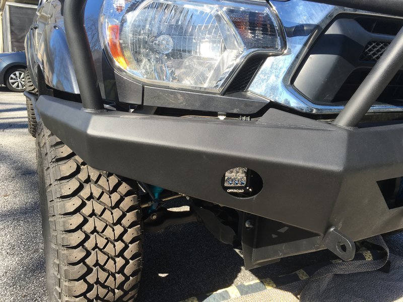

    Shits pissed me off...can't get it lined up just right

    Loosen your nuts for the bumper, put a d ring on and hi lift from the d ring, it will lift the bumper up to where you want to tighten the nuts. Cause where the nuts are sitting in this picture the bumper is at the lowest setting

    What am I missing? One side higher than the other?

    The bumper is sitting low

    Looks like there is a lot more room on the outside than in the middle though

    After he makes an adjustment it should sit level with the grille, at least it should

    One side is higher than the other and it seems to be lower than most bumpers

    Do I need to unloosen both sides or just one at a time?

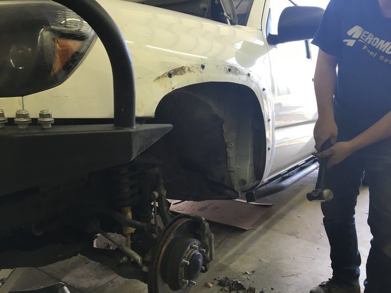

    Itd be easier to tell if you got pictures at the same angle, lol.
    Like this angle

    Both so your not stressing one side, just raise one side tighten, and do the same for the other and it should be good to go. Hi lift makes easy work of it, a friend could pull up the bumper too but hi lift is easy

    Ok I got it good enough for me now. I'm pleased with it now.

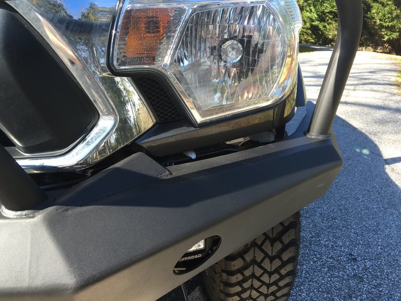

    Pictures don't really help but it looks a 100% times better now. Now I just need to figure out how to wire my fog lights up

    Looks better, for foglights you can slice into your existing harness or buy a harness extension and use that to slice so you don't have to cut up your factory harness

    I know a couple of guys that have his bumpers and theirs is off too. Kinda why I didn't get his 1st gen bumper not to mention I got mine cheaper shipped from Cali than his bumper alone....
