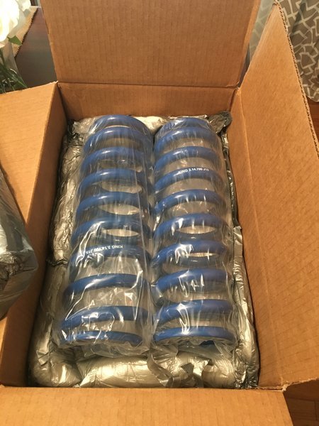

    Excited as fawk to get these installed
    NateMob likes this.

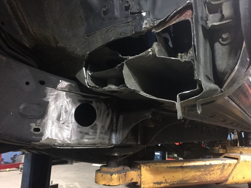

    Anyone got any good method to the messaging pinch welds?
    TAZ2014Taco likes this.

  8. Feb 10, 2016 at 5:22 PM
    #3388
    TAZ2014Taco
    TAZ2014Taco Well-Known Member
    Oct 26, 2014
    #141109
    2,266
    Florida
    2019 Tacoma 3.5 SR5
    Any pics? I have to do mine too and a regular decent size hammer isn't doing anything :(
  9. Feb 10, 2016 at 5:22 PM
    #3389
    G.T.
    Jul 14, 2010
    #40169
    19,788
    G.T.
    CONUS
    Remove the wheel.
    Cut the pinch weld every three or four inches.
    Smash them flat.
  10. Feb 10, 2016 at 5:26 PM
    #3390
    TAZ2014Taco
    Oct 26, 2014
    #141109
    2,266
    Florida
    2019 Tacoma 3.5 SR5
    Angle grinder with a cutting wheel?
  11. Feb 10, 2016 at 5:28 PM
    #3391
    Evenflow
    Evenflow Well-Known Member
    Jul 15, 2013
    #108344
    5,766
    Jason
    San Diego, CA
    06' DCSB 4x4
    Yes
    If you use a small 3 lb or 5lb sledge it takes 5 mins...
  12. Feb 10, 2016 at 5:29 PM
    #3392
    TAZ2014Taco
    Oct 26, 2014
    #141109
    2,266
    Florida
    2019 Tacoma 3.5 SR5
    I work at a hardware store I think I have one lol thanks much!

    #146896
    8,223
    What did you end up getting, 650 or 700#, and who did you get them from?
    Sorry, I'm trying to figure out which coils to put on my truck...
  14. Feb 10, 2016 at 5:34 PM
    #3394
    Acerwin
    Acerwin [OP] The unNORM NORM
    Nov 20, 2014
    #142732
    32,623
    Andrew
    South Carolina
    Toyota Tundra
    Sledge 10lbs

  15. Feb 10, 2016 at 5:35 PM
    #3395
    Sacrifice
    Sacrifice Motorcycle Goon
    Oct 8, 2013
    #114093
    15,962
    KS
    DCSB OR 4X4 LT
    Pelfreybilt Front Bumper,BAMF sliders, Airflow Snorkel,Mini D2S Retrofits, ADS Rear Shocks, Deaver U402 Leafsprings, 35s, AllPro +2LT
    This. I cut mine every 1.5 or so as well to aid. 4lb sledge. The pinch weld is really easy, the rest of the firewall is where your arm will get worn out.
    I just bought a sledge to keep in the truck today too

    Toyota Tundra
    700# no sense in buying them again later on. DSM cheapest place I found them
    Old School[QUOTED] likes this.
  17. Feb 10, 2016 at 5:36 PM
    #3397
    Blacktacoma23
    Blacktacoma23 If your tires don't rub you can fit bigger tires
    Jan 16, 2011
    #49366
    5,001
    2011 Mall Crawler
    6" BDS DB, 37", Dirt King, Total chaos UCA's w/ Heims, Fox c/o's, 4-banger fenders, 37" Nittos, 4.88 w/ rear ARB, AP Expos, 17x9 Method beadlocks, cab mount relocation, "Insain fab" tub, 5% tint, 10" Rockford Fosgates, Magnaflow 18" custom catback exhaust, AFE intake, Trail Gear bumper, Crown brake lines F/R
    Be sure to seal it somehow!
    I didn't and had rust start to build up :eek:
    Acerwin[QUOTED][OP] likes this.
  18. Feb 10, 2016 at 5:37 PM
    #3398
    Acerwin
    Nov 20, 2014
    #142732
    32,623
    Andrew
    South Carolina
    Toyota Tundra
    Pics of where I need to beat the fuck out of it? I'm doing all this Saturday I hope

  20. Feb 10, 2016 at 5:37 PM
    #3400
    Acerwin
    Nov 20, 2014
    #142732
    32,623
    Andrew
    South Carolina
    Toyota Tundra
    I'm thinking of using bedliner spray
