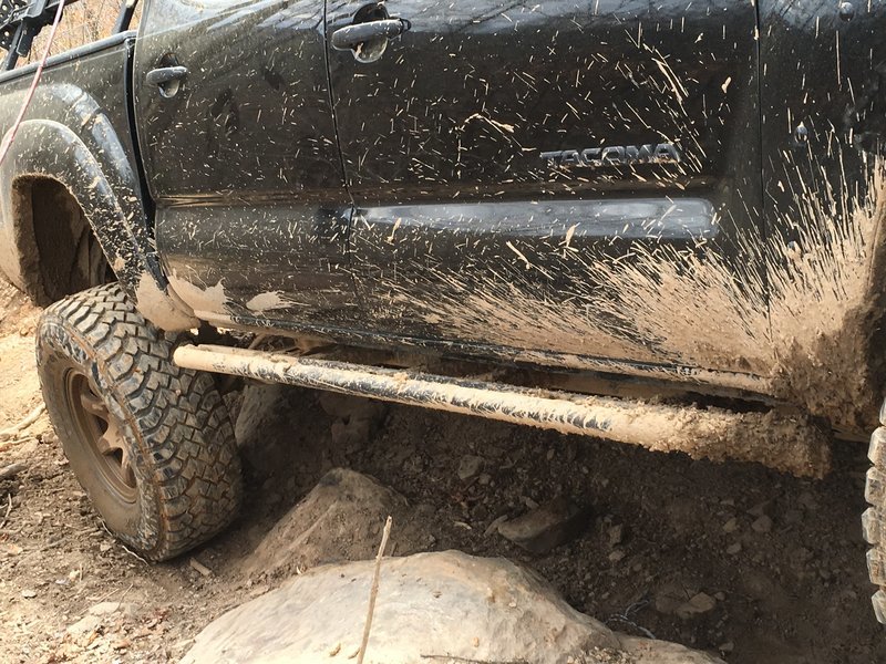

    Kinda did that last night at the camp site ha. His damn door had mud inside it too
