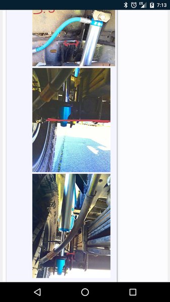

    So here is some pictures that Ryan @Shmellmopwho sent me right before I did my relocate and right after he did his for reference. I can grab pics of mine later if needed but im very close to where he is at.
    Also, you have aftermarket bumps ?
    I say order new lower mounts, order the flip from AllPro and use those bumps you have. Resolve this issue by cycling and measuring. Dont rely on a riser and bump as your fix.

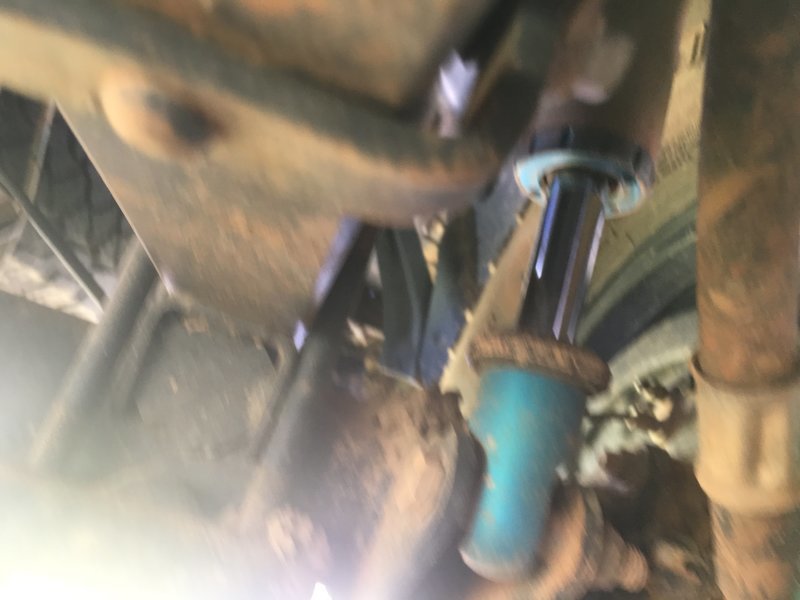

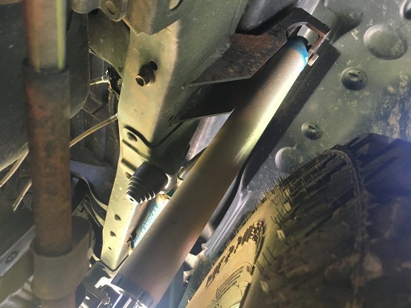

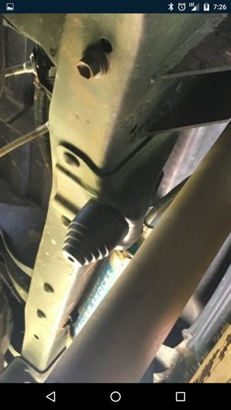

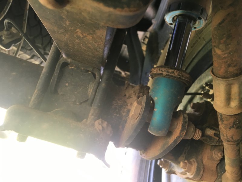

    I bought some cheap bumps from o'reilys just so I could try to wheel at AOP but that failed.
    Here is what southeastoverland emailed me and it makes sense what they did. I'm going to give them some measurements after while when I go flex it.

    What are these on his upper bump plate?

    The ones from o'reilys to try to get me by at AOP

    But you are in far greater likelihood of bottoming that shock before drooping it all the way out. Your leaf pack and shackle will make sure of that

    Baby bump stops

    So order new lower mounts and the all pro u bolt flip kit and the super bumps?

    Im saying buy new lower mounts cause cutting that one off and cleaning the axle is going to be a bitch and I seriously doubt you have enough material left for proper mounting after.
