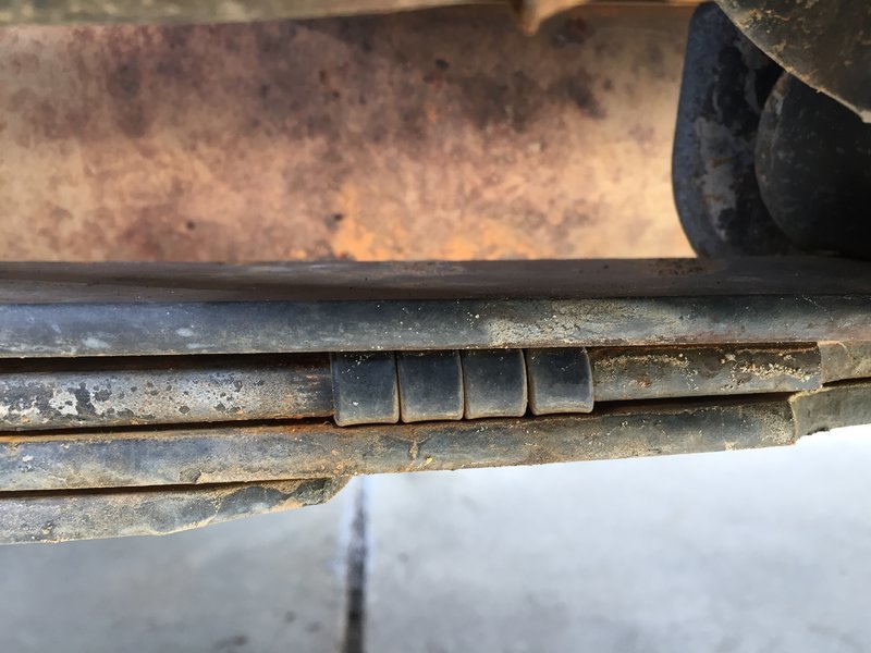

    Check The Build Thread
    Mine aren't that noisy but I did do the zip tie mod.
    ChadsPride[QUOTED] likes this.

    I may have seen that. Zip ties and tire tubes??

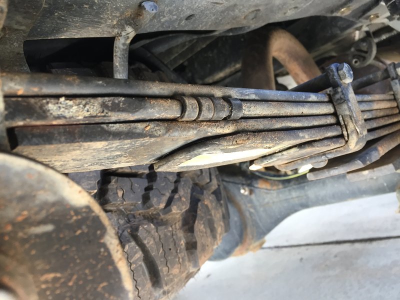

    Yeah but I just used zip ties. I isolated each leaf on both ends with four of the big HD zip ties. I was chasing a squeak (that I still haven't caught) and it ended up not being the Dakar's...they're pretty quiet as of now.

    So you literally just put zip ties at the ends of them kind of like where the isolators would go? I may do this

    Yes...lifted the rear, used a screwdriver to pry apart te leafs, and zip tied. I'll grab you a pic...

    After looking at them, it seems the zip ties moved towards the center of the leaf pack a little but I'm still not hearing much noise. If I start to hear them, I'll move them back towards the ends.
    Front:
    Rear:
