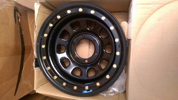

    Steelies are heavy but strong. Whats the BS and size?

    Curious as well, I like the look, especially for that price.

    16" and 4.20" bs

    May not clear the calipers. Common problem with the steel wheels from places like summit.

    Damn no he just texted me and said he'll take $300 for all 5 damn I need to know if they work

    No Bueno for 35's without spacers, need to get to 3.5-3.75
