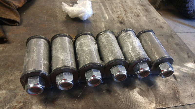

    One of these is yours. And I don't use spindles. Use these dual shears with machined 1" bolt

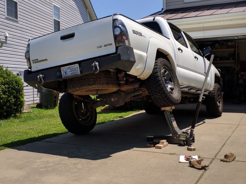

    Had them on for almost four years without issues. Go stuff the rear, measure the distance, cut them to fit, drill the hole, install.

    That's one way to do it :) I drove up on some slanted loading docks

    That just seems a bit sketch to me... maybe I'm just being a wuss?

    I'd sure as heck chock the front if I was doing that.

    It was perfectly stable, 3 points of contact passes OSHA saftey standards
    I am one of those crazy people that use a parking brake, but yea I probably should have. Even still it wasn't going anywhere.
