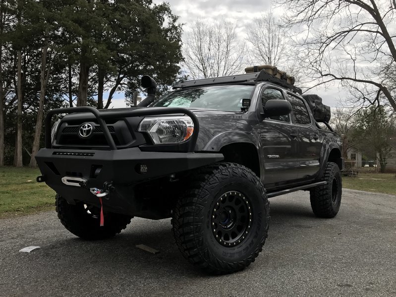

    BFH, cut fender and flares around 2", beat back pinch seam and cut it in 1" sections, stick around 4-3.5" bs and get your castor around 3*

    What about offset on wheels, I saw that scs has a 17" 3.5BS with -38mm offset how would that fair?

    Bs is back space that's what is 3.5" and that's a good number to stick around. That's what I was running

    How far they stick out passed the fender when the wheels are straight?

    Maybe an inch

    4.5 BS without spacers, where does it bind?
    Frame or UCA?
    ChadsPride likes this.

    Uca

    Yeah I'll take a pic might be more than an inch
