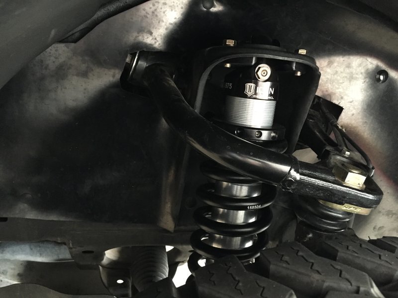

    Rather than cranking up your fox coils for lift just throw in some king coils, they are 1" taller so you save about the same in preload if you get the same weight rating. That's why I did. I am running TC UCAs with limit straps and Icon extended travel COs with 14" 600lbs King coils and no preload. Access cab 4x4 and sits level with my Dakar pack and camper shell. Rides awesome too

    Ok let's say your OME coils are all various lengths and you're sticking them in a 5100 at the "stock" setting. Yes, they provide different amounts of lift, but you're also compressing(preloading)each of them to the same length(length from top hat to lower spring perch). So in reality you're compressing the longer spring more which=moar lift. :cookiemonster:
    It makes sense in MY head. :notsure:
    When I switched from 650# 13" coils to 600# 14" coils I had much fewer threads exposed to achieve the same lift, BUT the coil is 1" longer so therefor the prognosis of the synopsis theoretically bypasses the physics of newtons law and paraphrases the emphasis on myself using big words to sound smart after I've ran out of logical things to say. :pccoffee:
    This post brought to you by Absolut and redbull. :hattip:

    13" 650#
    14" 600#
    Same lift
    EDIT: My truck was so clean when I got those Icons :bananadance:
