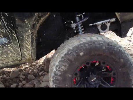

    Wasn't for the tires, DB only way for more than 3" with a 4x4 (and rides better:thumbsup:)
    Fox resis, TC uppers w/ Heims and no CV angles:D
    3" (SAW c/o's) with 315's
    6" BDS w/ 315's
    Haha think what you want about my rig :laugh:

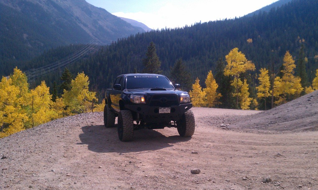

    That is off of Guanela, is that a trail or just a dirt road?
  13. Oct 26, 2012 at 5:45 PM
    Blacktacoma23
    Blacktacoma23 If your tires don't rub you can fit bigger tires
    Jan 16, 2011
    #49366
    5,001
    2011 Mall Crawler
    6" BDS DB, 37", Dirt King, Total chaos UCA's w/ Heims, Fox c/o's, 4-banger fenders, 37" Nittos, 4.88 w/ rear ARB, AP Expos, 17x9 Method beadlocks, cab mount relocation, "Insain fab" tub, 5% tint, 10" Rockford Fosgates, Magnaflow 18" custom catback exhaust, AFE intake, Trail Gear bumper, Crown brake lines F/R
    This is a big switchback with a view, there is trail before and after where the pic was taken.
  14. Oct 26, 2012 at 6:00 PM
    Sublime
    Sublime Well-Known Member
    Nov 14, 2009
    #25918
    3,422
    Phoenix, AZ
    08 TRD 4x4
    Icon/All Pro.....chopped for 35's
    Thats a beautiful pic!
