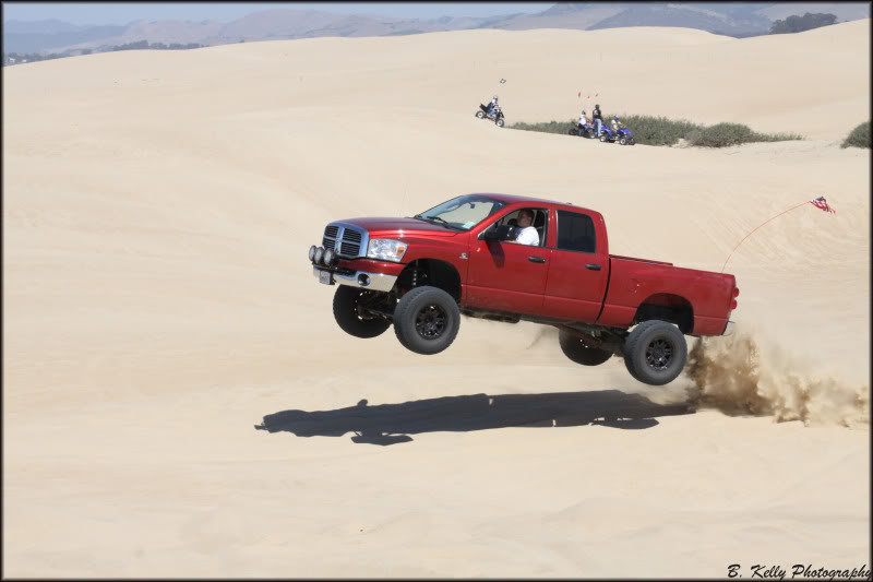

    Air bumps aren't absolutely necessary either. I have seen 3/4 and 1-ton diesels that do great with doubles and no air bumps

    Like this one

    ya im just thinking if hes jumping it or something

    he probably bottomed out pretty hard from that tho, i wouldn't be doing that without some kind of bump zone wether it be triples or hydro bumps

    The truck actually handled it quite well, and that is with just remote resi smoothies in the front too. That's what proper shock tuning gets you
