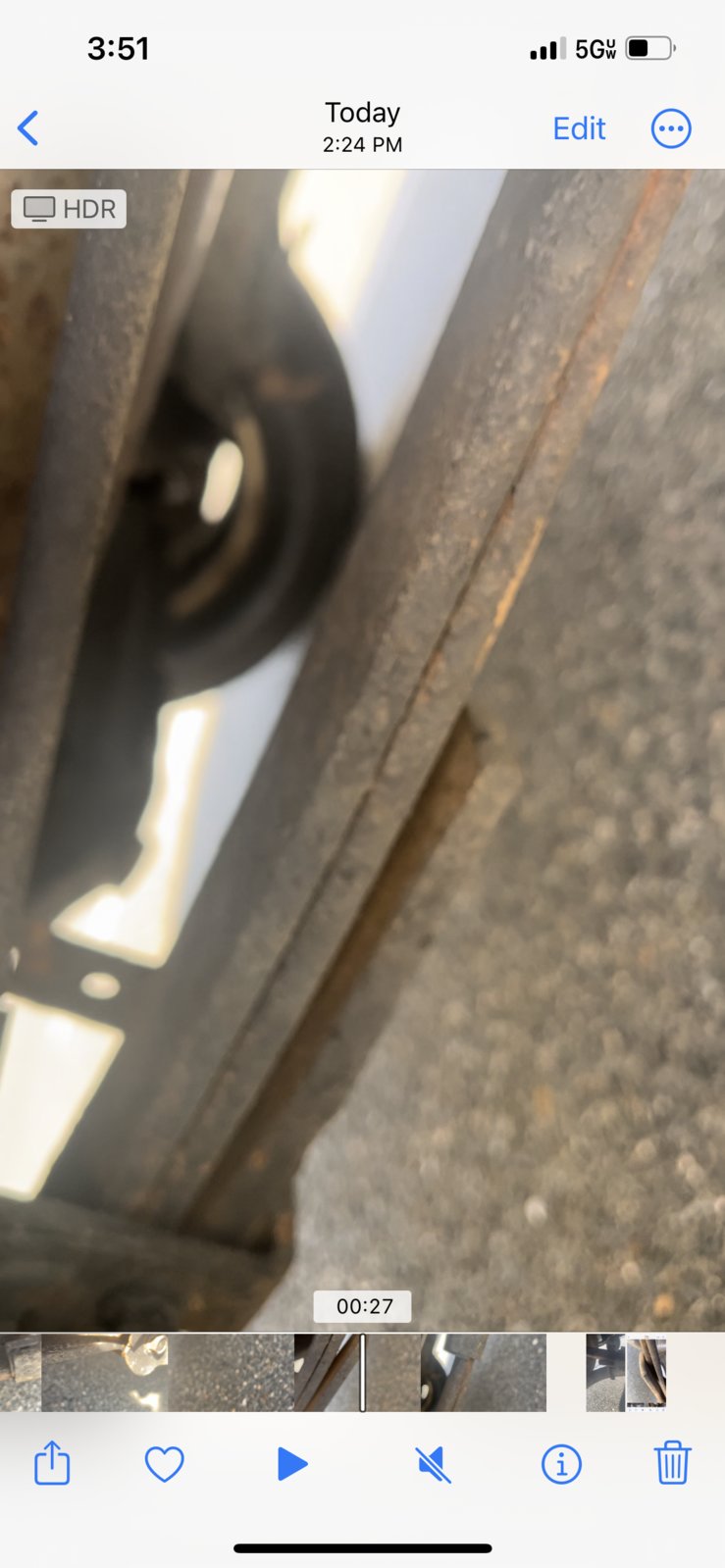

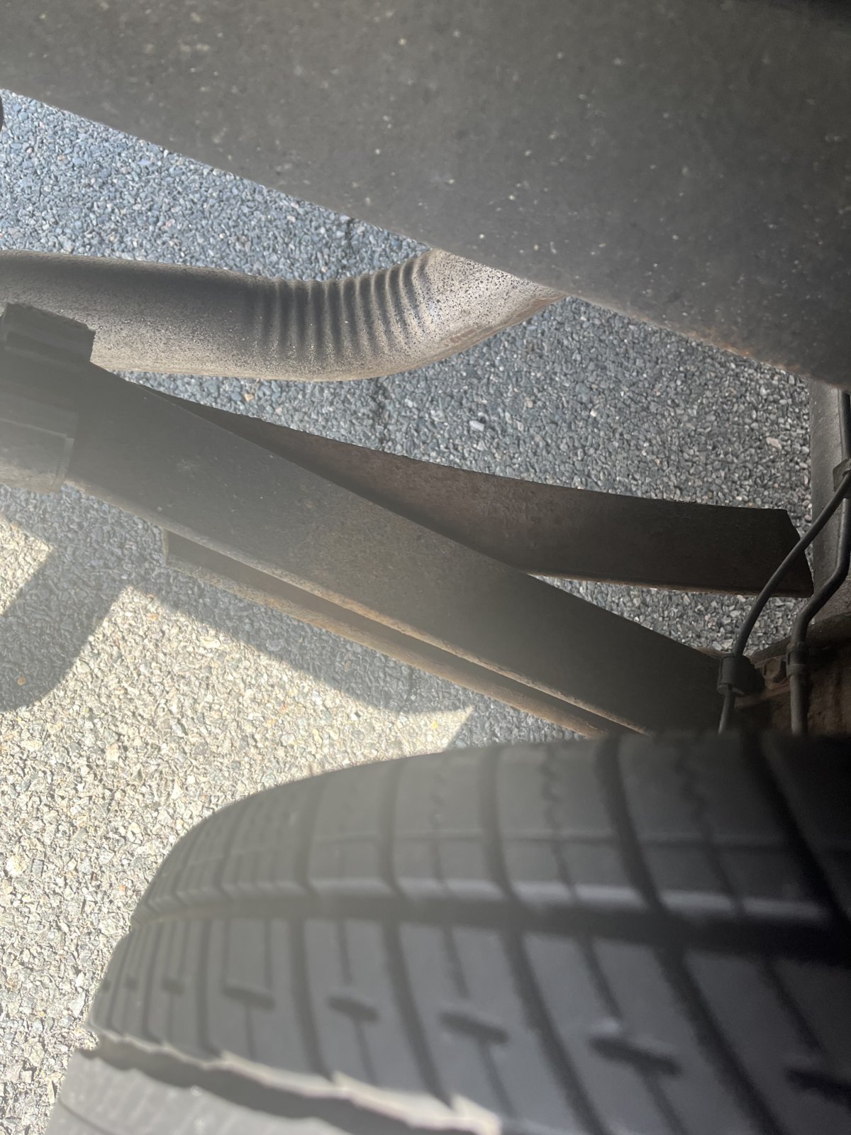

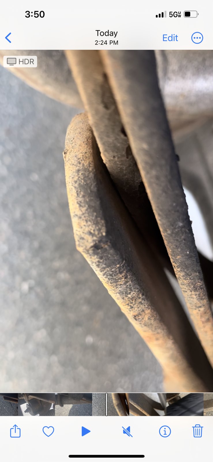

    Hello,
    Got a cross country drive around 2000 miles that I have to go on next week, took my 2006 Tacoma to the shop and they told me my middle leaf spring on the rear passenger side has been broken. I will attach some photos.
    Couple shops have me quoted at 1200-1500 for repair, but essentially my situation is once I get back home it would be infinitely easier to handle that financially. My mechanic friend said there is a chance I could move it back to the middle and get a u bolt and tighten it down and it could possibly get me back home. This is from VA—>AZ
    Was wondering what anyone thought of this idea? Would save me over 1000 bucks which I would need to get back.

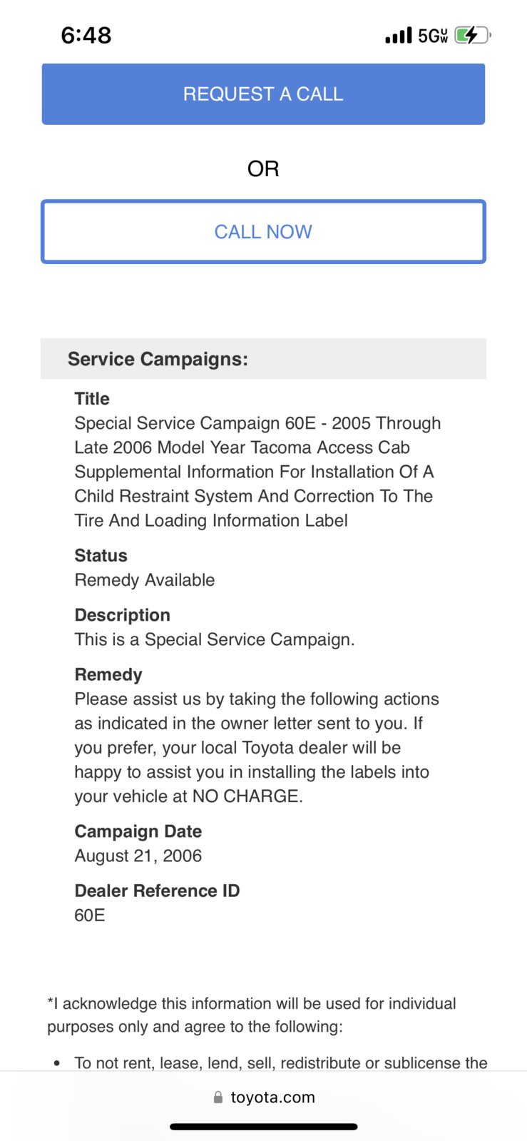

    If your near a dealership have them run your vin,
    you have the three leaf pack which is under recall, they will replace with four leaf pack for free.

    Wouldn’t it be past the recall date? It’s a 2006.

    No it’s still active. I’m a 07 and got mine changed last year.
    Do it, it’s free!

    So even though I bought this at a used car dealership, I can go to an official Toyota dealership and they will repair it for free? I see that the recall is for the 4x4 and pre runner models, I just have a standard 2.7L 4cyl access cab Tacoma, nothin fancy sadly. When I run my VIN under the Toyota recall check it only says I’m eligible for an instruction guide on child restraints

    Give them a phone call, and ask.

    Tell them your middle leaf is broke & rubbing on the gas tank.

    I had a middle leaf break a few years back. A local spring company made/installed a new one for $300.
