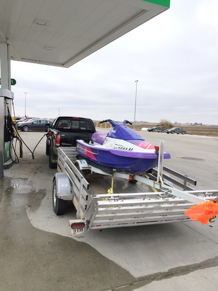

    Pulled this set up 300 miles at 75mph on Saturday. Was able to use 5th gear for most of it believe it or not. I don't think you'll have any issues, but I agree, put it in the bed if you can.

    I'm confused, why do you have a light trailer inside of a heavier trailer?

    Because I don't trust the trailer thats under the jet ski... I would trust it if I repacked the wheel bearings and checked it over.. but I rather put it on my nice new trailer that CAN run 75mph
