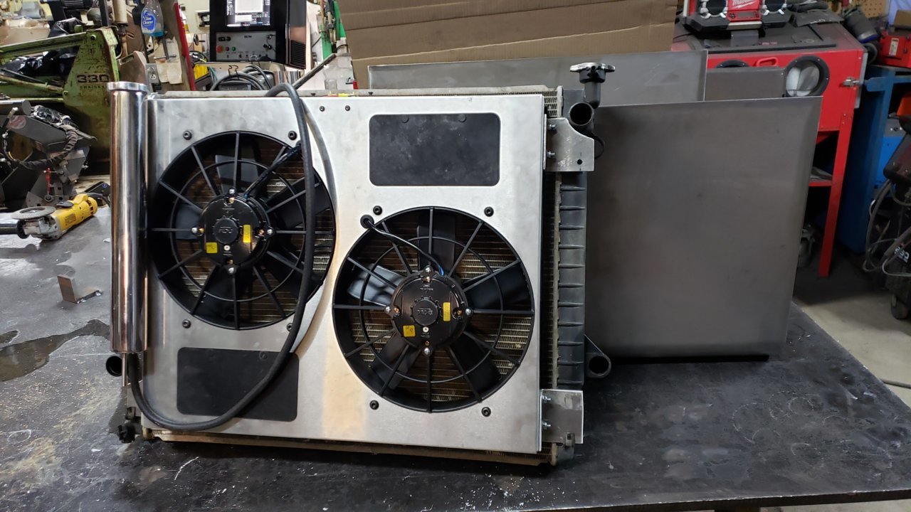

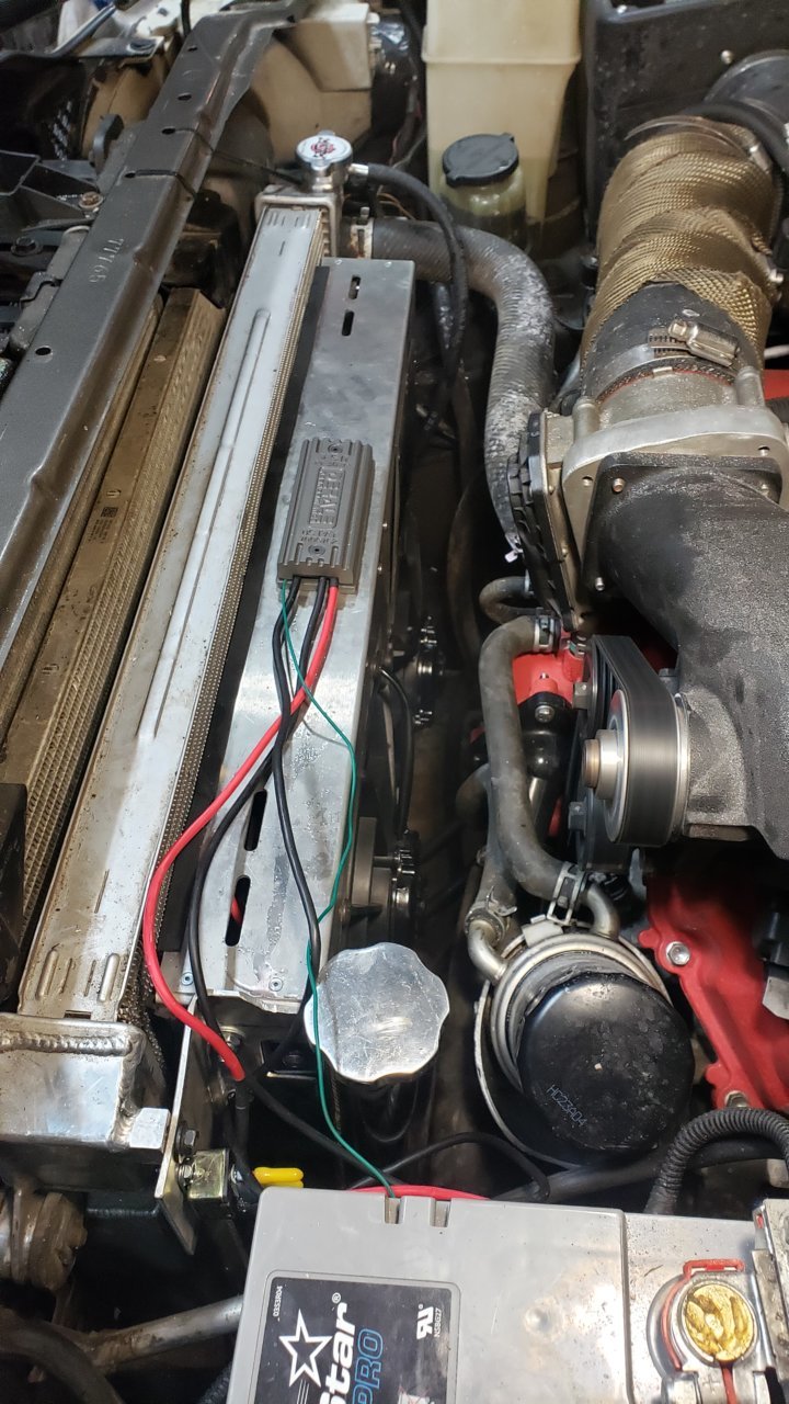

    Stroker engine with 160 motorad thermostat gets hotter than I want. Even in freezing temps. Went to a 160 Mishimoto thermostat (they flow better) and a Derale twin electric fan system with pulse width modulator..
    Here is the test fit fan system mounted to the factory radiator. Had to build custom L brackets as the ones that came with fan wouldn't work.
    And installed..
    Went to a rpm 69" SC belt and a cogged 2.3" pulley too. Overall a good day.
    The fan system has it's own temperature control system with an AC override wire.. While setting the temperature on the fan to turn on at my choice temp, I wired the AC override to the fog lights for easy control for now. I still have to chase down the AC on wire in the fuse box to tap.
