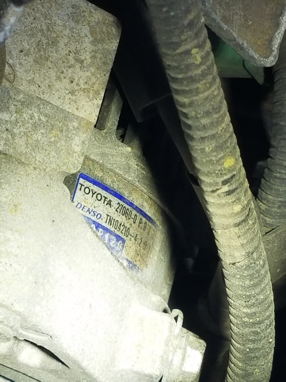

  5. Apr 27, 2018 at 10:04 AM
    #245
    ponts
    ponts Well-Known Member
    Aug 6, 2015
    #161157
    415
    Hi guys, I’m being asked this question by Michael Singer. I have a 2016 Tacoma TRD sport. It is the 3.5L with trailer pkg. I’m not at a position to take anything apart for a few days. Can anyone help?
    Thanks in advance!!
    “I will need to confirm your plug code
    if you can just send me a photo of the stock plug or confirm it is the 4 pin plug that is all i need to know (and not the 2 PIN LIN bus plug)”
    ManBeast [OP] likes this.

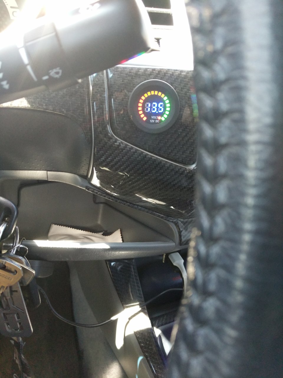

  11. May 3, 2018 at 9:53 AM
    #251
    Aw9d
    Aw9d That one guy
    Nov 7, 2011
    #66635
    18,439
    Az
    Remember everyone that you should to get a voltage meter inside the cab to make sure that you are getting the correct voltage (and to troubleshoot if issues arise). I'm going to run mine directly off the battery. Some people choose the amps.
    I'm not sure if a scangauge will pick up the voltage after the plug has been connected (I don't think it will). Does anyone who placed an order have a scangauge to test?
  12. May 3, 2018 at 10:10 AM
    #252
    deeezy
    deeezy Well-Known Member
    Sep 1, 2013
    #111645
    4,618
    Dana
    Hawaii
    2013 4x4 DC, 6 spd, TRD Sport
    ADS ext travel coilovers with clickers, Icon tubular UCA's Rear-ADS 2.5's, Allpro Expos, TRD cat-back, Hurst/Core short shift kit, etc...
    Yes, my Ultragauge shows the new higher voltage.
    Aw9d likes this.

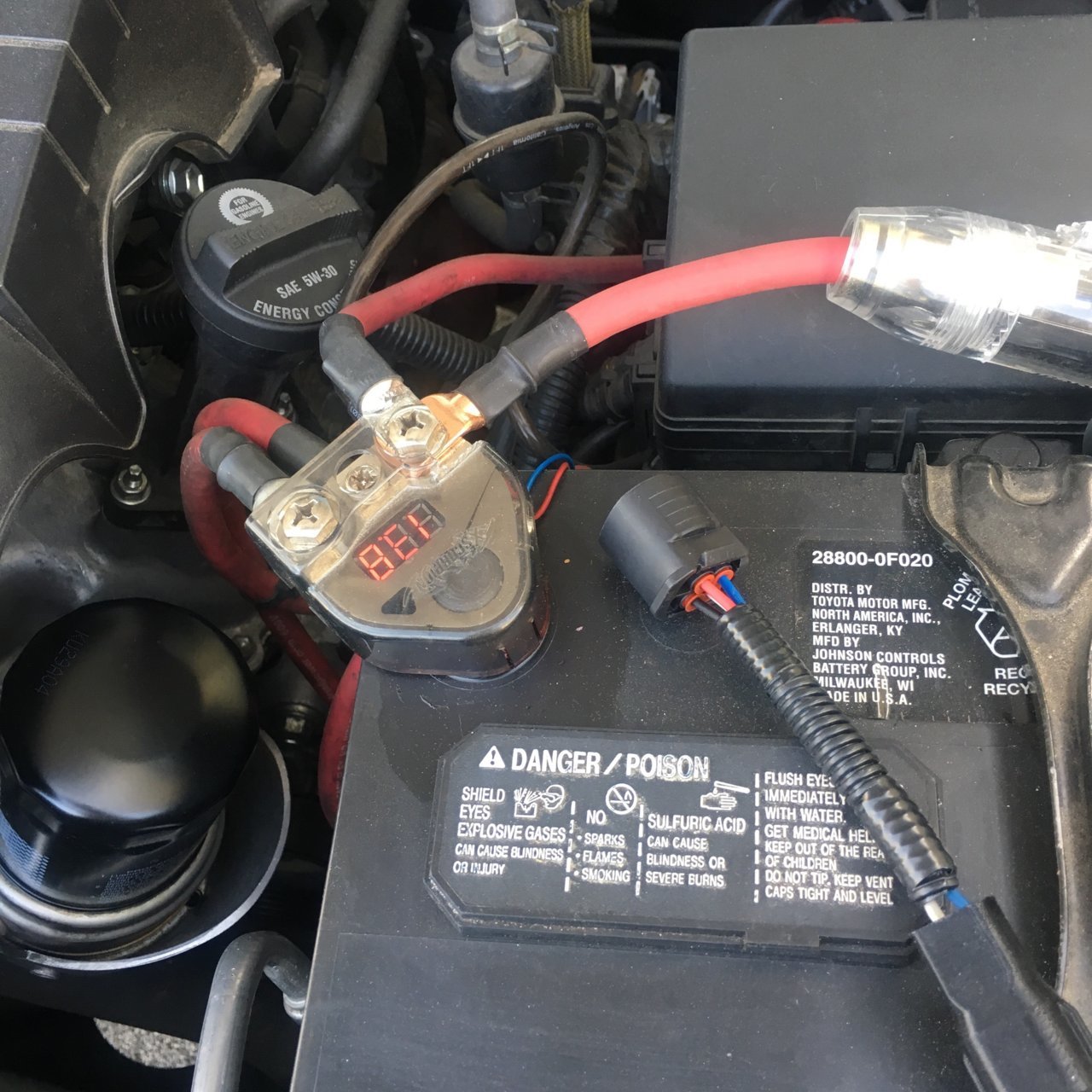

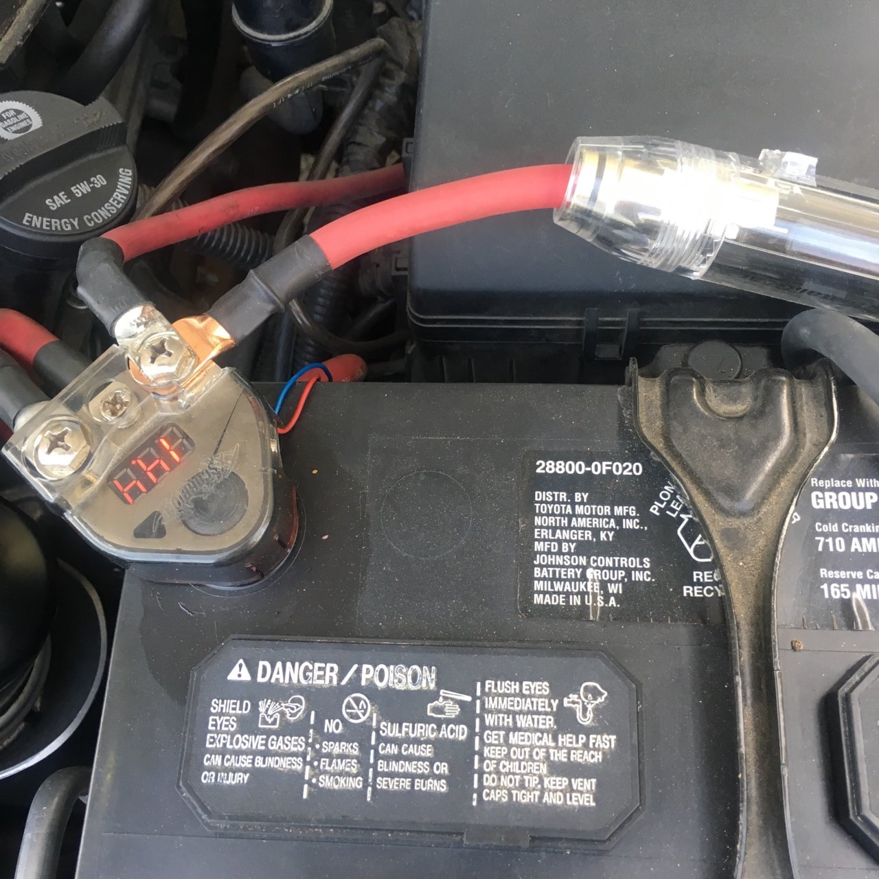

  17. May 3, 2018 at 3:10 PM
    #257
    TheTrooper
    TheTrooper Someone has to be part of the problem
    Apr 6, 2015
    #152625
    204
    Nick
    Asheville, NC
    2015 Silver TRD Sport DCSB
    Access Cover; SOS Sliders; Pop'n Lock
    Before
    After
    deeezy likes this.
  18. May 3, 2018 at 11:27 PM
    #258
    kingk0ng
    kingk0ng Well-Known Member
    May 5, 2015
    #154638
    1,358
    415
    11 TRD OR AC
    just a few things.
    what stage is that? just got my stage one today.
