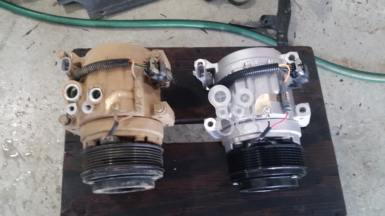

    Compressor die?

    Yeah, as a direct result of too much mud in my condenser which caused over-pressure in the a/c system, and blew the pressure relief safety valve in the compressor while sitting in a drive through line in the beginning of August...... almost 2 years ago :anonymous:

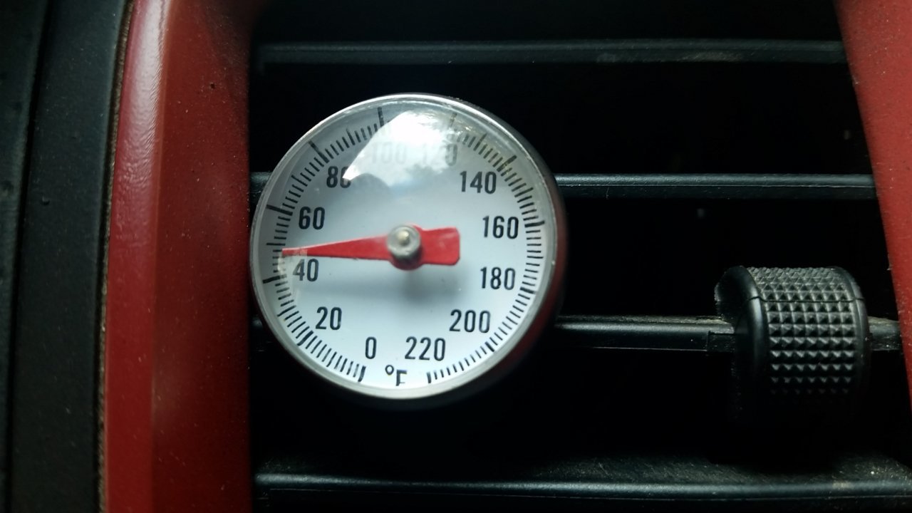

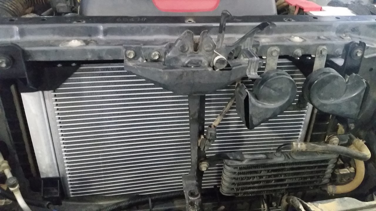

    I HAZ working a/c again :yay: in almost 2 years.
    Pic dump:
    compressor took a shit due to what i explained in post #414. Replaced that, the condenser, and the little a/c filter. Blowing 47 degrees out of the vent..... which is good, but i have plans to install and wire in a pusher fan in front of the condenser to help get it even cooler.
