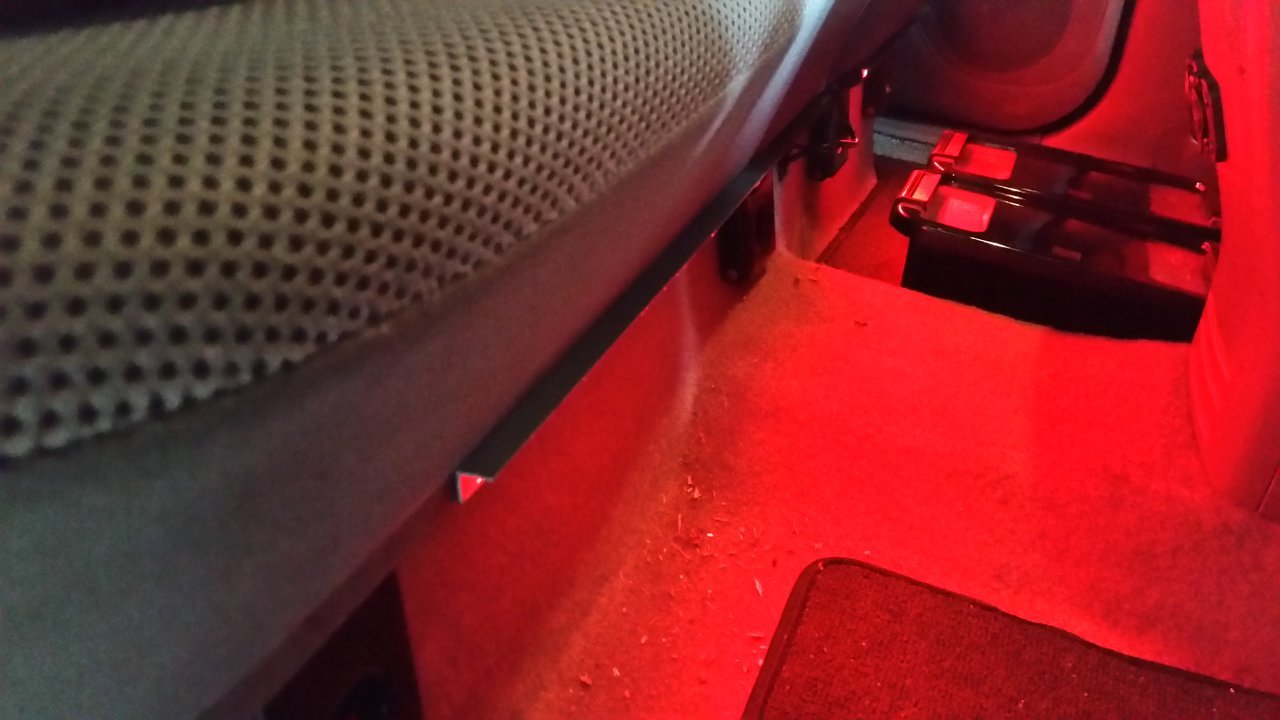

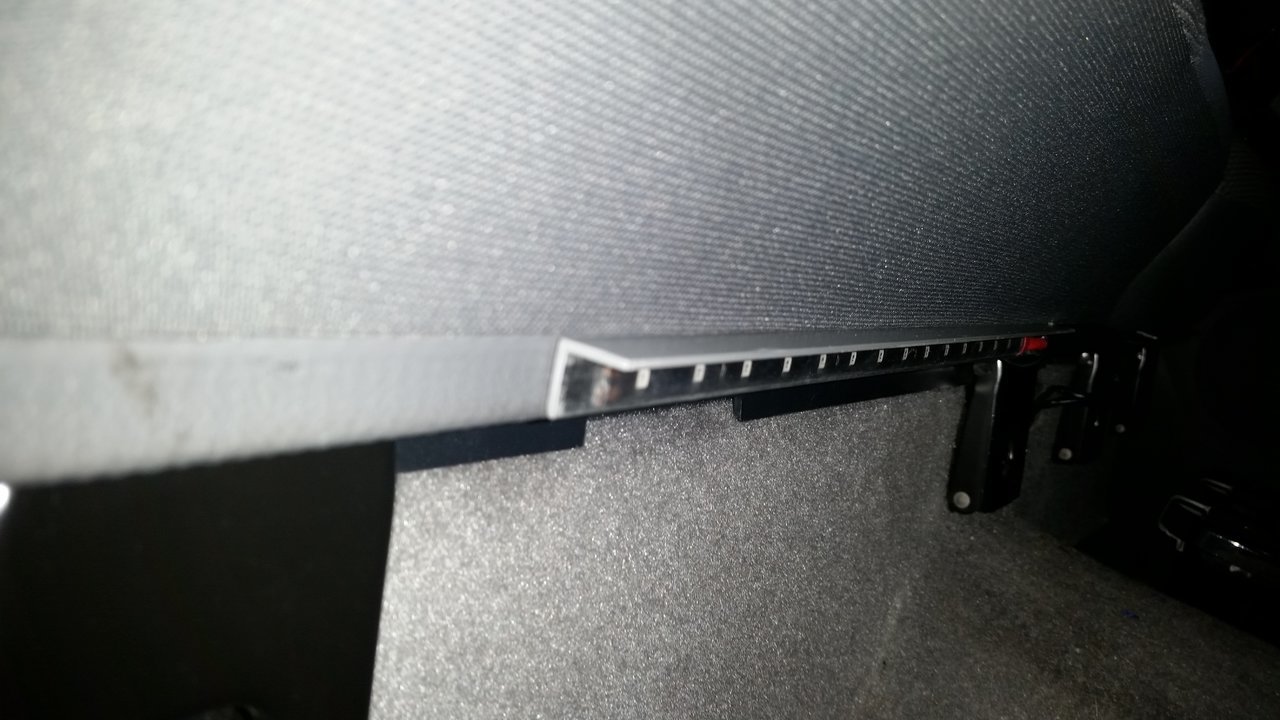

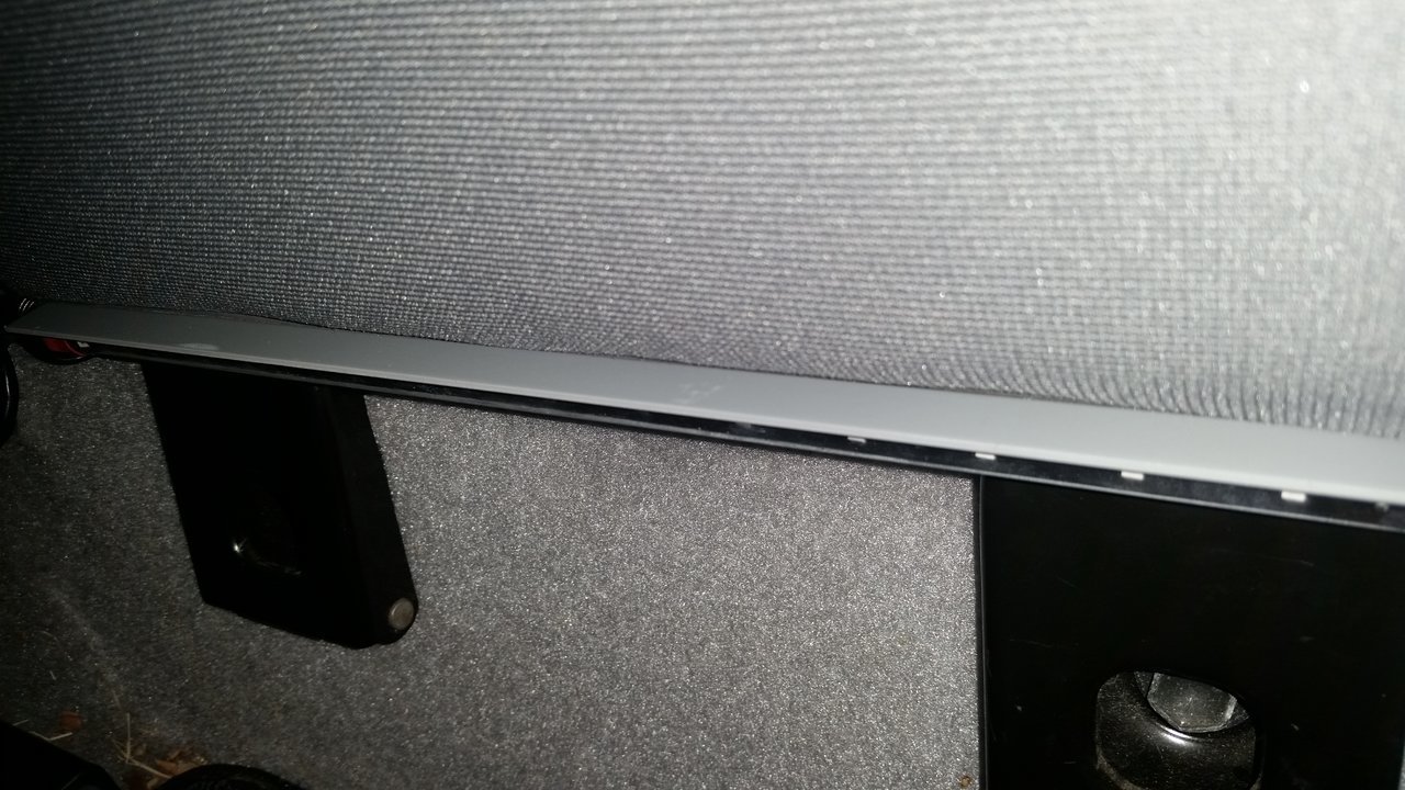

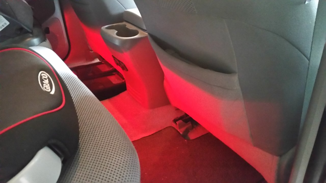

    Update.... turns out that if i turn my head to look to/out of the back, at the bottom of my view i see the led's. Not bad, but at night that's what your eye is drawn to. So i came up with a solution. Got a section of 1/2" aluminum angle and basically made a shield for the lights. Works pretty well from what i can tell, obviously need to test at night. Here's the breakdown:
    Cut a 12" section for the left side, and a 14" section for the right. Painted the side that will be seen grey to match the seats/interior. Used some gnarly ass double sided tape to affix the angle pieces to the plastic edging of the rear seats. Stuck the led's to the angle pieces (leaving the inside sides of the aluminum unpainted to use the top side kind of like a mirror if you will).
    Pic 1: basically this is my view turning and looking from the driver's seat now. Imagine no shield and seeing the led's.... exactly.
    Pics of the pieces and led's on them
    They still shine up pretty far on the rear of the front seats without me having the issue i just solved.
