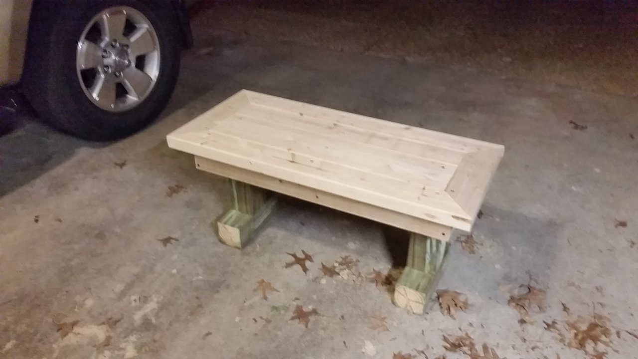

    benches look good.
    over-built and heavy looking, but still good.

    Are heavy, but then again, so is the table :D
    Thank you though :cheers:

    You gonna stain em?
    I noticed there is treated and untreated wood in there.

    If you're going to stain/seal make sure those 4x4s dry out first.

    Benches look great, btw. Good job.

    This was my point.
    He did a damn fine job constructing them though!

    is there a way to speed up tge drying out process, or do i just have to let them dry naturally?

    You can put a heater on it, but gas/electric bill. And risk of cracks and warping too

    so heat gun or mini torch would work too?

    Uh...no.
    I'm meaning you should put it in a garage with a heater on it. Follow the link I posted and see what the internet lords have to say.

    For instance; building a deck with treated wood.
    It's recommended to wait minimum 3 months for it to dry before stain or paint

    you can DIY oven dry it but don't burn the house down.
    Cut and retape some boxes to make an enclosed space around the bench. Make an opening at floor to point a space heater into it. Make a small vent at opposite end from heater near top. Heater on low for a few hours.
    If you flick a drop of water and it beads on the wood, it's likely not going to hold paint/stain very well.
