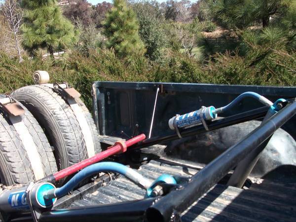

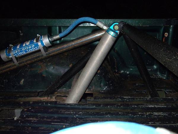

    Side view of the bedcage
    fully painted, holding my sketchy hi-lift
    mounted the race radio antenna on the bumper so the cb and this one don't hit each other
    brake proportion valve is rigged on kinda not so pretty, but wanted to make sure things would bend and not get destroyed if the axle hit the valve when I bottom out.
    I think I get an award for having the most worn out uniballs on my UCA. Must be about a 1/16" inch of slop in it. Trying out the ballistic fab uniballs. Only $30 an uniball.

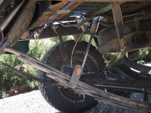

    Like bobby said it is just a JD fab kit. Does very well. Battlescars is selling his kit.
    I pulled a whole ton of leaves, lol. You need a good amount of weight to keep her down also. I got from the smallest to largest. 1st 2nd and 5th pulled and still slightly under 11" from axle to frame. I'd recommend a F67 pack instead of the 50T for a first gen. I was just curious if I could get it to work well. Took me about a year to tune it. Maybe even do an F55 if you arent running any weight in back.

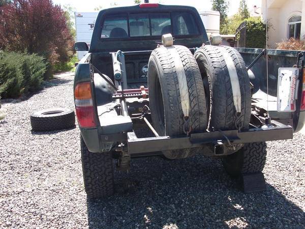

    i have 2 33x12.5x15 general red grabber spares hanging off the ass end of my truck.
    so theres some weight back there thats for sure. the bed cage isnt done so there will be more weight back there. and for my fuel cell theres 2 places i can put it.. right here V
    or i can put it right infront of my spare tires so ill have more weight farther back. like here V
    what do you think?
    and when i talked to engage he said since im going to have alot of weight he told me i should get the 13 inch shackles so i did, should i send em back and get 12s? maybe he thought i was going to have a shit load of weight?
