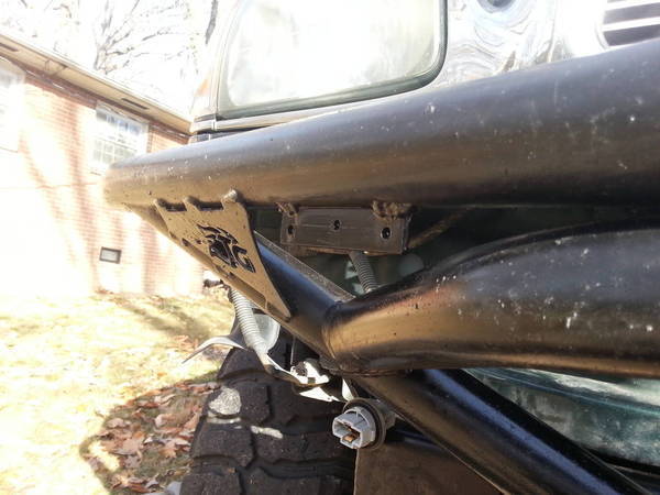

    Here is one of the tabs I welded on for the turn signals
    and here is with the turn signals mounted

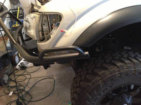

    Truck looks sweet man. Are you going to trim the fender lining and remove that bracket in front of the tires? Its a few screws inside the hood and one outside and the bracket pops off. Makes the front end look a ton better in my opinion. Heres mine after I cut the liner with a box cutter at an angle.

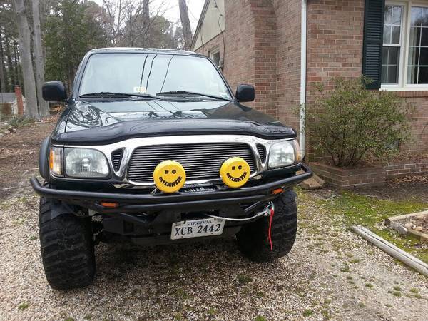

    Just got done installing the winch :D
    Just about gave myself a hernia trying to get the bumper back in place with the winch bolted to it. I'm hoping to get the solenoid box installed in the morning. I'll take some better pics. Got some battery cables from the parts store and hooked them up in the solenoid box already. The plan is to put it in the engine compartment. There's just enough space right behind the airbox.

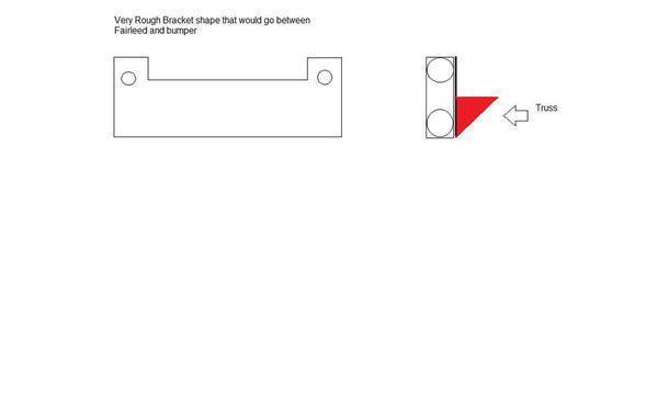

    So this is an idea I have for a temporary bracket to make the roller fairlead work with my TG bumper until I upgrade to synthetic line and a hawse fairlead.
    Give your input. I'm thinking the truss on the backside of the bracket will prevent the roller bracket from bending if the line was putting any serious downward pressure on the lower roller.

    Looks good. I guess it all depends on the welds. Hopefully when your ready to switch to a hawse fairlead it won't be to much of a bitch to undo.
