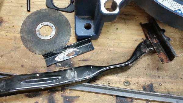

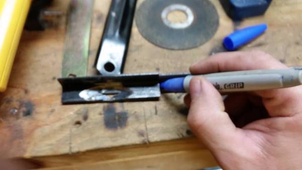

    Here's a little project I just did, figured I'd have a little fun and document it. No making fun of my workspace, I do everything in my shed, it's the only space I have for now and I've got 50 million tools shoved in there. Plus I did this while trying to prep dinner for the wife and kid, so I had to be quick, lol

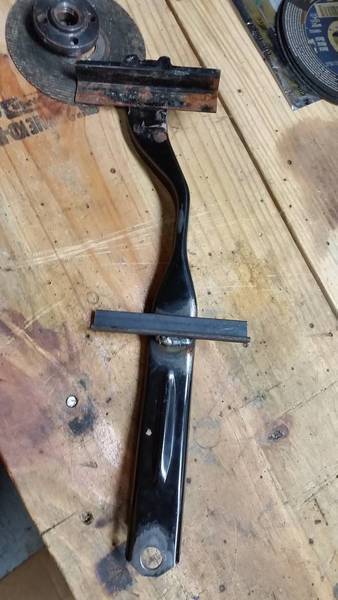

    Battery hold down modification to accomodate Diehard Platinum 34M
    First, I lit the oven to preheat it for dinner, lol
    Next, I cut off one of the battery guides

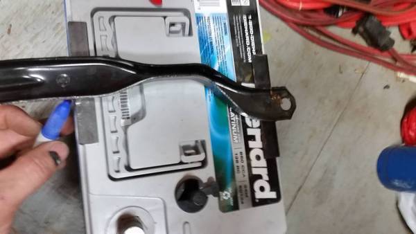

    I used that old guide as a length template to mark a piece of 1/2" angle iron
    Then I mocked it on the battery for fitment and made a mark

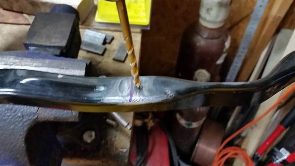

    Then drilled a hole to spot weld through... didn't really need to do this, i was just following along the way it originally was assembled.

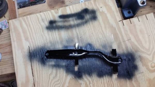

    I spot welded through the hole, then also laid a bead for extra stability since this battery is bigger and heavier than the OEM size
    All done, I hit it with some satin black rustoleum, waiting for that to dry to hit the other side then she gets installed... oh, I cleaned the whole thing up with a wire wheel before paint

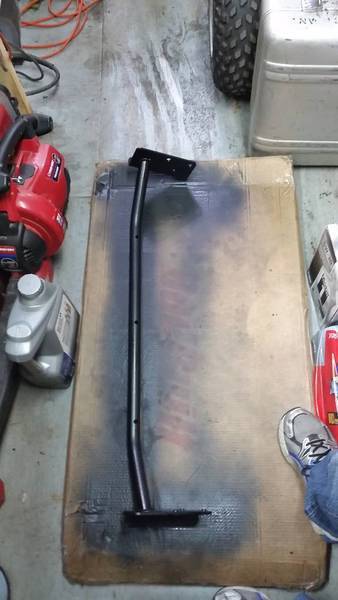

    broke out some pieces for the sliders and skids and slapped some paint on them... Using Rustoleum bed liner paint

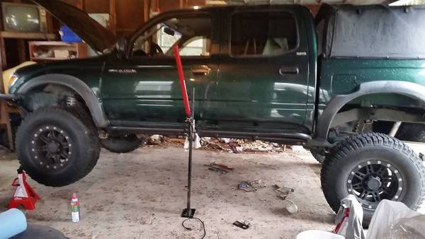

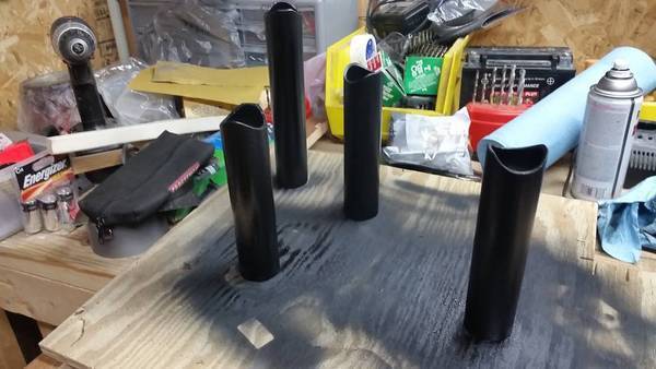

    No updates for a while, haven't had time in months to really get shit done on this pig...I have a stockpile of parts waiting to go on... I did manage to install an All Pro rear bumper, I'm severely lacking on photos, I'll try to catch up soon........So here's the latest:
    Broke out the Lincoln welder and prepped the stanchions for the 4xInnovations sliders

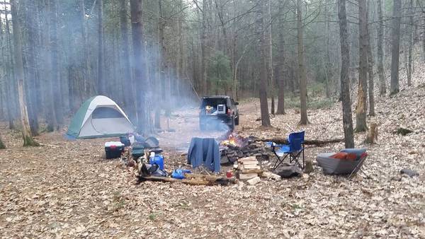

    Went out and did a little camping after getting those on
    The truck is progressing along slowly, and she does everything I want her to do so far... I plan to test it out on some more treacherous trails, possibly in the near future, depends how my schedule works out.
