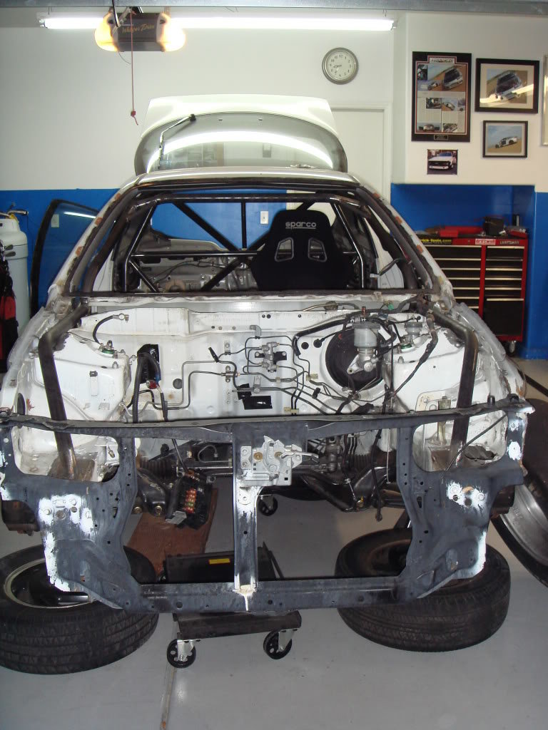

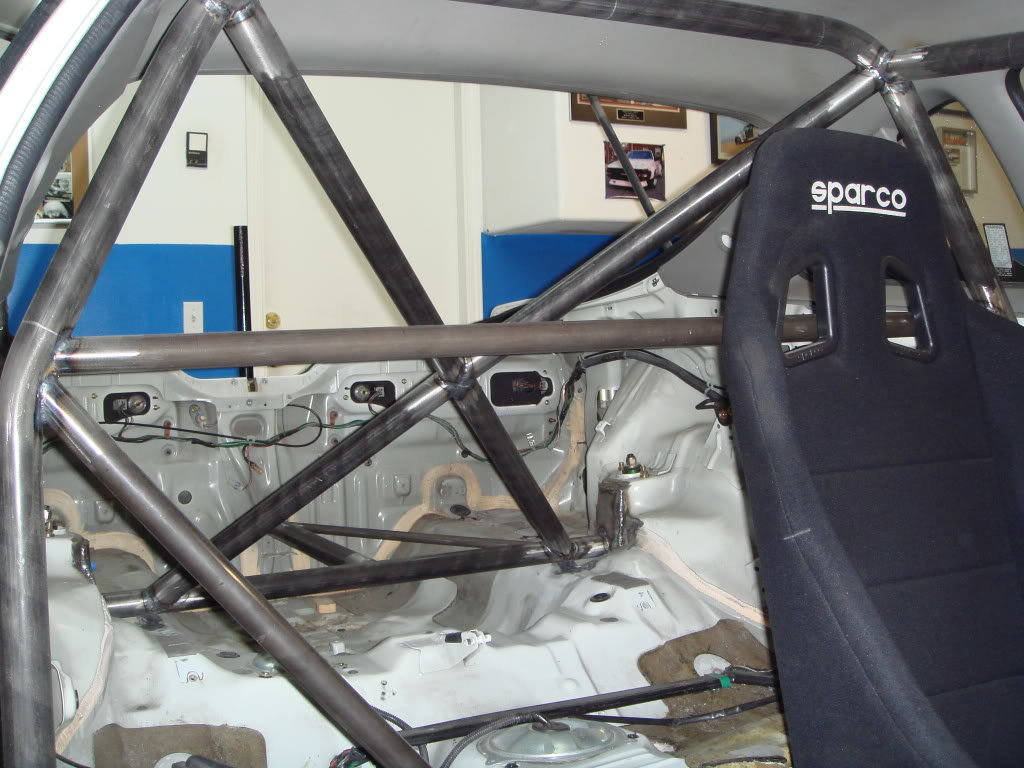

    Whooped-out desert stuff? Nice!!
    Being a pre-runner is a good thing in this case. Cheaper and easier to make the 2wd rigs more capable in the desert, and less weight generally equates to less breakage. Since you ride dirt bikes you've got a familiarity with the terrain so that'll also help keep things in one piece. ;)
    Upgraded front coil-over shocks, preferably with remote reservoirs, would be a good start. Your budget will obviously dictate what you ultimately get.
    If ground clearance was/is an issue then the lift will help in the front but won't do anything in the rear. For that you'll need taller tires. My guess is that you were scraping bottom when the suspension was maxed out so you should be able to hold off on tires for now.
    Some folks with gen 1 trucks will no doubt speak up soon. I've only dealt with the 05+ trucks but the concepts are the same.
    Post some truck pics while you're uploading those welding shots. I'd like to see where you scraped stuff up. :thumbsup:

    LOL! I was thinking the same thing when I saw those shots.
    She could do all the work I've been paying for up to this point. :cool:
