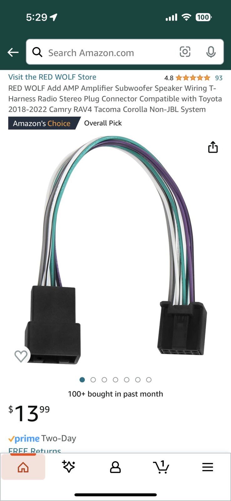

    That’s not a problem you’ll run into on a Tacoma. I’ve pulled my dash apart probably 3 dozen times at this point and not a squeak.
    I strongly second the DIY route. It is extremely easy, and the amount of work I got paid to fix that expensive shops butchered was crazy.
    There are great shops out there. But they charge for their quality. $150+ per hour or more.
    Grab one of these to make life easy, even if you only do the sub. But it also simplifies the key and other amp installs
