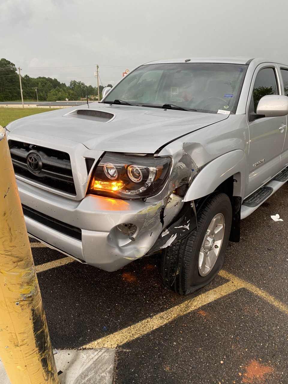

    Nothing is damaged anymore as it just returned from the body shop for a 7.5 week stay. Injuries sustained were to the driver side front bumper and fender/driver side front panel region
    I was just pointing out one abnormality (passenger headlight condensation) that was discovered by me upon vehicle pick up which was Not there previously.
    I don’t know what all they repaired. Posting a pic of vehicle accident for ur curiosity and areas that were repaired

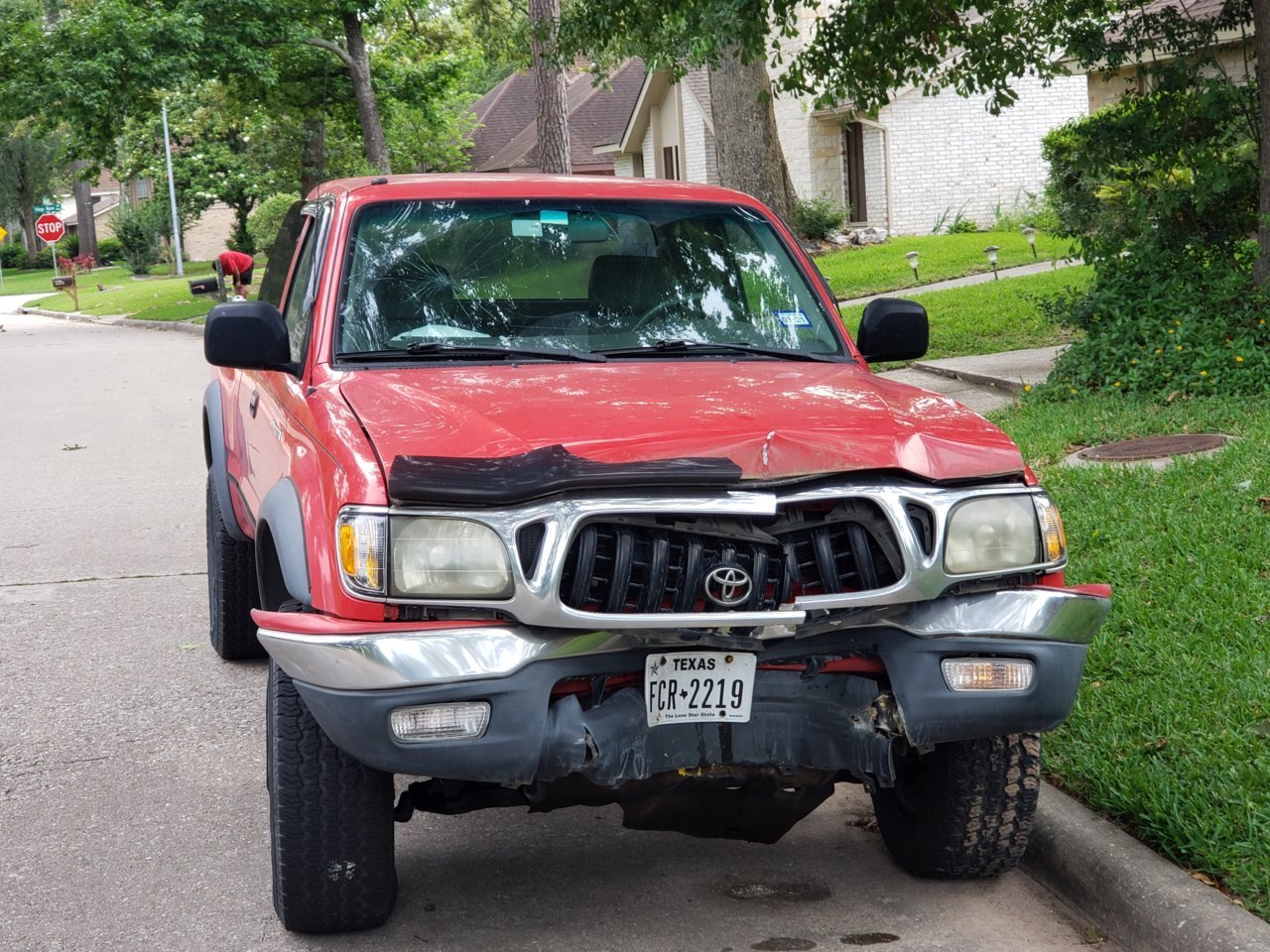

    Reminds me of ... End of an era for me.
    [​IMG] [​IMG]

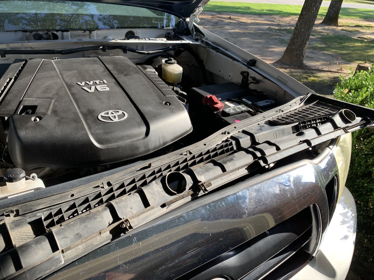

    That’s enough of a hit to maybe make it leak. Mine leaked after a new windshield install. Lower corner is known leak are as is where factory seam filler is installed. You can see the with cowl removed. Me I’d get in there and check and comply with the service bulletins which cover leaks and reseal. May also fabricate and install a screen to prevent mice and rats from entering the cabin through air intake. I had leaks on both sides but got it all stopped doing this.

    The other side
