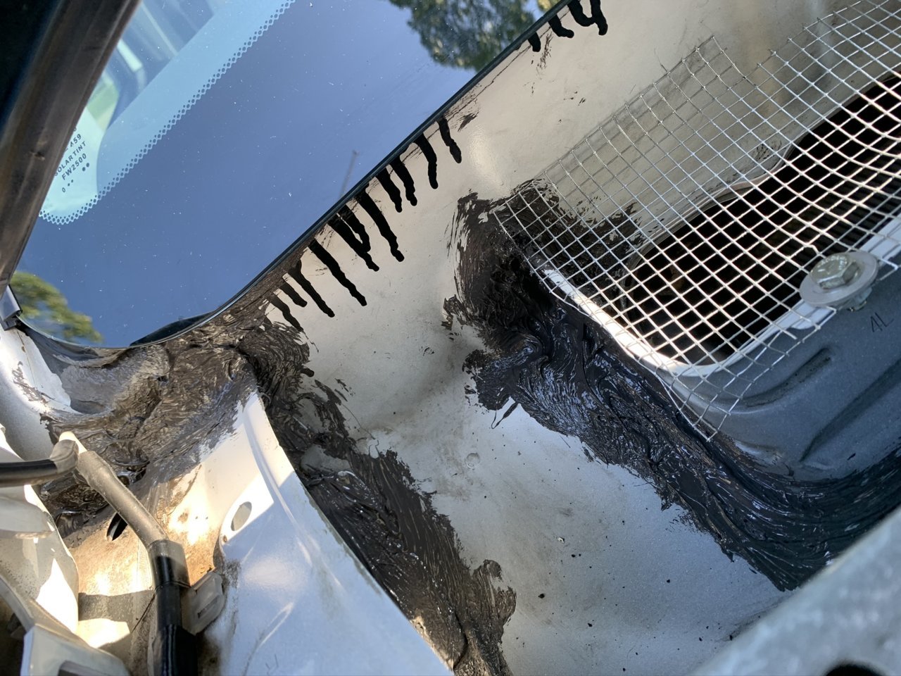

    What product did you use on the seams?

    the product comes in a tube for a caulking gun. It dries semi solid but removable if need be available at Lowe’s most commonly used for sealing around roof vents. Don’t get it on your hands or clothes.
    I used an acid brush to spread it. As I said it looks like hell but cowl covers the ugliness so it’s win win.
