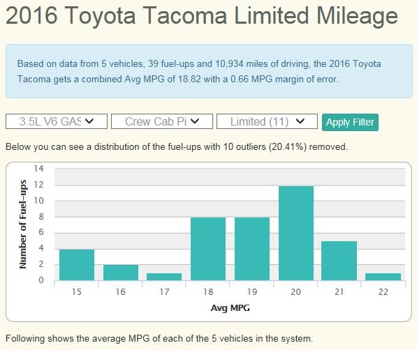

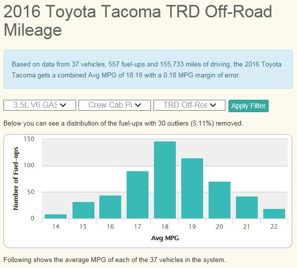

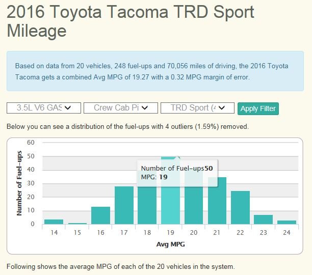

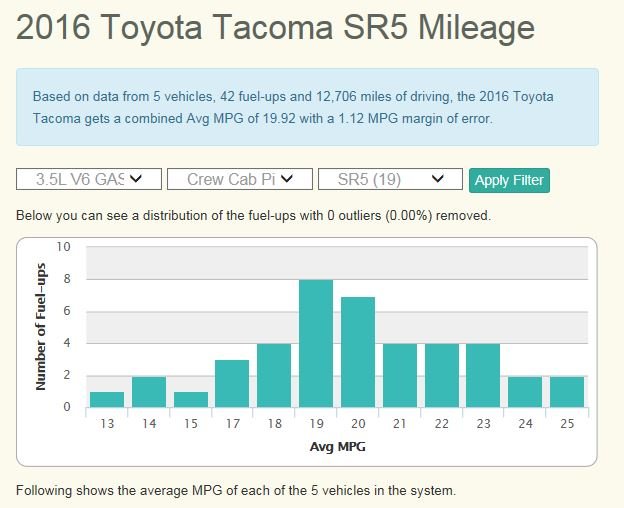

    Toyota isn't going to install an air dam on a truck so intensively aero tested (for a Toyota Truck) unless it did something beneficial to MPG. Annnnddd, lo and behold it appears that is *does* help MPG. Just look at Fuelly. Low # of folks with Limiteds and SR5's, but the data still points to the TRD OR having the lowest MPG. TRD Sport is a full 1 MPG better. Here are screen caps since apparently no one will just go and look themselves.
    3rd Gen TRD OR DCab V6 - 18.18 mpg.jpg 3rd Gen TRD Sport DCab V6 - 19.27 mpg.jpg
    TLDR?; your air dam probably nets you "nearly" a 1 MPG improvement in mileage. Take it off for looks, but it'll cost you a few pennies in old dinosaurs over time.

    I'm all about objective comparison, but isn't the OR geared a bit lower than the Sport? If so you cannot say that the airdam is the only thing influencing the difference in fuel economy.

    Nope, I have seen nothing saying the OR is geared differently than a Sport, all else equal. Please let me know if I am missing something!
    https://www.tacomaworld.com/threads/2016-gear-ratios-at-awesome-mt-now-with-double-overdrive.387347/
    Edit: of course any other item of difference between the trims will potentially have an influence, but the air dam is engineered for mpg...

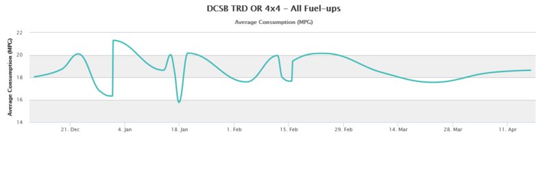

    Nobody has mentioned tires, but the OR tires are likely higher rolling resistance than those on every other model. It would be interesting to compare tire/wheel combo weights since we know that has an impact based on folks upgrading to larger, heavier tires . (I realize that diameter is a factor on the upgrades, but weight is also a factor).
    I don't believe feully sorts for transmission and 4x4 vs. 4x2 and both are certainly a factor. It seems likely that more folks with the OR get 4x4 and there could be a difference in take-rate for transmissions.
    I have observed much lower mileage when I've been off-road at some point while burning a particular tank of fuel (see big dips in chart below). This drags down my average. I think it's likely that folks with OR's take them OR more often (see what I did there? Yeah, lame. I know). I suspect this is pulling me down about .5 mpg. [Note: Fuelly needs to do a better job with their charts and the vehicle sort options]

    This is the issue I see with the fuelly data, there is no designation of 4x4 vs 4x2.
    But from the data provided, we can assume that 4x4 Tacoma's will average 18-19mpg, because ALL off road models are 4x4. Also there are 37 vehicles in that data group.
    The other models seem to be getting between 19 to 20 mpg, however, there is no indication of how many of those are 4x4 or 4x2.
    But if you look at the fuelly data for the Limited, noticed how the MPG reporting is consistent between 18 to 19 mpg, (the same as the 4x4 off road model) but there is a spike for the 20 mpg. Granted the graph is skewed because there are only 5 trucks in that group, but it could illustrate the difference between 4x4 and 4x2 Limited.
    So my question is, how do you measure the gains from that front deflector?
    Also how much does the extra mass of 4x4 components along with driveline drag offset the effectiveness of the front deflector?
    I would assume they do hence the dedicated 4x4 off-road model doesn't come with the deflector. Plus to compliment its aggressive looks, and off road bad assness, Toyota left it off.
    I know I was joking earlier, but seriously, I have not seen a loss of MPG since I took mine off. My truck is a 4x4 Limited, which also has some other contributing factors such as 18'' wheels and that heavy ass bed cover.
    With the front deflector, around town I was getting about 17 to 18 mpg as my tank average. NOTE that is my tank average! I've filled up twice since I removed it and my tank average is about 18.6 to 19. My results are consistent with the data from fuelly for the Offroad Tacomas.
    As for the highway, when I had the deflector, I got 25mpg on the highway (trip mpg). The other week when I went to the Tamorlando meet, I got the same 25 mpg (trip mpg).
    So this limited data tells me there isn't a huge benefit if your running a 4x4 Tacoma. But if it's a 4x2, then it will have more of an effect, granted your probably getting more gains by not having all of the hardware that the 4x4 trucks have to lug around.
