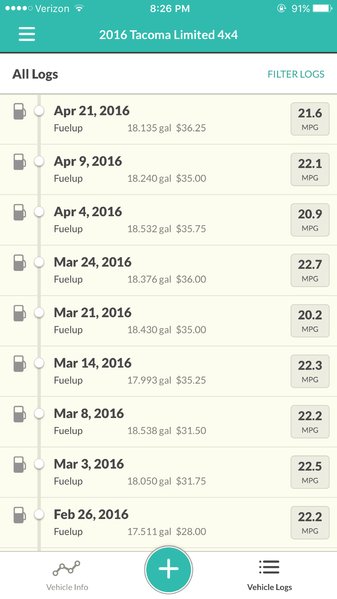

    Air dam came off around March 14 fill-up. MPG difference is negligible at best. If anything it would be less then 0.5mpg. Here's my data... image.jpg

    Ummm....the difference between the averages of your mpg before and after 14 Mar is 0.8 MPG (21.5 vs 22.3 MPG)....smack dab in the middle of fuellys 0.6 to 1.0 MPG difference....
    I wouldn't call that negligible. It's isn't "huge", but if you commute a lot, that could be $50-$60 in gas a year.
