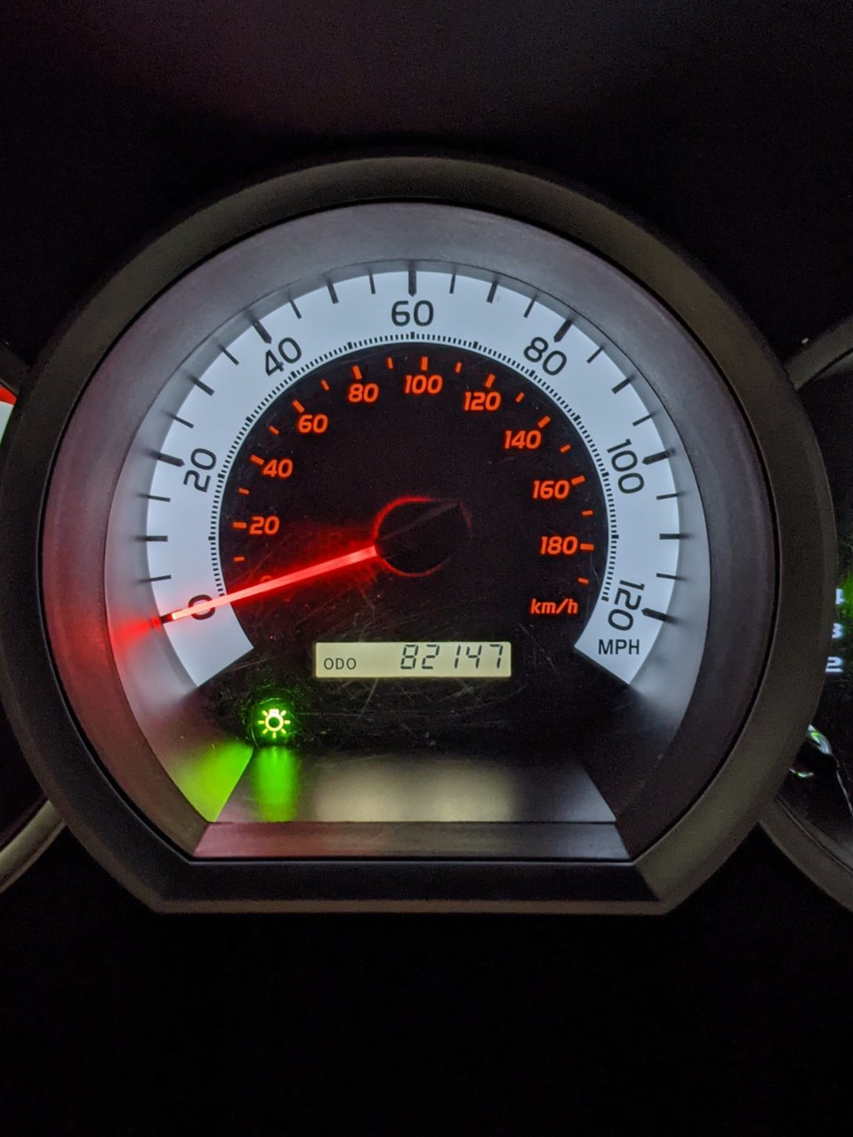

    My 2013 is at 82147, which is pretty low compared to other late model 2nd Gen's that I've seen, but I have a question about parts longevity. From my research and Carfax reports, the previous owner took good care of it with regular service. The truck itself is very clean. What are some mileage/year landmark recommendations for things that may need to be changed out such as fluids, plugs, etc etc. on these trucks? I bought the truck from a reputable dealership who stated they did a full service and inspection of the truck, but you never really know how in-depth they went. My old patrol car was a Dodge Charger Hemi and 75-80k miles is when things start falling apart, but on Tacomas it seems like they're just getting broken in.
