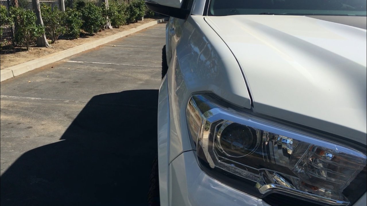

    Hi all,
    In case anyone is wondering. I have just installed Milestar Patagonia 285/70/17 on my 2017 Toyota Tacoma TDR Sport 4x4
    I have Bilstein 5100's all around and the fronts at second from top clip.
    Initial rubbing with mudflap on passenger side right turn. Took mud flaps off and rubbing gone. Also front road squeegee was removed day I got the truck.

    Let us know how you like them. They're on my short list for dedicated summer/off roading tires.
    Can you get a picture in better lighting?
    Looks good as far as I can tell.

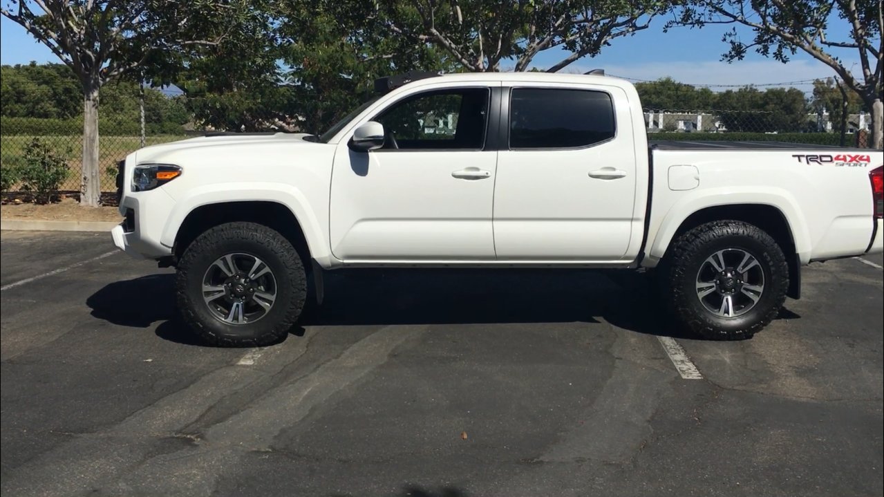

    Side view and how much tire sticks out

    Looks like a great fit. Glad to hear you like them initially.
