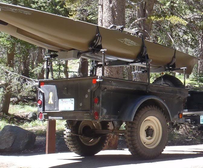

    I have a 1947 Civilian 1/4 ton Bantam trailer that I mostly use to haul around my Hobie Pro Angler. I am the second owner, it was in the same family until I bought it about 10 years ago. I have only replaced the bearings and seals and installed larger 7.00x16 Military type tread tires on the stock powder coated wheels. I also removed the stock ball Fulton hitch and fabbed in a multi axis Max Coupler hitch. It has around 11" of clearance at the lowest point and will easily follow my 4x4 Taco anywhere off road. It is way overbuilt by Bantam, the springs, shackles, bearings, hubs, wheels are all the same as early Jeeps.

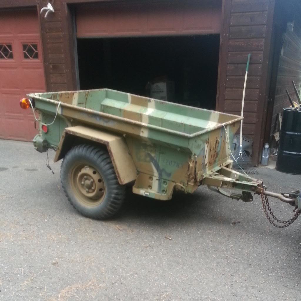

    Here's mine, bought from a coworker for dirt cheap and was offered a heck of a lot more driving home with it. Since I have always wanted one I kept it. Going to be a nice camping hauler.

    Holy bald tires :eek:
