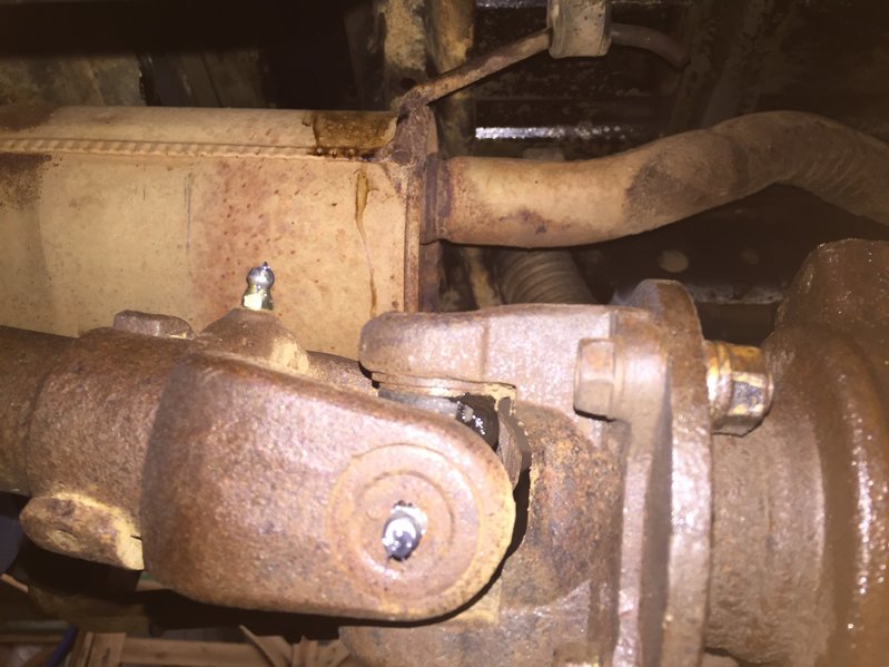

    Replaced a couple grease nipples on the drive shaft.
    3 more to replace.
    In the process I found that the rear end is leaking and I also have a fuel leak I can smell.
    Yippie. More things to fix and document.

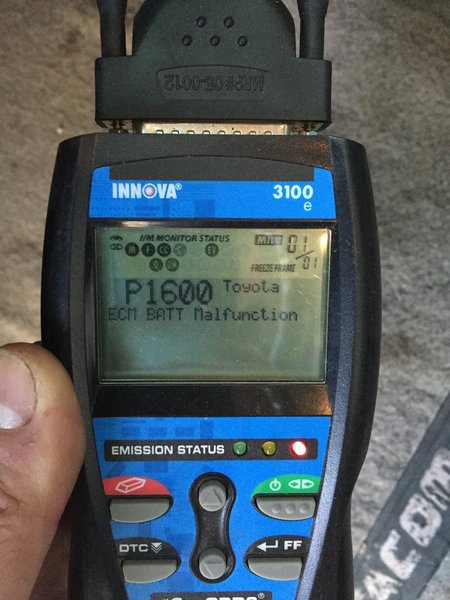

    I've gotten ahold of that document and went through the steps.
    I'll be tracing that wire from the fuse panel to the ecm to see why the fuse is good and there is voltage in and out of that fuse panel but nothing at the ecm.
    Another project.

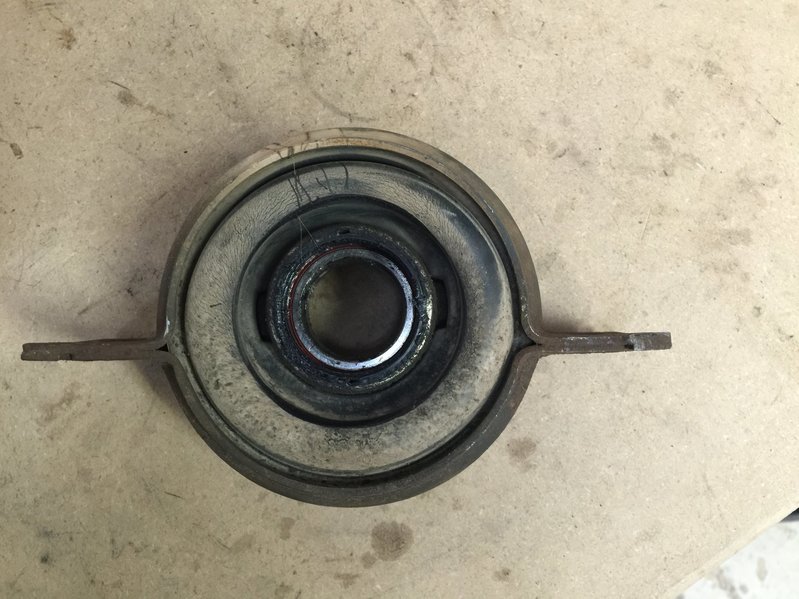

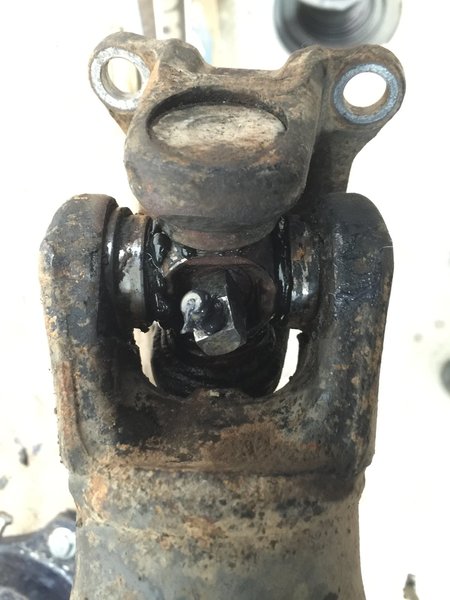

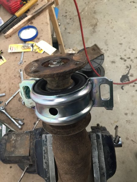

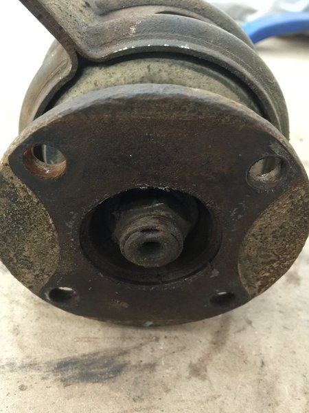

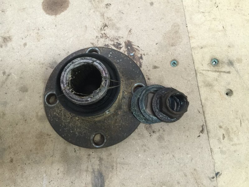

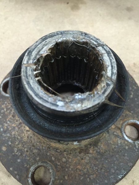

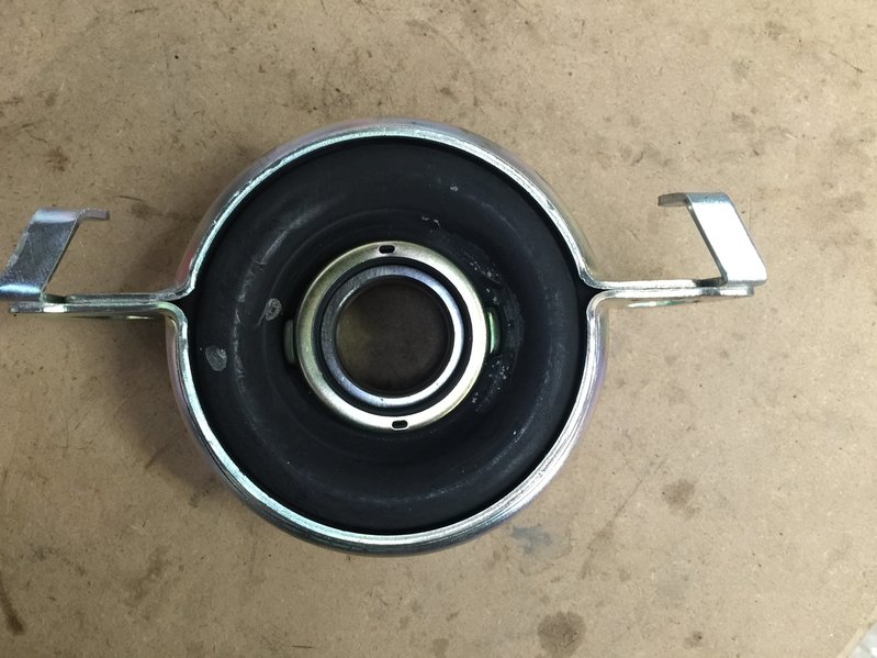

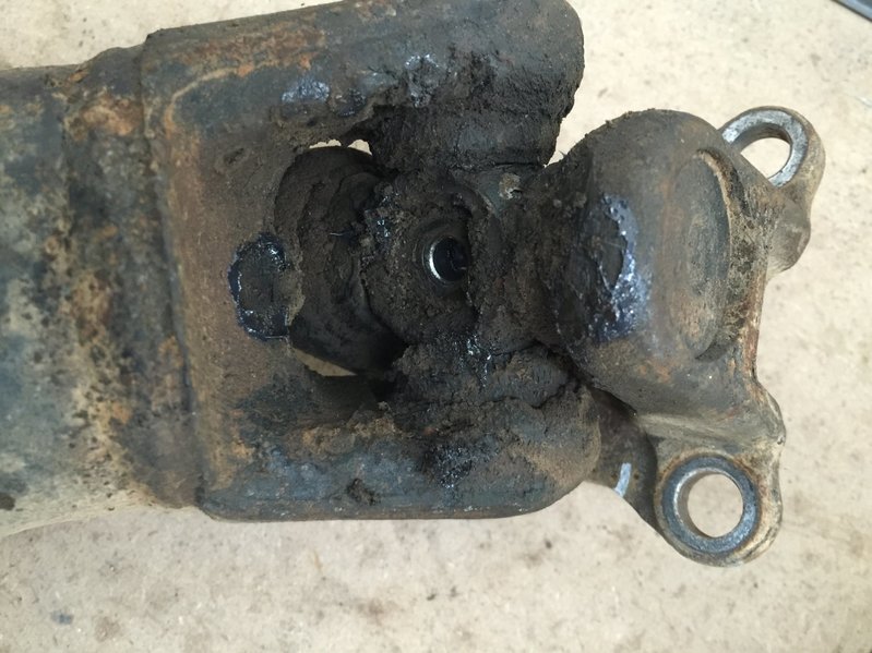

    So I picked up a new Carrier Bearing.
    I pulled the rear drive shafts off the truck to replace the carrier bearing and to clean up the u joints and grease them up.
    I noticed this is not the first time this has been done.
    The nut was not hammered into the tab in the shaft. eeek.
    The gease that was used o the shaft was very farmers glue looking, very stringy.
    I am about to take it out for a ride to see how it reacts. I have removed the 1" or so of stacked washers under the CB to lower it.
    Will report back.

    Ok, so after a drive, it feels different but it's not gone.
    I have to be honest some parts of the drive shaft disconnected where I did not expect and so it was not assembled as it was before.
    Having said that, I have no guarantees that anyone who previously serviced the shafts mantained the same orientation from factory.
    So I am going to try to adjust one shaft at a time, document and see how it reacts.
