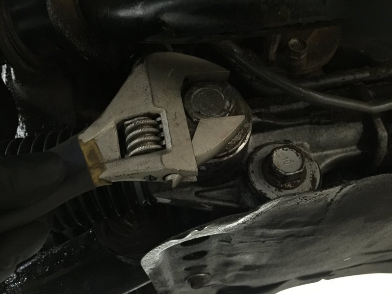

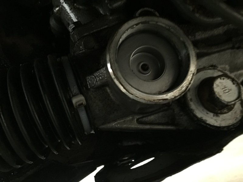

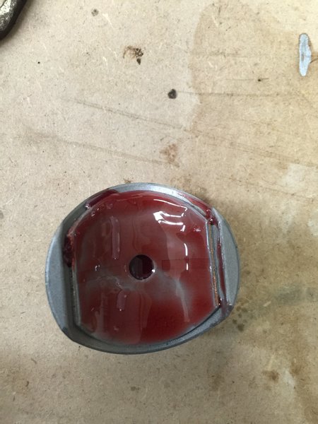

    Parts coming out

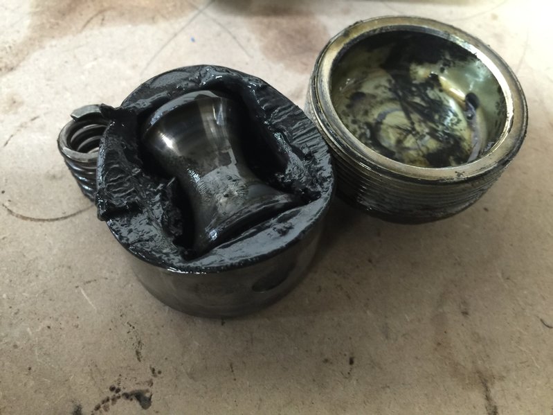

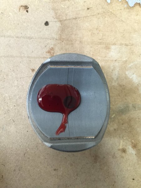

    There was a little bit of vertical play in the hour glass looking guide in the old part.

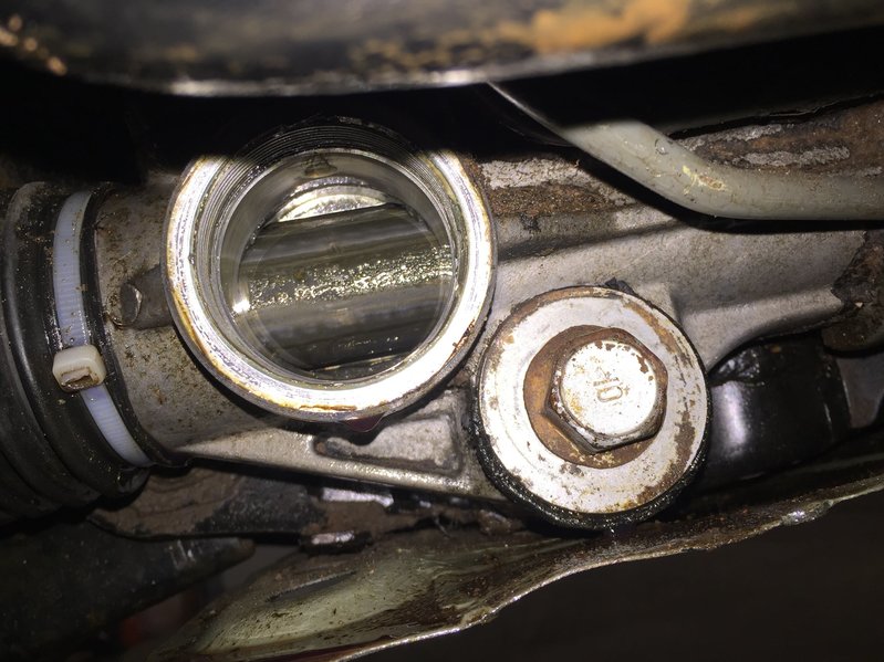

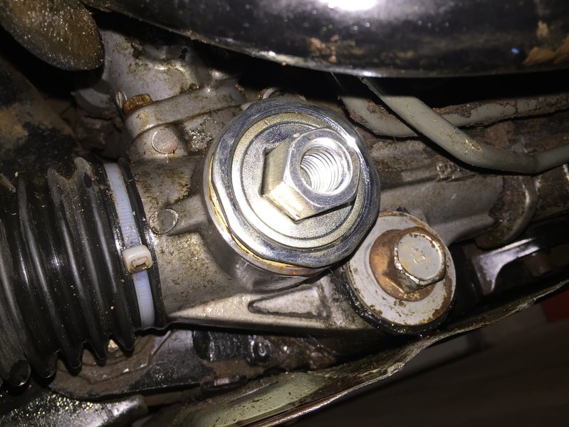

    This is what it looks like without the guide in there.

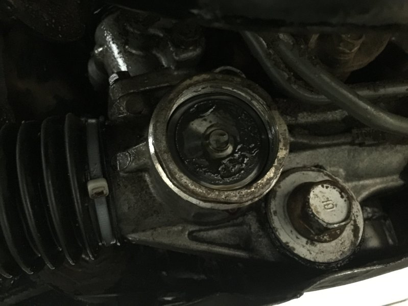

    So I added an engine, transmission etc assembly lube I have had for years to the face of the guide since it is essentially a bearing.
    I also used a couple drops to hold the spring in the place on the i side of the threaded cap.

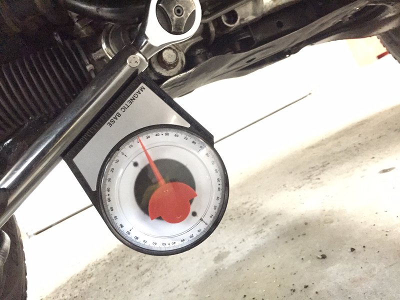

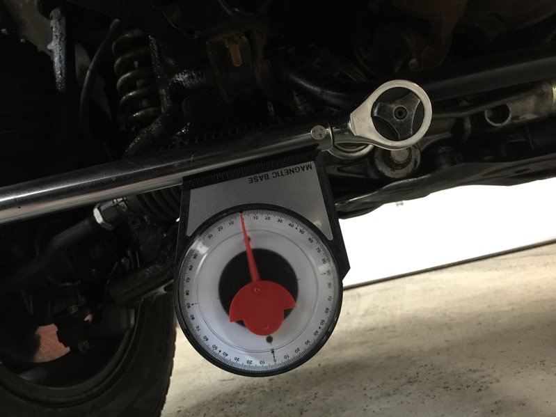

    So I put everything in place and torqued the cap down to 18ft lbs and then backed it off 19* as per Toyotas instructions by means of a magnetic angle finder. (I've ordered a digital one from fleabay but it won't be in until next week)
    After I tightened the ring nut down tight to prevent the whole thing from loosening it's way out.
    I lifted the front drivers tire and pushed back and forth on the tire at the 3 oclock and 9 oclock positions and NO NOISE OR MOVEMENT IN THE RACK!!!
    WOOHOO!
    The final test will be actually driving it but I will report back.

    So after driving the Tacoma home it seems like the clunking is gone!
    All thanks goes to Speedytech7 for his great suggestion and his link to Yukon's how to thread on Yodatech!

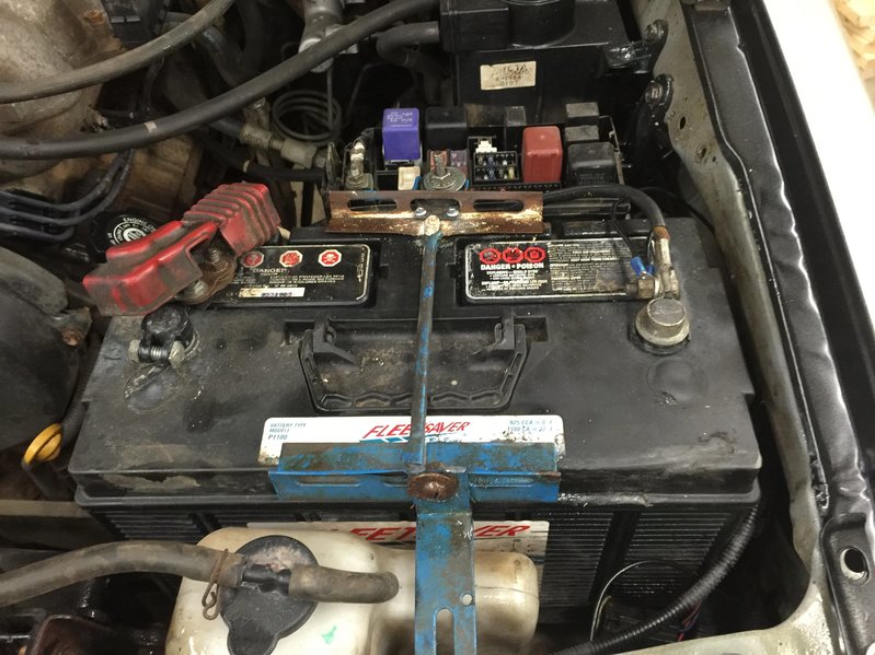

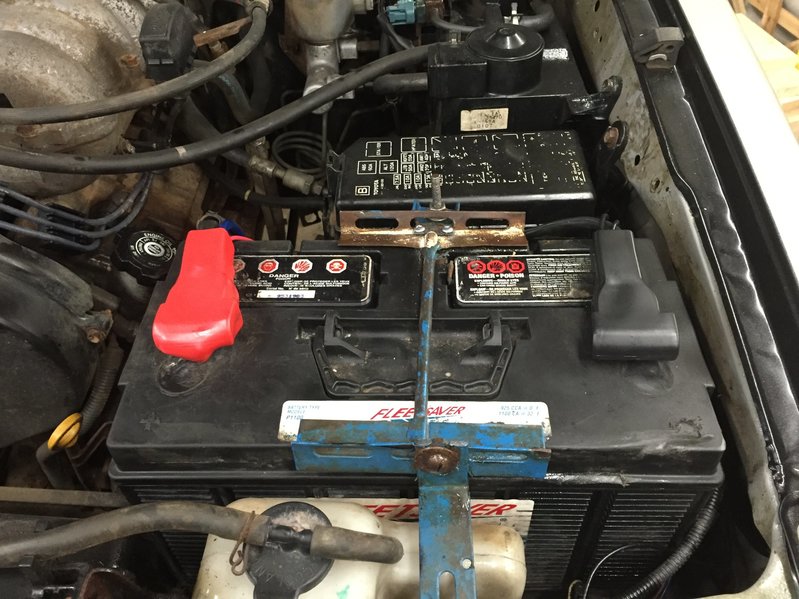

    Had to extend a power wire that feeds the fuse box under the hood (not sure why) and then tidied the wiring on the battery.
    A before and after is included.
