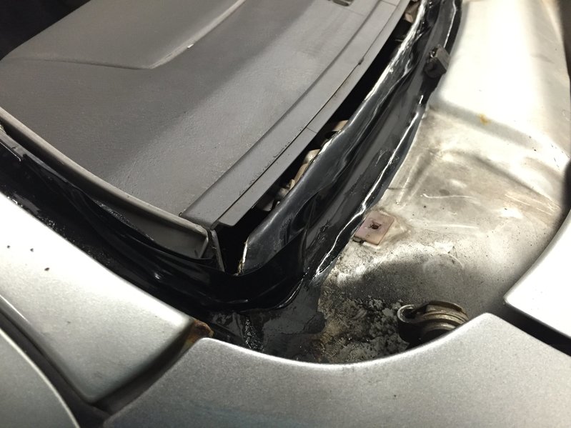

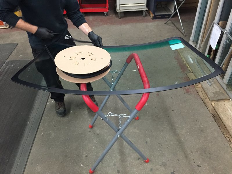

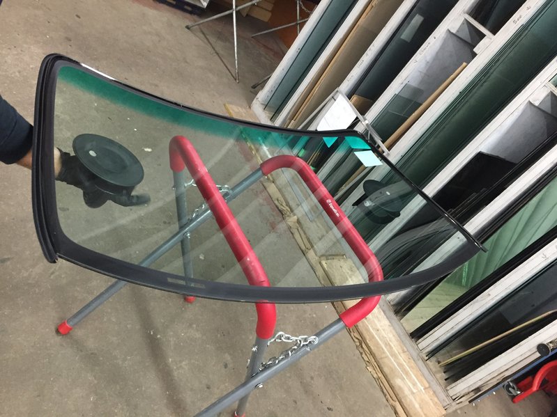

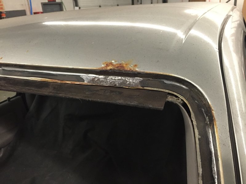

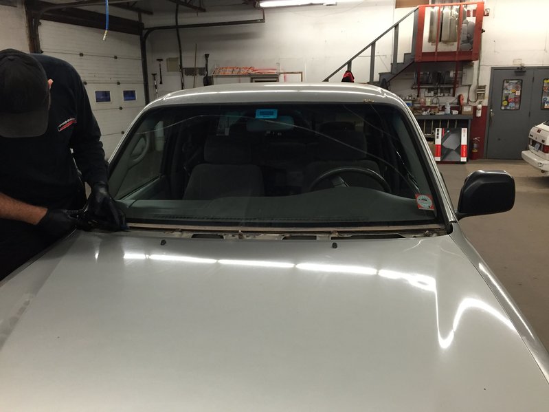

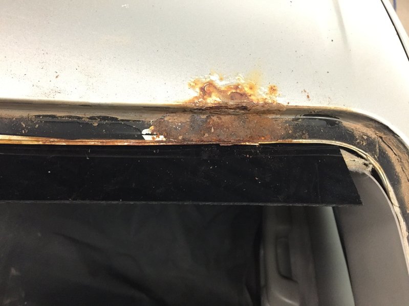

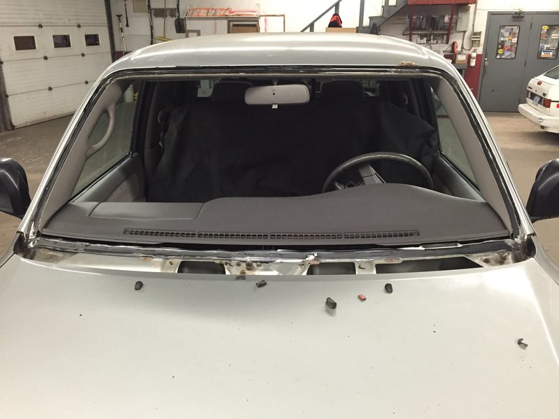

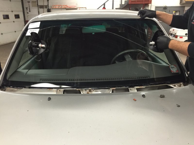

    I had my Windshield replaced this evening.
    My brother in law works for speedy auto glass so he hooked me up!
    Not super exciting but some of you may enjoy the process so I thought I would document it.
    Below are pictures of the various steps.
    -Old windshield being prepped for removal
    -Using a resip with a special attachment
    -Old windshield out
    -Rust in the top right is the cause of the crack
    -Removing the rust
    -After removing all the old adhesive an activator is applied
    -Primer is applied
    -Windshield prepped with moulding & activator
    -Adhesive is applied in a V shape
    -New windshield, spacers added at the bottom to align it until it cures, tape was also added along the top to help it stay put.

    At first, I though the new windshield was cracked as well, due to the reflection of the ceiling lights...hahahaha

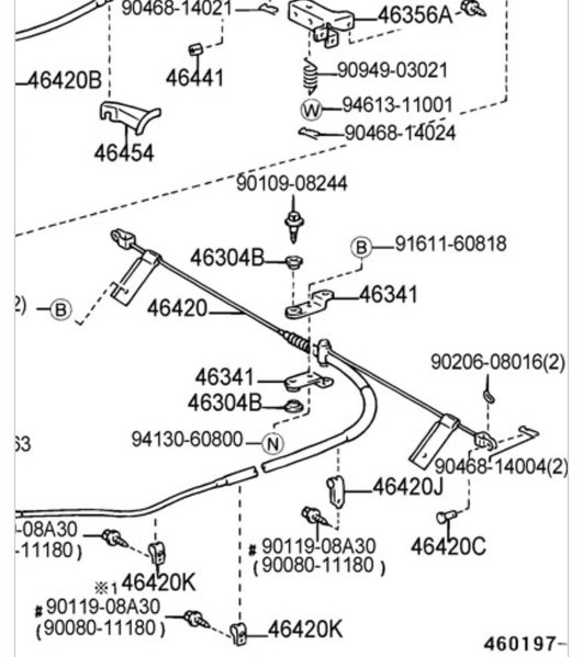

    Last night I pulled the rear brakes appart and soaked what needed soaking in oil.
    The adjusted was seized in every way possible. I didn't have a torch to heat it up but with lots of Release-All (something like PB Blaster) and patience I was able to work the peices appart, clean it up, lube it and get it all back together.
    Where the parking brake cable bolts to the bracket on the rear axle there are suppose to be two bushings that fill the space between the bracket and the bolt.
    On my truck, they were missing.
    I have ordered them from my source at Toyota.

    The parts I am refering to is 46304B

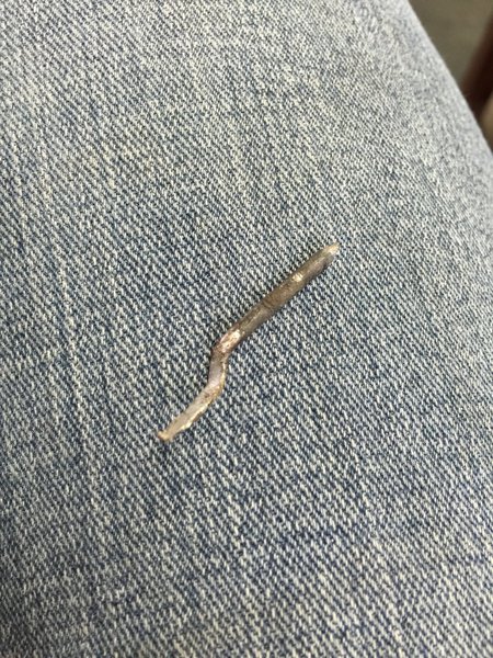

    Had the truck in for a leaky tire.
    Found this.
    The aluminum nail, not my leg.

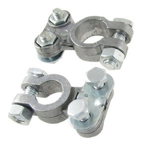

    And yet another update. The battery may not have been the issue....
    I had the exact problem again today lol
    I tried all sorts of things including boosting, still nothing.
    This time I had my multimeter on hand from the start and the battery voltage was good the whole time.
    Turns out one of the battery terminal connectors that the truck came with was not factory, it was tight on the battery post but the bolts that fasten the cables to the terminal connector was loose so it wasn't making a tight connection, it had enough current to click the solenoid but not enough current to crank the starter over. Lesson learned.
    And the reason boosting it was working was that when I clamped the cables to the battery I was grabbing the large starter cable on the battery terminal and getting a good connection from the boosted vehicle to the started directly.
    I'm suppose to know what I'm doing but sometimes I surprise myself with my fails.
    A picture of the style battery terminal connector that is on on of the posts, I'm going to change it as I hate it.

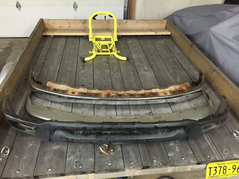

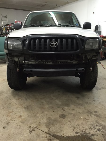

    At the shop today looking to improve the look of the front bumper.
    I pulled it all apart, lots of hardware to replace!
    Looking to prep the black bottom plastic piece and spray it black, clean up the chrome middle piece and spray it black and then clean up and prep the body colour top piece and spray it the same color as the fenders.
