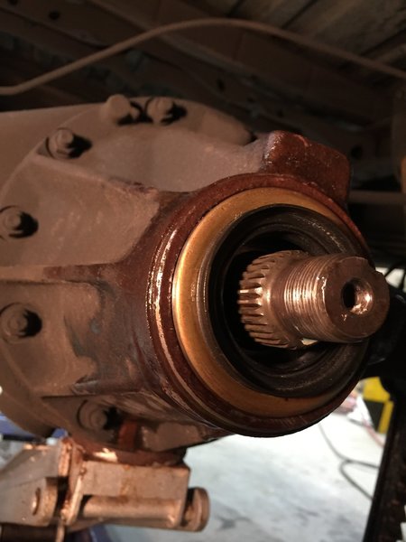

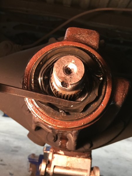

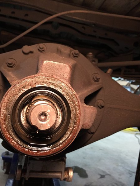

    So, a bit of an update.
    Pretty cranky here.
    1. I've replaced both font axle seals and the passengers side axle seal is leaking profusely, you can sit there and watch it drip out just sitting in the shop.
    2. I've done the front diff drivers side axle needle bearing replacement with the ECGS Bushing and the front end vibration is still there as fierce as ever. I can get under the truck and push up on the axle right next to where it enters the front diff and there is the same amount of play in the axle as there was before the bushing was installed.
    I can even rock the truck from side to side by pushing on the driver front tire and that axle clunks as it did before the replacement.
    3. I've replaced the rear diff pinion seal and it is still leaking also.
    Really disappointed in all of this and I was contemplating giving up. Seems silly I know but the fundamental things need to be solid for me to continue improving this truck. So much money and time invested and these things are not helping me feel that I've progressed with some serious issues that the truck has.

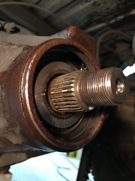

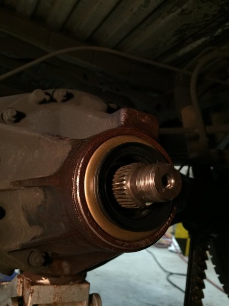

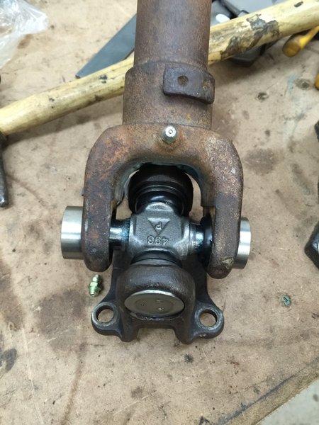

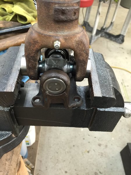

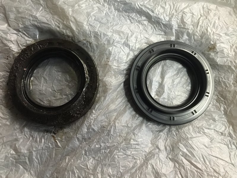

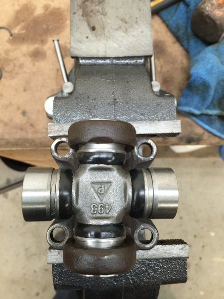

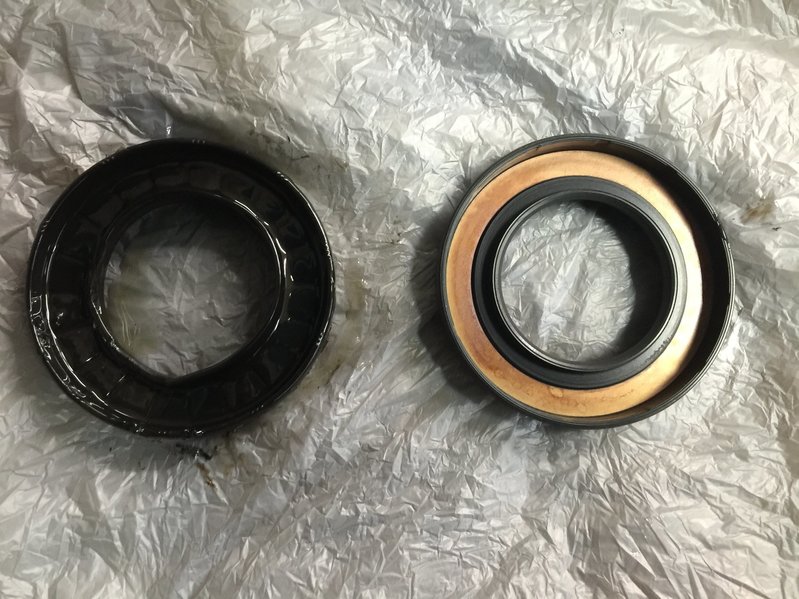

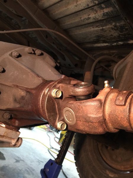

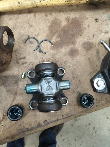

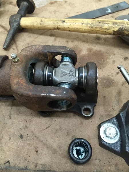

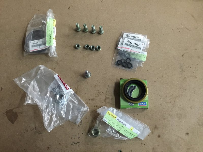

    Hear are some pictures of the new and old parts.
    I had found a pretty stripped bolt in the bottom of the passenger side strut.
    I replaced the rear diff pinion U Joint as there was some play in it.

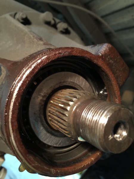

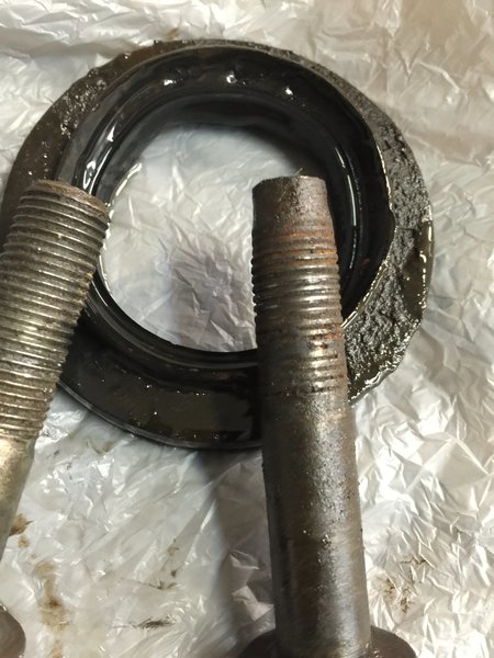

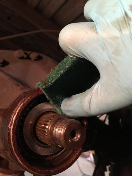

    Installation Reference Followed
    If you look at the pictures in the next post you'll see the rust build up that I tried to clean up with a scotch bright pad and then sand paper. After looking at these pictures I noticed a smooth surface was not achieved. The outside of the seal is just steel so if both surfaces are not tight I think that may be why the leak is happening. I will have to pick up another seal and remove the one I just put in and do a better job cleaning up the surface and reinstall it.

  6. Dec 26, 2015 at 3:29 PM

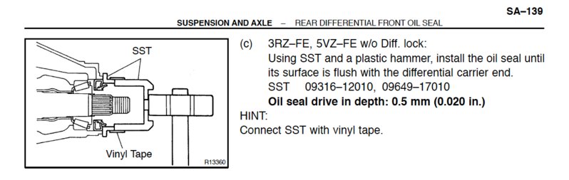

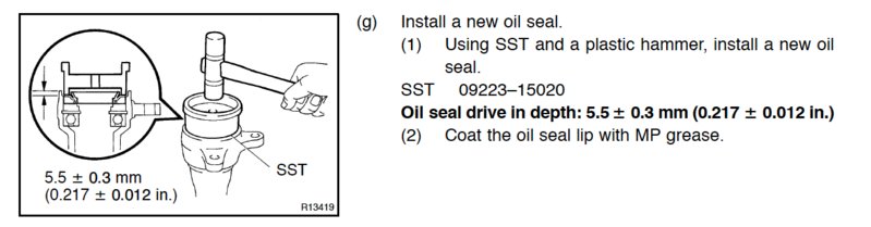

    After looking at the directions for the Passenger axle seal I only installed it flush not resecced 5.5mm as the attachment shows.

    So I pulled the passenger side apart and tapped the seal
    In a bit further and put everything back together. After lowering the truck off the stand and letting it sit it is back to leaking.
    I will see what more research comes up with.

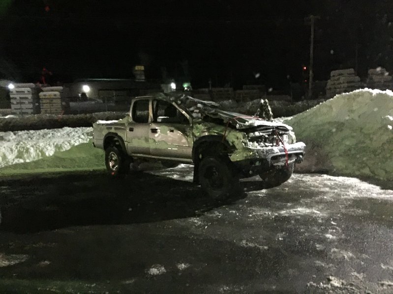

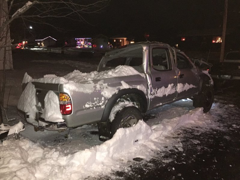

    So...I've aquired a parts truck...
