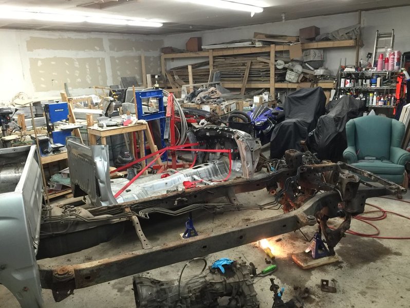

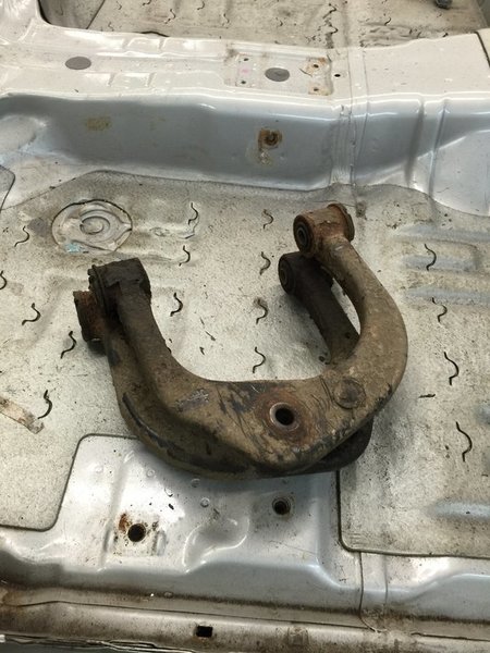

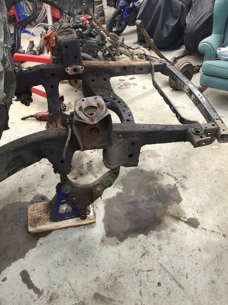

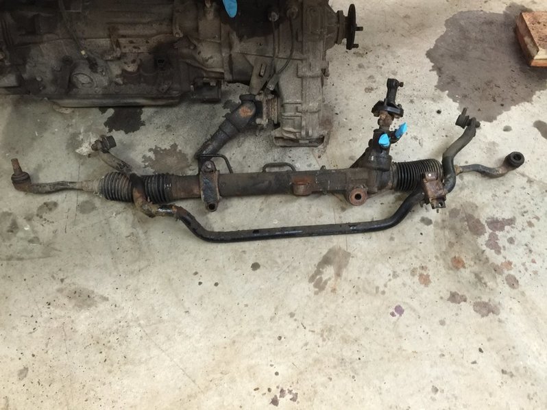

    Update onthe parts truck.
    Got the power steeringrack out.
    Removed the front brake lines.
    Pulled the sway bar off.
    Upper control arms are out.
    Lower control arm bolts are out but 3 of the 4 bushings need to be pressed out.
    Front strut assemblies are out and apart. Springs will be cleaned up and re-used, struts are garbage.
    Now for pictures

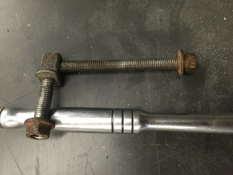

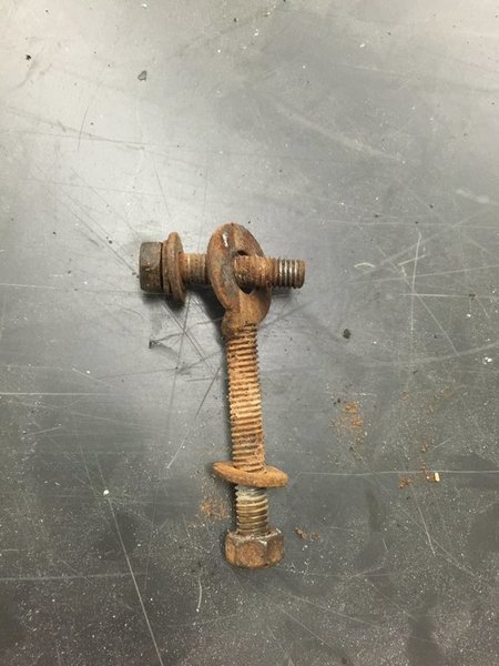

    I thought for sure the issue was the power steering belt, and maybe it was also however after StAndrew gave his suggestions and thougt it had to be a loose or bad belt I thought, dude, you totally dismissed the alternator belt! (I'm not running AC at the moment)
    I found the alternator belt to be loose. And, like the power steering, the tension adjusting harware was jimmy rigged.
    So many face palms with this truck.
    I pulled off the hardware from the spare engine, cleaned up the treads with a wire prush & Tap and Die set.
    No more squealing.
    So many problems I encounted the customer falls in the trap of thinking it's something really complicated causing the problem and often it isn't. I seem to do the same thing sometimes.
    All these experiences can help keep us humble eh? lol
    Pics of the old and current alternator hardware.

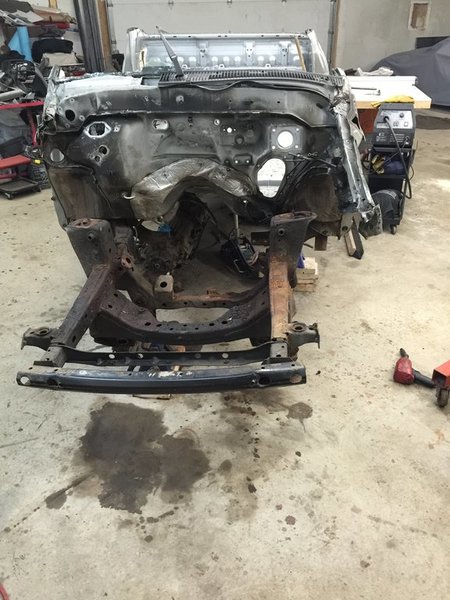

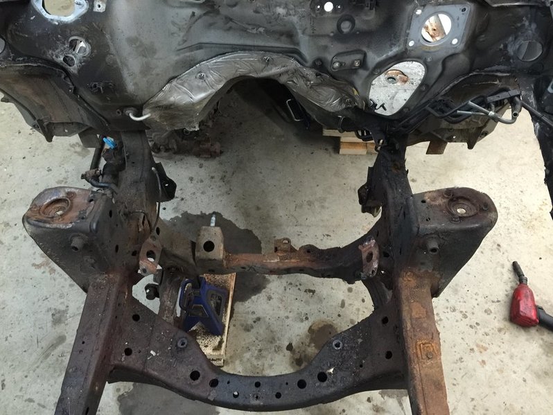

    Removed the body this evening.
    Yeah, this thing is getting smaller and smaller.
  11. Jan 23, 2016 at 4:39 PM
    #411
    EB Group
    EB Group [OP] Carbon Jedi
    Jul 14, 2015
    #159469
    1,406
    Rudy
    Halifax
    2017 TRD Sport DCSB 6M

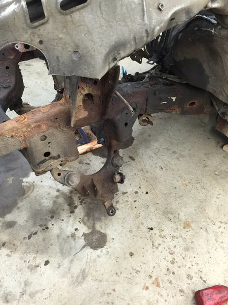

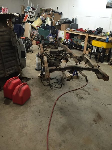

    I turned around and we're almost down to a bare frame.
    I have someone interested in the rear portion of frame. It actually looks usable. The crap toyota sprayed on frames they did not replace is flaking off everywhere so the metal looks pretty scaled but it's actually solid.

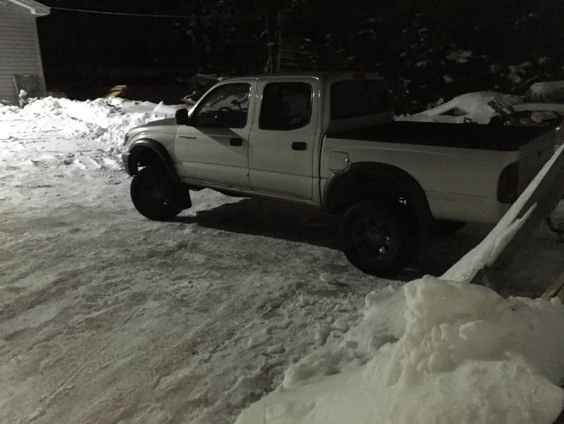

    I know many of you guys and gals have snow this time of year but I thought I'd share a picture of our rink/parking lot.

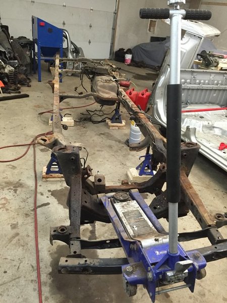

    So I no longer have a parts truck.
    I just have parts!

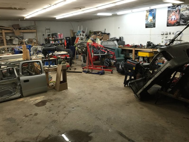

    The parts are clogging up my shop and cramping my style a bit. First world problems.
