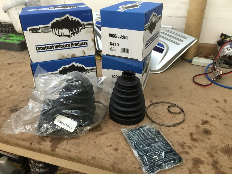

    Picked up a couple of Moog CV Boot kits.
    Now to actually do them!

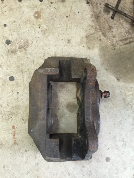

    Been smelling some exessive brake smell and noticing more than usual heat from the drivers calliper. One of the four pistons were stuck in this position holding the pad on the rotor.
    Replaced the calliper with one from the parts truck. Seems to be ok for the time being.

    Good thing it wasn't seized too bad. I had a caliper seize up good and tight on my 1980 Tercel. It always pulled hard one way but that morning it was pulling much harder but I was late for work and figured I could get an alignment later that day. It got real bad on the free way so I took an exit and as I was slowing down, smoke was POURING out of my driver side tire well. I thought the car was on fire (as did at least 10 other drivers that called 911 :facepalm:).
    Caliper was glowing red in the early morning light.

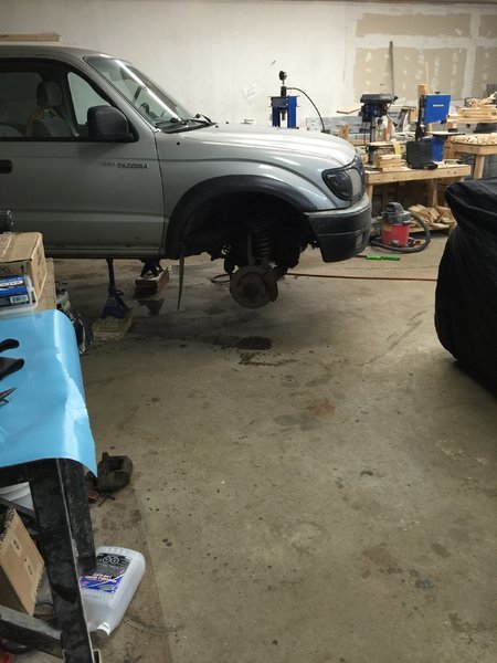

    In the shop,finally making the time to rebuild those cv's.
    Step one...

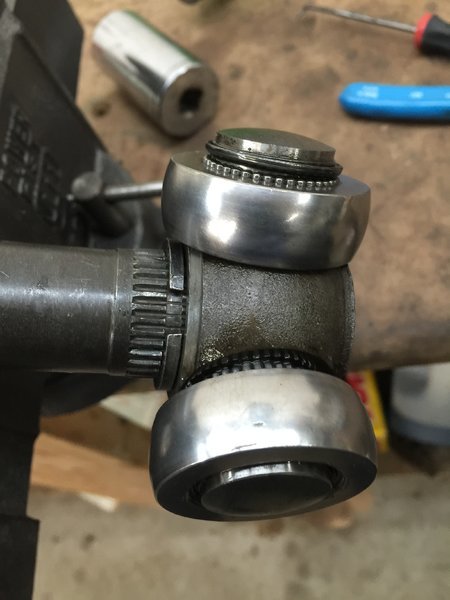

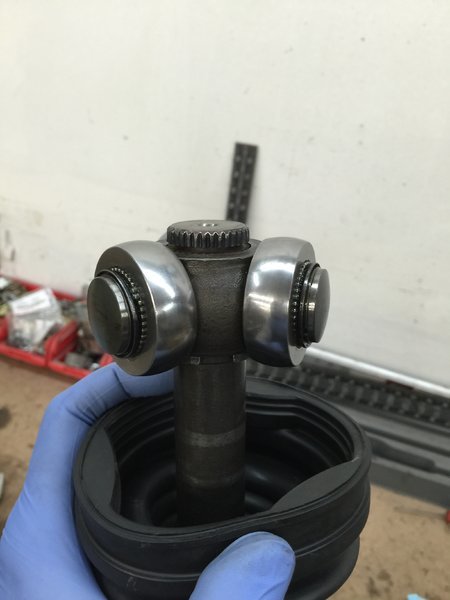

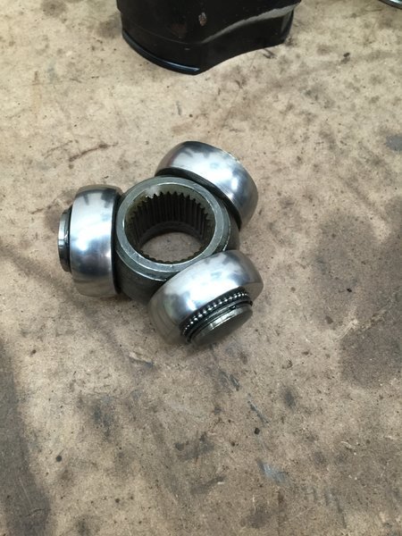

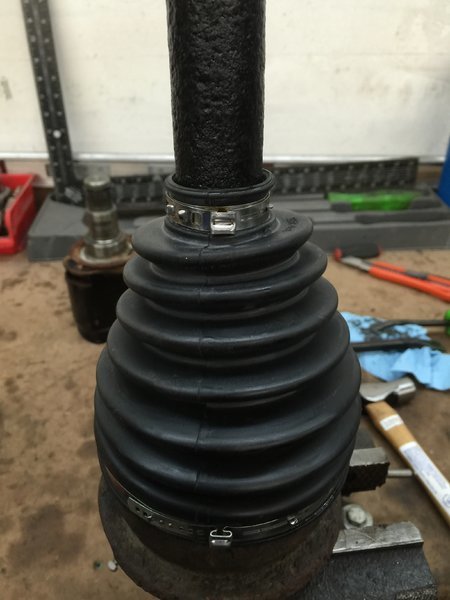

    I noticed a difference in the dismantling procedure in the instructional videos on page 20 of this thread and what needs to be done with 1st gen cv's.
    You have to pry the clip below the tulip and pull it down far enough to allow you to tap the tulip down the shaft far enough to expose the retaining clip. I used a 1" socket to tap it down.
    After removing that you will be able to get the tulip off.
    In the third picture the tulip has not been tapped down out of the way to reveal the clip.

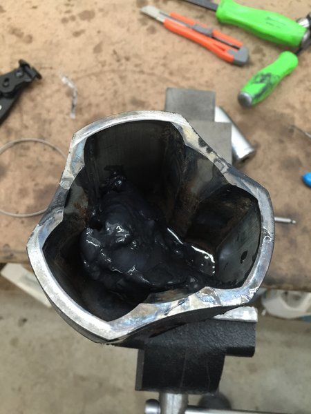

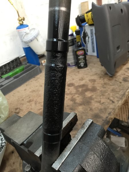

    Yesterday I sandblasted the part of the axle shaft that is exposed to the elements as it was a bit rusted. I painted it black and let it sit over night.
    Today I assembled the passengers side axle.
    I forgot to mention that I just took one axle off the truck at a time and work on it until complete.
    I've attached some pictures of the reassembly steps.

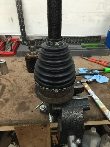

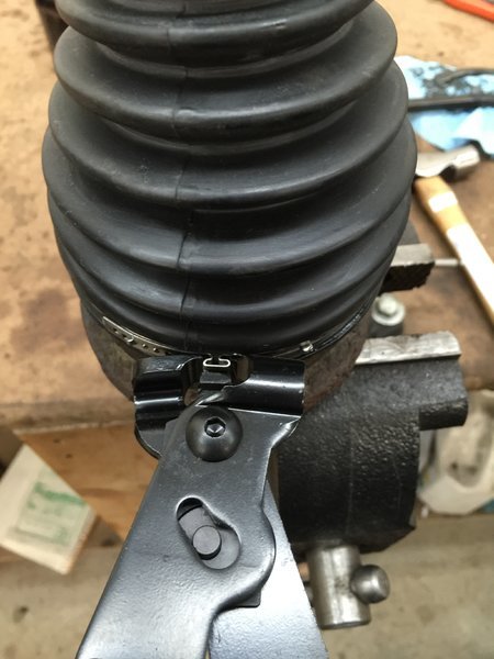

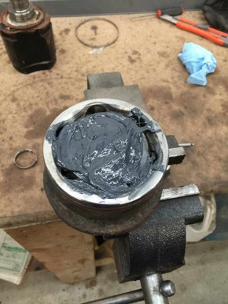

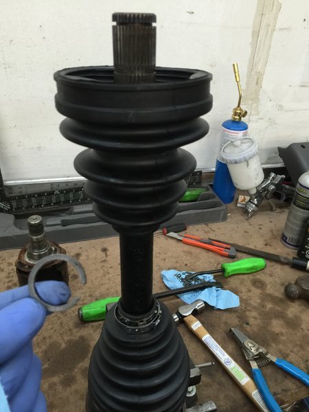

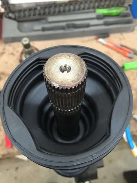

    Some pictures of reassembling the inner side of the passenger axle.
    The boot for the inner cv is a very tight fit so I removed on of the cetaining clips to give the boot no obsticals to getting on the shaft.
    Next the clip went on.
    Then the tulip was slid on farther than it needs to so the ring clip can go in.
    Then the tulip is slid up over the ring clip and the renainer clip is put back in place.
    The ring clip needed to be comoressed a bit to allow the tulip to get into place.
    Then I put the grease that was supplied with the boot kit in the cup and assembled the rest of the axle and crimped the boot straps.

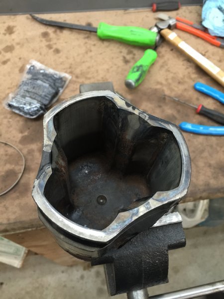

    The drivers side axle went the same way until it came to getting the burfield off.
    I was unable to get it off so tomorow I'll return the boot kit and buy a replacement non toyota axle.

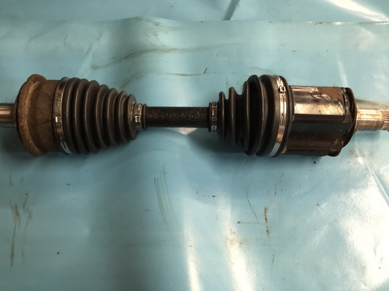

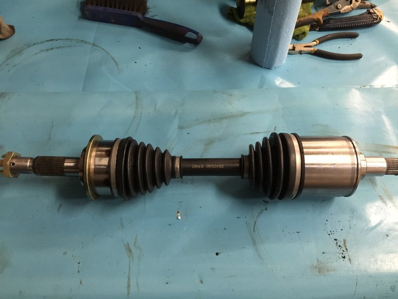

    1,406
    Rudy
    Halifax
    2017 TRD Sport DCSB 6M
    I picked up a new aftermarket axle this morning. Pretty nice axle as far as axles go. I wouldn't hang it on my wall or anything but it looks good.
    I also drained and refilled the auto tranny fluid. I fugure doing it several times ensured most of the old fluid us gone.
    I'm sure this is not normal but I noticed that the front truts do not compress. That's probably a reason why the ride is so crappy and the ball joints and what not keep getting beat out.
    Time to lose the lift and go back to stock.
    I might lift it again but nothing I do would benefit from the lift, it's just cosmetic.

    Issue 1 Solution: Replace the axle I rebuilt with a new/rebuilt (by a pro) one ($53).
    Why? In the disassembly process I discovered that on of the retaining clips was broken, with no time to get one from the dealer I fashioned one and hoped for the best. We've come to the conclusion that hoping wasn't enough and that clip is not holding the axle together as it should resulting in some wobbling and thus vibration.
