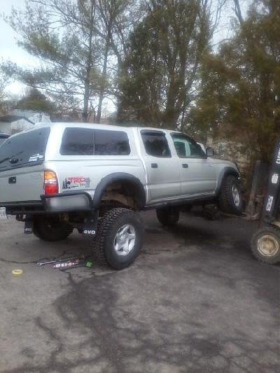

    A picture of me doing it; mostly to show off :D
    EB Group[QUOTED][OP] likes this.

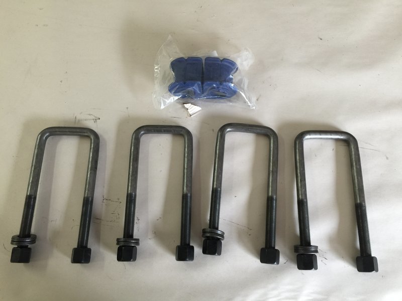

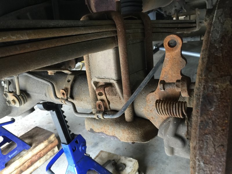

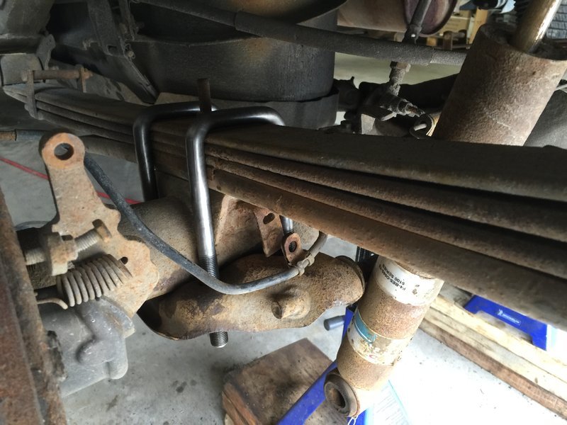

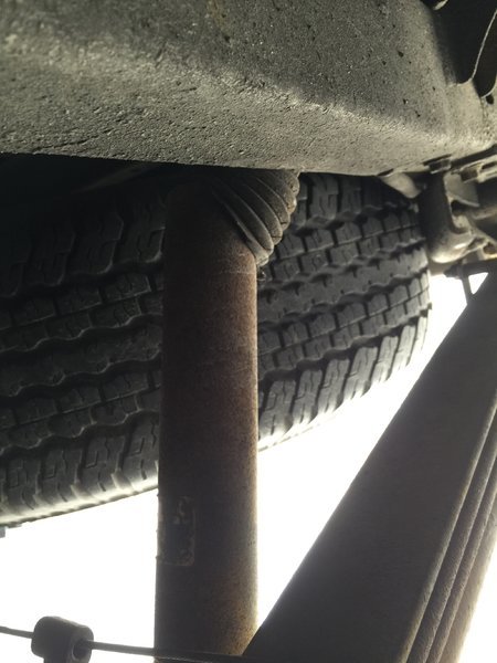

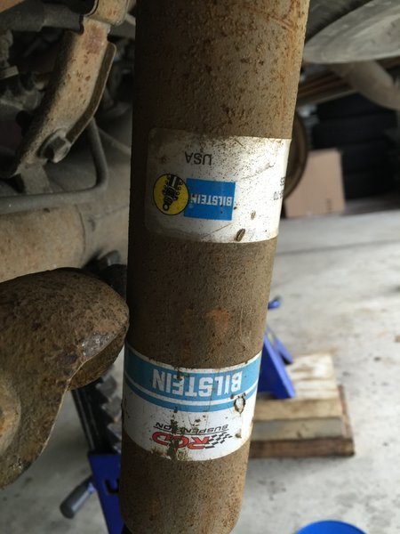

    I picked up some new u bolts and hardware because I'm going to tackle removing the lift today.
    Thank you St.Andrew for schooling me on how it's all layed out. Now that I understand how the lift works I feel completely confident in removing it and ending up with a regular height Taco.
    I'm including some up close pictures of the leaf pirches before and after.
    In doing this I discovered the drivers rear shock is doing nothing. lol
    Could have guessed that by the beat up state it is in.
    I'll include a couple picks of that.

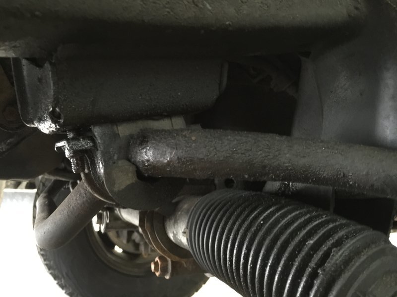

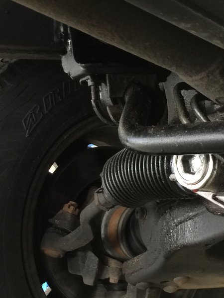

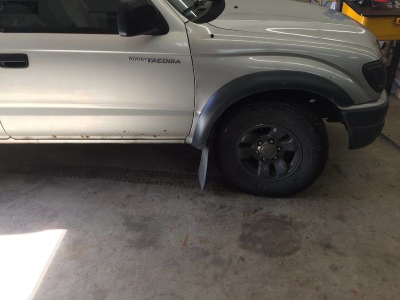

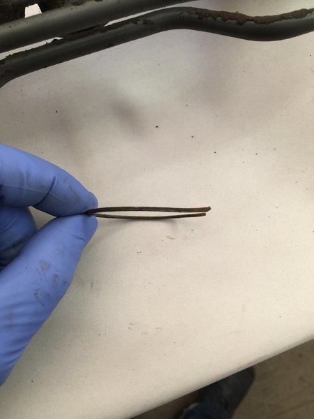

    I removed the toyotec springs in the front and installed the stock toyota ones.
    Everything looked great.
    Got to the end of the driveway and bam!
    Right front corner drops.
    The retaining clip for the spring perch let go.
    Needless to say it's back in the shop and I'm trying to decide what to do.
    Order a clip from bilstein which will take 2 weeks.
    Buy a strut and get a clip whenever I get around to it.
    :facepalm:

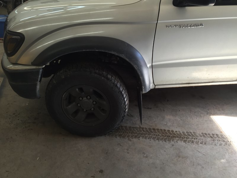

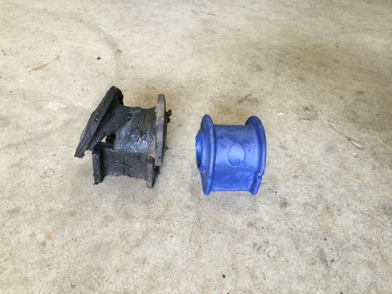

    I was able to replace the sway bar bushings.
    What a difference!

    I've emailed bilstein usa warranty.
    I've ised that intl contact form you provided a link to to explain my situation.
    I am going to go to some local small engine repair shops and see if I can match up a piston ring to the clip I have and use it.
