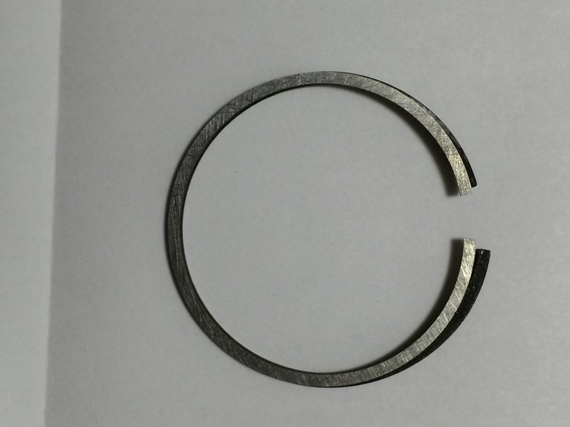

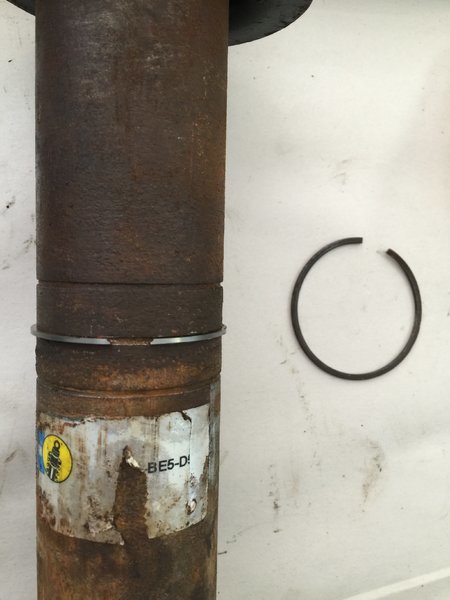

    I have heard back from Bilstein US.
    They will not warranty either product because both shocks/struts are RCD specific part numbers.
    They provided me with RCD's number.
    I don't think I am going to fight this one.

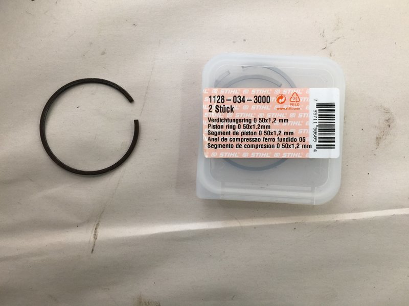

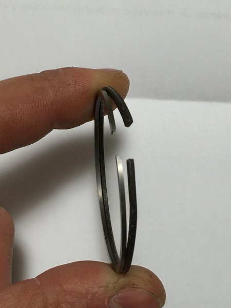

    I did find a solution for my broken snap ring.
    I found a stihl piston ring that could match up. I found a local dealer that had them in stock. I went over and it was a perfect match.
    Got back in the shop, removed and disassembled the strut again.
    Cleaned up the ring land that I was going to use and carefully installed the ring.
    It did require a few spins to truly seat itself firmly.
    I am confident this will be reliable but time will tell.
    Here are a few pics

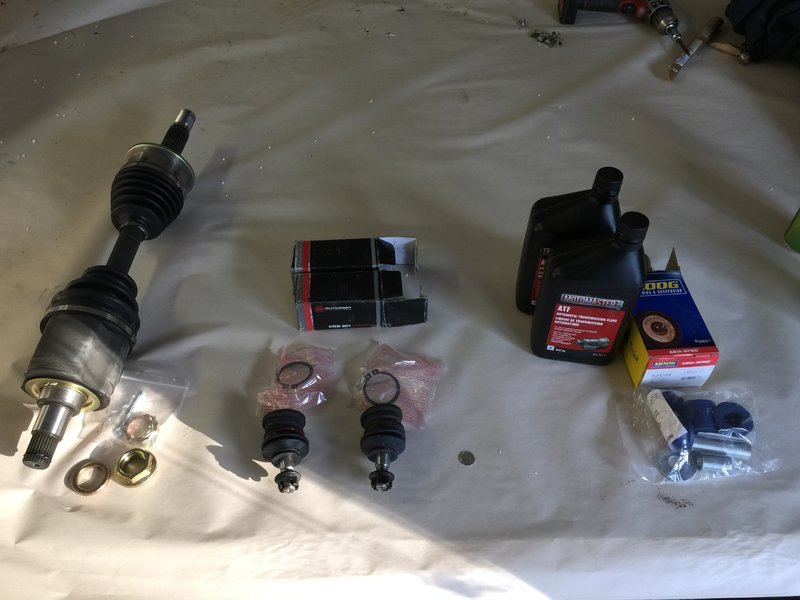

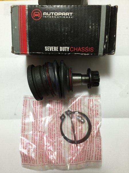

    Next up is passengers axle, both upper ball joints and piwer steering rack and bushings.
    My $6.63 CAN closeout balljoints arrived today.

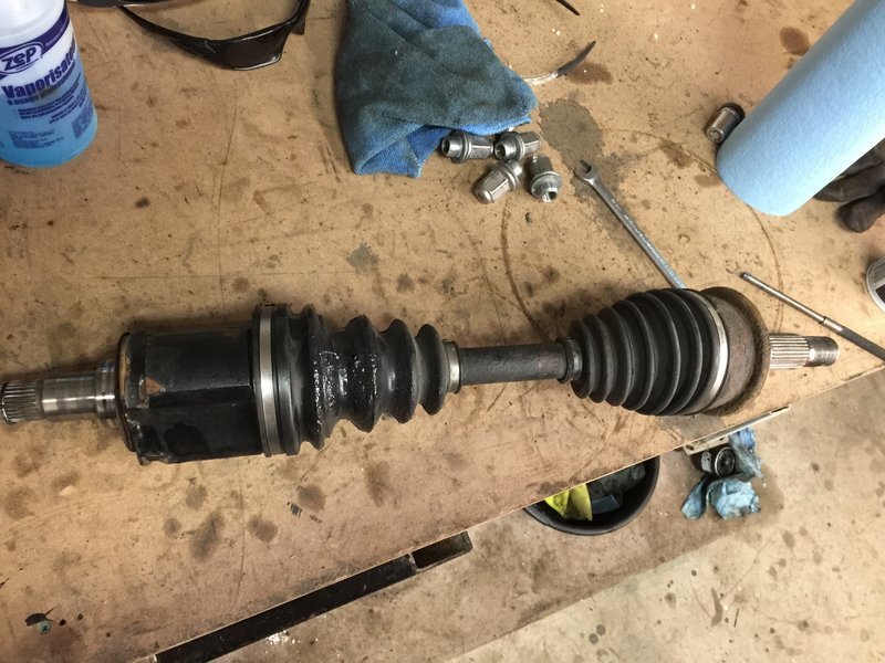

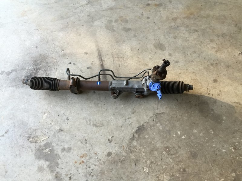

    It is time to do some work!
    Power steering rack swap
    Power steering rack bushings
    Both upper ball joints
    Passenger axle
  8. Apr 22, 2016 at 2:59 PM

    Cool. What's the deal w/that rack - looks a little used.
  9. Apr 22, 2016 at 4:21 PM
    #509
    EB Group
    EB Group [OP] Carbon Jedi
    Jul 14, 2015
    #159469
    1,406
    Rudy
    Halifax
    2017 TRD Sport DCSB 6M
    It's the working non leaking rack from my parts Tacoma. Yes it's used but in better condition than the one on the truck atm.
    And that's after I cleaned it. That looks good for being subjected to salt and snow!

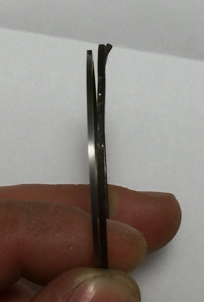

    Update
    The axle clip did fail.
    Pics of normal and me able to pull it right out of the cup.

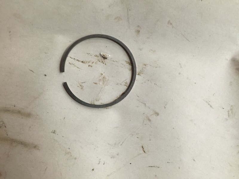

    Remember this?
    It's now this:

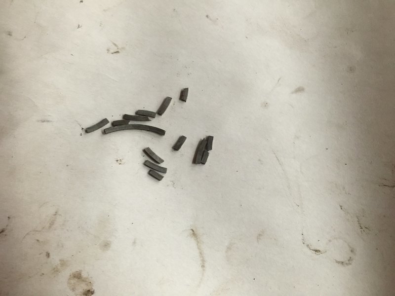

    From the CV or the shocks?
  20. Apr 22, 2016 at 7:58 PM
    #520
    EB Group
    Jul 14, 2015
    #159469
    1,406
    Rudy
    Halifax
    Shocks. Front Passenger Strut that I fixed up earlier.
    Who called it? You
    While I was dismantleing to replace the axle and upper ball joint I happened to notice that the spring pirch was not sitting in there quite straight. So, I pulled the assembly out and carefully compressed the spring and disassembled it, and all those pieces fell out.
