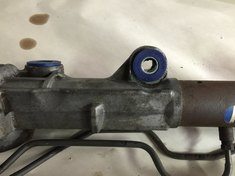

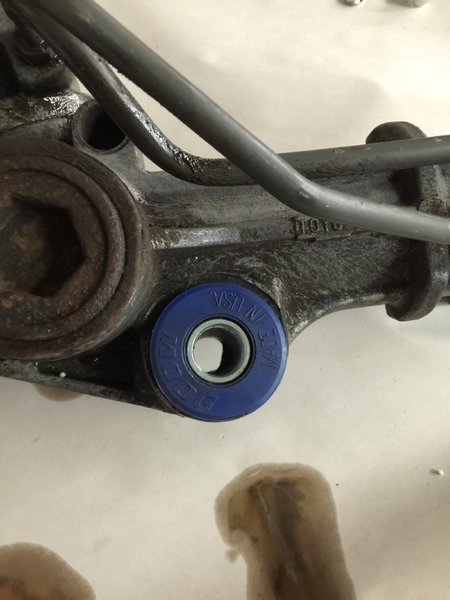

    Power Steering Rack Bushings installed.

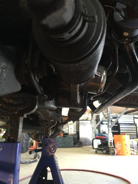

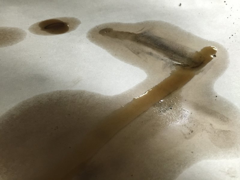

    This regular looking power steering fluid has been leaking out of the replacement rack since removing it from the parts truck. I understand that dex II or III ATF is the only fluid our systems can use.
    Why would this have been used without an apparent problem?

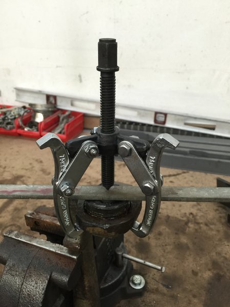

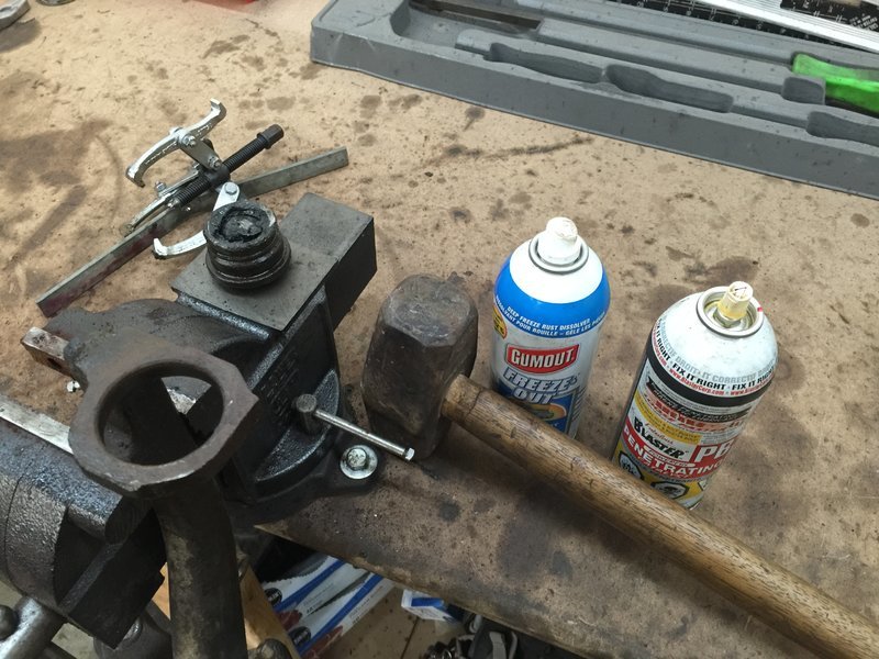

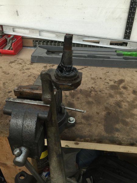

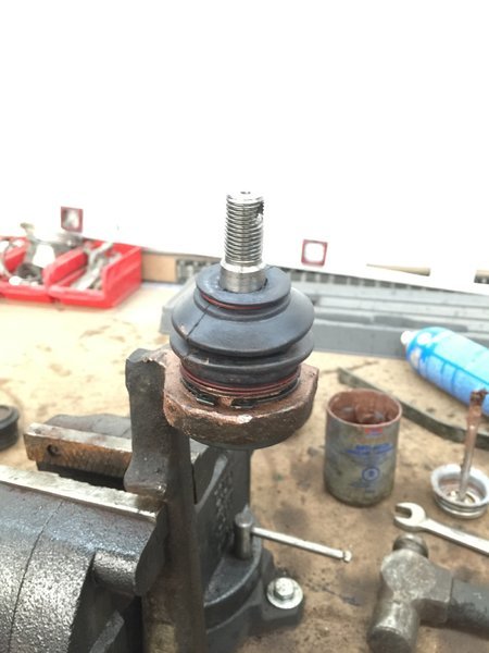

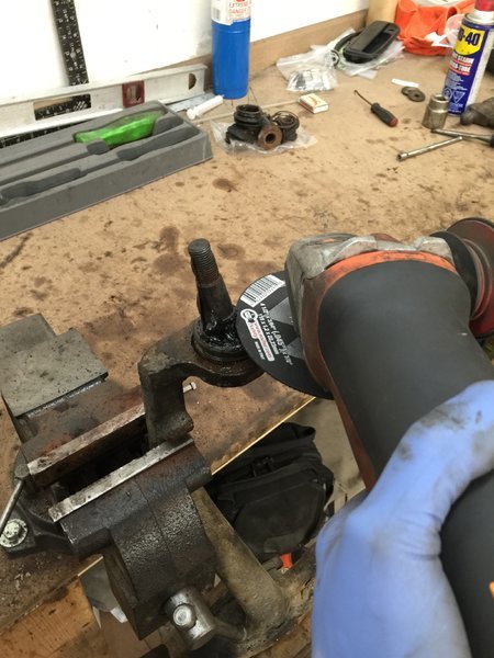

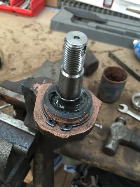

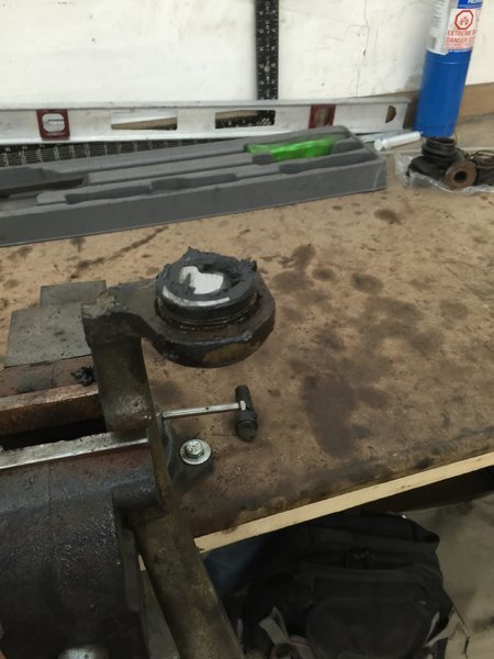

    The process of removing the old UBJ and installing the new one.

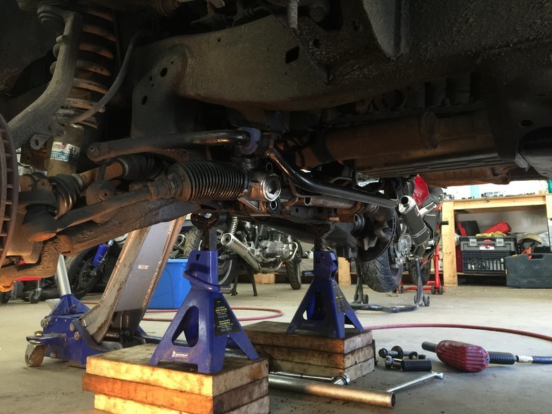

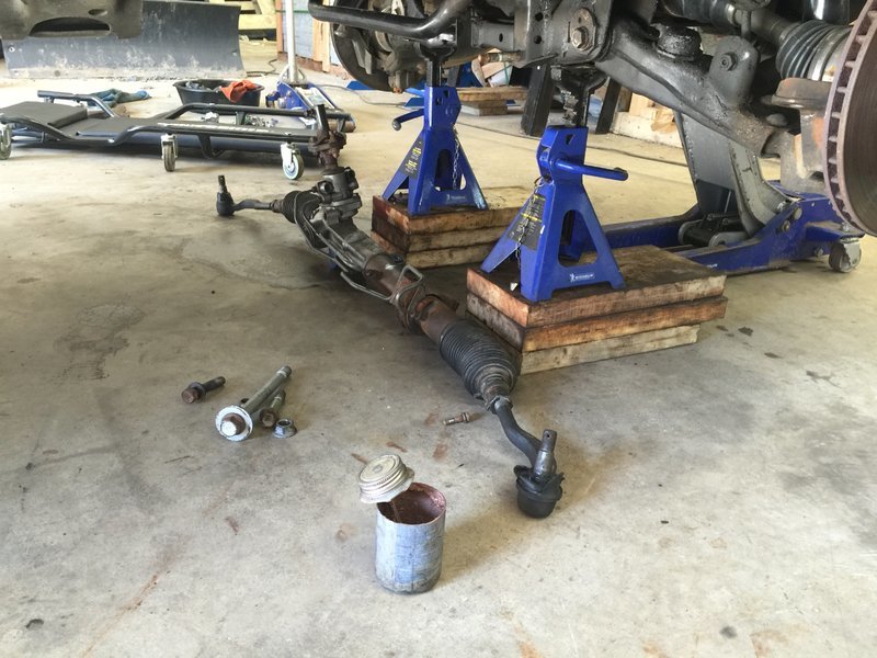

    Today I am swapping the steering rack. I have been putting this off like the plague.
    So far all bolts and nuts removed with zero issues.
    I have the PS pump in and out lines, OTRE and Steering left to go.

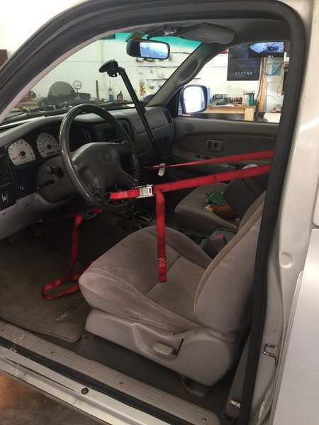

    Is that for backseat driver steering?
  14. Apr 25, 2016 at 11:08 AM
    #534
    EB Group
    EB Group [OP] Carbon Jedi
    Jul 14, 2015
    #159469
    1,406
    Rudy
    Halifax
    2017 TRD Sport DCSB 6M
    Yup and it doubles for a 5 point harness.

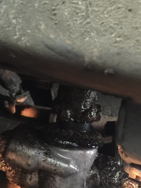

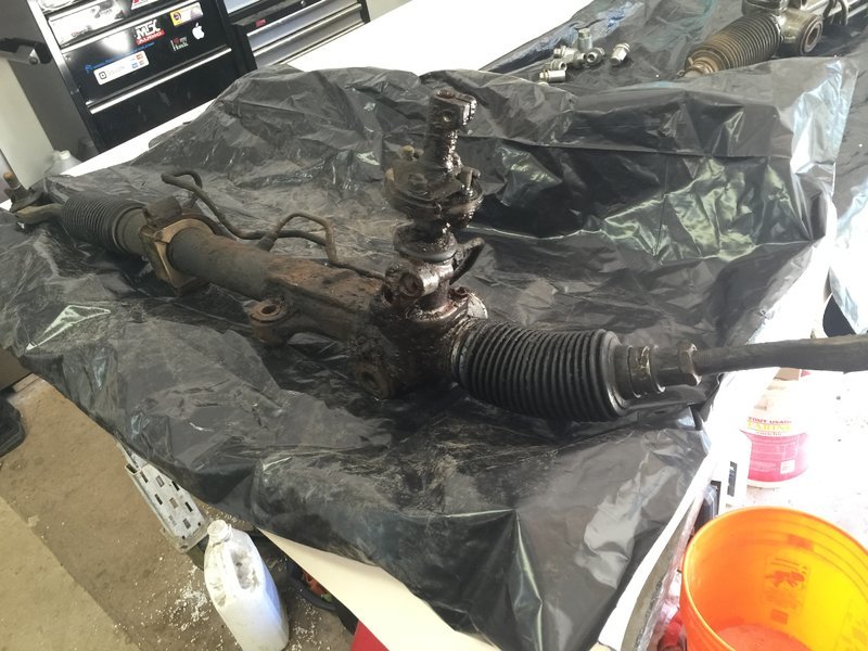

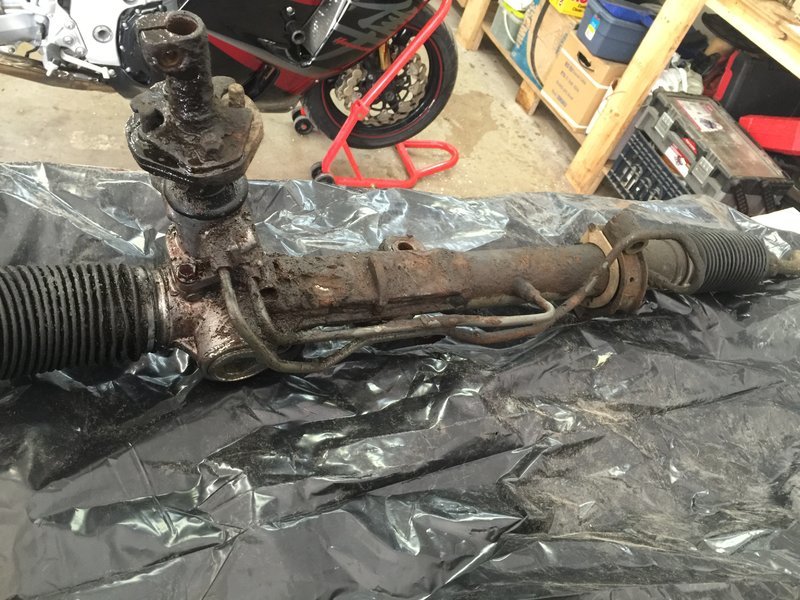

    This is the rack I pulled out.
    Try not to vomit.
    Who knows how long it's been leaking.

    So power steering rack was installed successfully yesterday.
    Although I researched this process to death before doing it, here are the things I learned:
    - When reinstalling the rack a second person is highly recommended because several things need to align and pressure needs to be applied in at least three directions at the same time. I had a meltdown and walked away. Eventually my brother in law stopped in and he gave me a hand, I only needed him for 5-10 minutes to get it in place enough so it was aligned and not falling down. Then I was able to get the lines on, steering spline in fully and fasten the nuts and bolts.
    - Alignment is pretty important after swapping the rack. I aligned mine by adjusting my OTRE by eye and then taking it out for a test drive. It took several goes but it's straight as can be. I will need to get it aligned but at least it's not pulling and the steering wheel is straight while driving straight.
    Glad I finally did it, now I am on to the next thing, drivers side UBJ. I just did the passengers so the procedure is fresh in mind.
