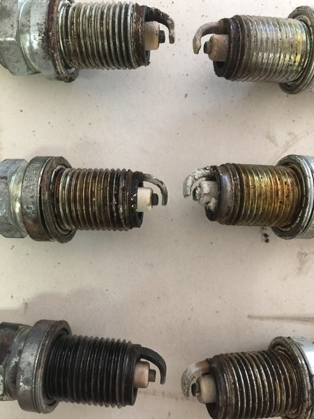

    Just checked the plugs today and did a compression test of one cylinder and stopped because it came up below Toyotas service limit...
    Here is a pic of the plugs

    IIRC, compression test can vary based off what equipment you use. Generally the rule of thumb is if all cylinders match, you should be ok. Run all the cylinders before tearing down the block
    That cylinder with the deposits and cracked insulation is probably due to overheating which is of concern; you going to need to check that cylinder for sure. If that bank has low compression, my guess would be head gasket failure (from overheating). After replacing that, you're going to have to find out why its overheating. White deposit is usually from running lean which will cause overheating; you probably need to clean/replace your injectors.
    The plugs are a perfect reason why "maintenance records" don't tell the whole story. While single grounded plugs are ok to run on this engine, its recommended to use double grounded plugs as this motor uses a wasted spark design. To use a single grounded plug, you have to halve the recommended life cycle to take into account these plugs will fire every two strokes. The maintenance tech definitely did not know/understand this. Makes you wonder where/how else they cut corners.

    I thought the scaily buildup on the right middle spark plug was caused by burning coolant.
    I was not aware the 3L required the dual electrode plugs in it just like the 3.4L

    Oh. Didn't know it was the 3.slow. No, I believe it has a distributor. Its also known for blowing head gaskets; GL.

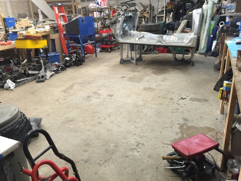

    Rearranging the shop.
    Pretty exciting. I love doing this and I especially love the results!
    I moved the 3 bikes so I could get at what's left of the parts truck.
    Conna chop it down.
