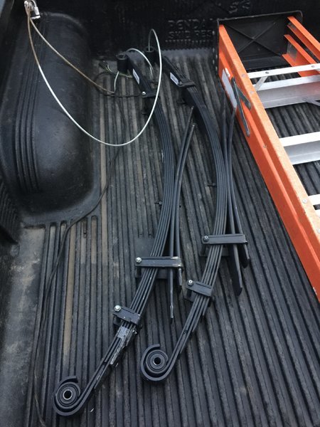

    No new coils upfront. I replace the front assemblies entirely with the middle-of-the-road brand for now.
    Does anyone know if you require longer U bolts for these leafpacks?

    You do. Wheelers sells a set .
    My only concern would be that the Dakars are going to give you about 2" of lift in the rear with an unloaded truck. If you're still stock height on the front that's going to be a little odd. Are you going to pull a leaf?

    I can't get that brand through my local supplier. Do you know what length u bolts are need?
    I had a 2" blocks in the back and when I removed them the front of the truck looked perfectly fine as is. I was hoping with the new leafs it would just look a little higher than the front as is now.

    If I'm reading the Wheeler's website correctly (and my whiskey sour tells me that I am :)) then they are 6.75 inches long.
    Well, if the blocks were 2", then it's going to look like you just put the blocks back in. Maybe a little higher.

    The U-bolts that Wheeler's sells to go with the Dakars have the same SKU (WHE U6754X) as the ones listed , which have a length of 6.75".

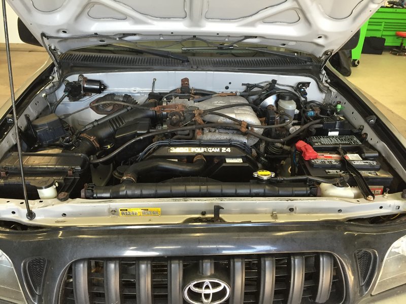

    I had my engine bay detailed today.

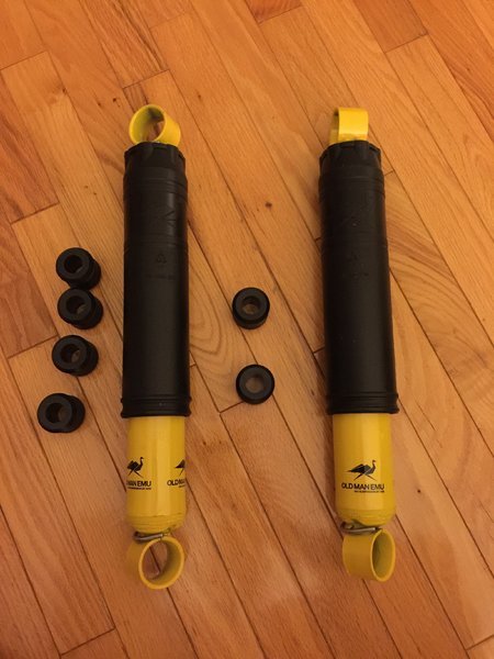

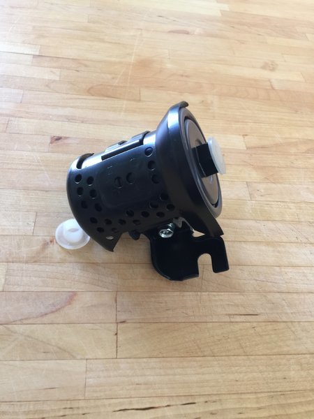

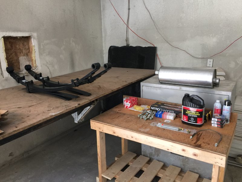

    I picked up some goodies today.
    For some reason one shock came with two sets of bushings.

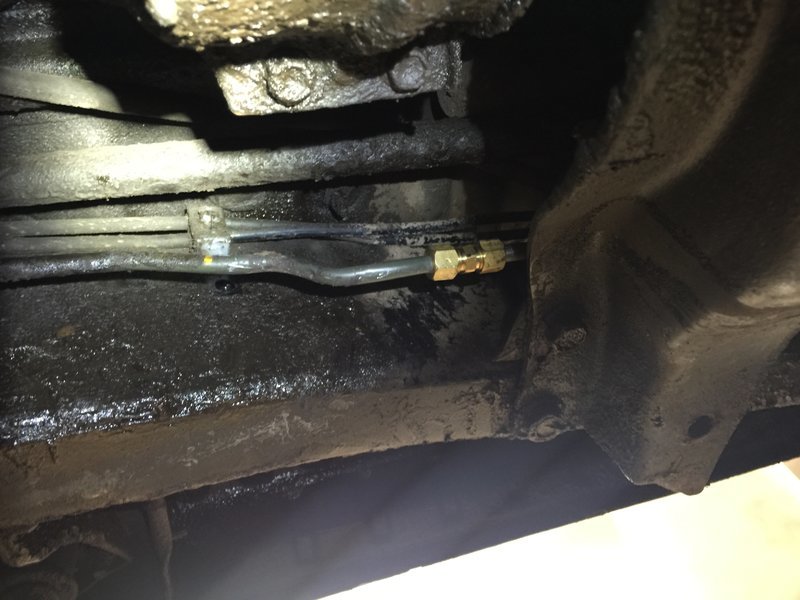

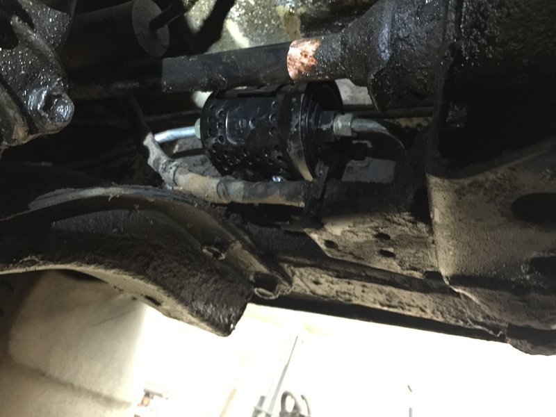

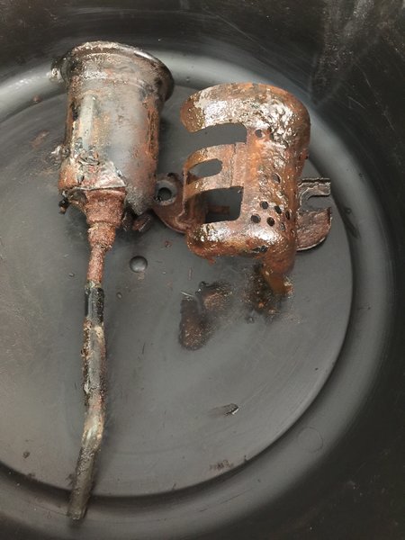

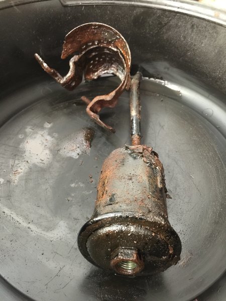

    Some 4Runner updates:
    A couple of pictures of the fuel filter and bracket I removed from the runner.
    Eeeek
    Will need to patch the line.

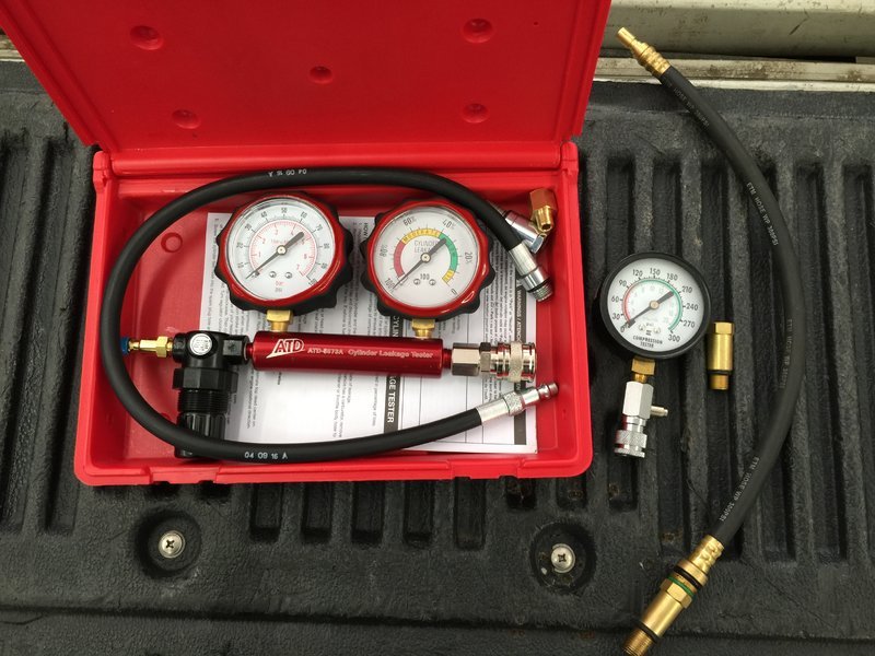

    Another picture of some of the parts I have to work with. Either for the Tacoma or 4 Runner.
    Also I picked up a leak down tester or cylinder leakage tester to go with my compression tester.
    I plan on doing both tests to each vehicle.

    Pic of testers

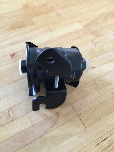

    Fuel filter just arrived.
    Less than $2 Can plus shipping lol.
    Bracket included. Blowout price.
    Came in a car quest box. That's a local parts store here, not sure if it exists in the US.

    Fuel filter replacement and fuel line repair complete. No leaks so far.
    All good

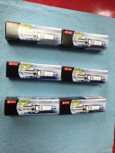

    New Plugs for the 4Runner

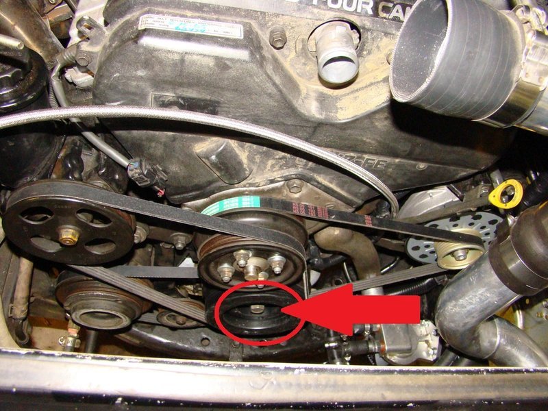

    How does one rotate the engine on the 3.0 and the 3.4 V6?
    I'm used to 4cyl honda engines that you can just put a socket on the crank bolt and spin.
    :help:

    Remove the fan for better access but you can access the bolt on the vibration dampener pulley.

    That is perfect, thank you!!

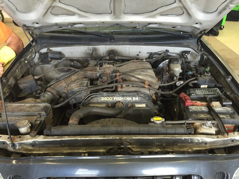

    A picture of the 4Runner getting inspected this past Friday.
    Why is this part of owning a vehicle so stressful? Maybe it's just me.
    All it needed was a front sway bar link.
    Not bad for a 21 year old truck.
